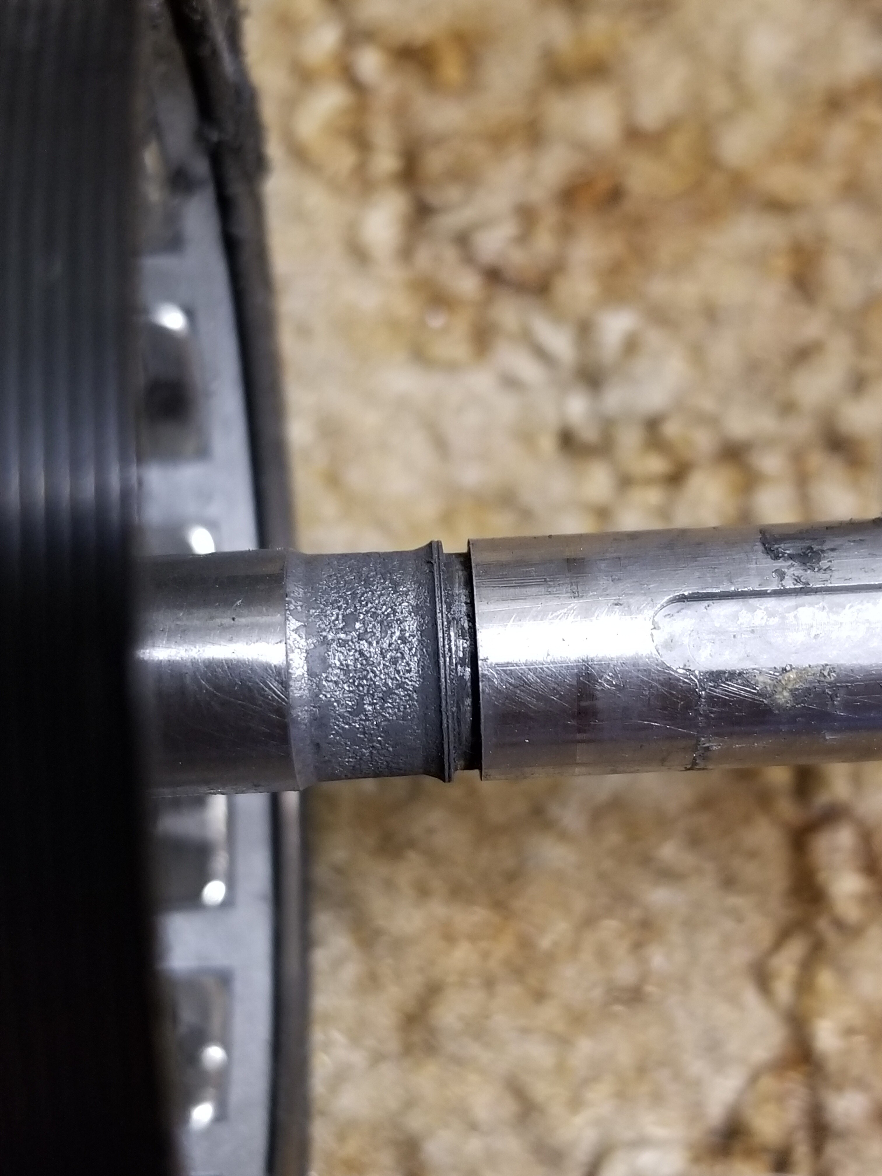

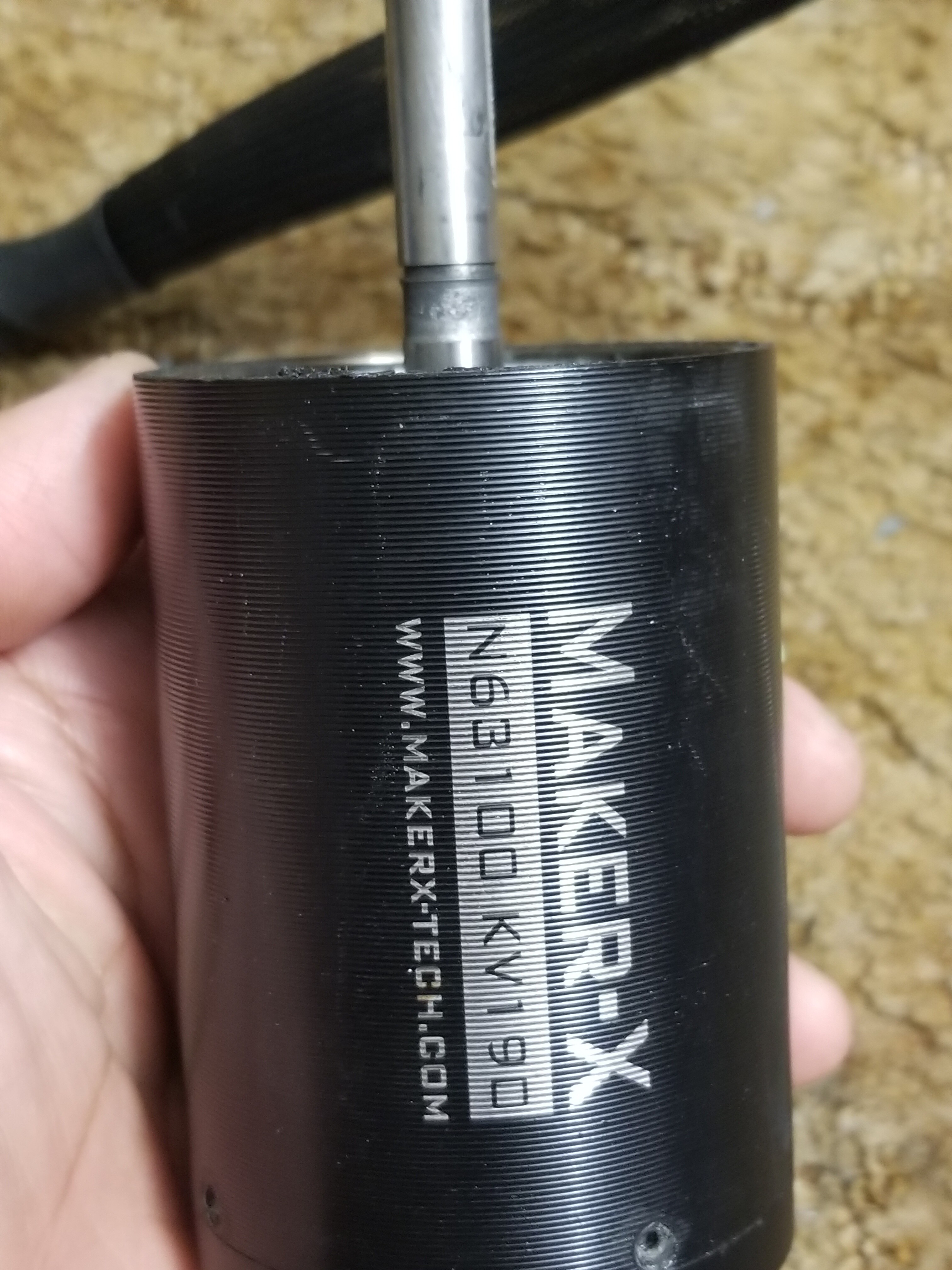

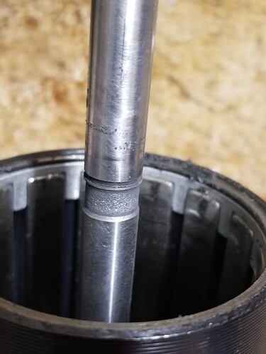

So a friend of mines just got some Maker X motor for his Lacroix. The 63100 motor. Longs story short we install it. Motor had a 30 day warranty from Maker X. Not even 2 days of riding, one of motor started making a strange noise when the throttle was let off. Diagnosis the problem and the motor can was moving. He contacted the vendor and sent them a video of the issue. They said they were going to send a replacement motor. Couple of days in and now then want to send a bearing instead. So he told me to open it up and see if it was the bearing. Bearing was fine. Real issue is the shaft where the bearing seat is worn down, causing play. Looks like cheap metal to me.

Looks like maybe a seized bearing could have caused that? Was the shaft case-hardened? They should be…
That looks really deep…
Wow… That’s… Uh
Not great.
Very weird, are you saying he wants to send a bearing instead of a motor? Orrr
First they said a replacement motor. Now they want to send a bearing. What good is the bearing when it’s the shaft.
Well yeah exactly haha they should send a new motor. Did you send them new pictures? I think he’ll take care of you

I wonder why the bearing seized up. Did you take the bearing off and try to spin it?
Bearing spins fine. I just spin.
That’s odd, I can’t think what else would make it eat away the shaft like that
Maybe the bearing was pinched when the can was assembled and sticking?
A new shaft and bearing should do it, but it might be a process to get the old ones out without doing more damage
Inner bearing collar must have spun to do that, personally the motor is trash unless you can get all the metal particles that have come off inside the motor, definitely weird if the bearing is fine
I have no idea what has happened.If the bearing can rotate, the shaft cannot be ground like this.The shafts are hardened
I need to find out the reason before I send you a new motor.:face_with_monocle::face_with_monocle:
Is there wear in the bearing bore?

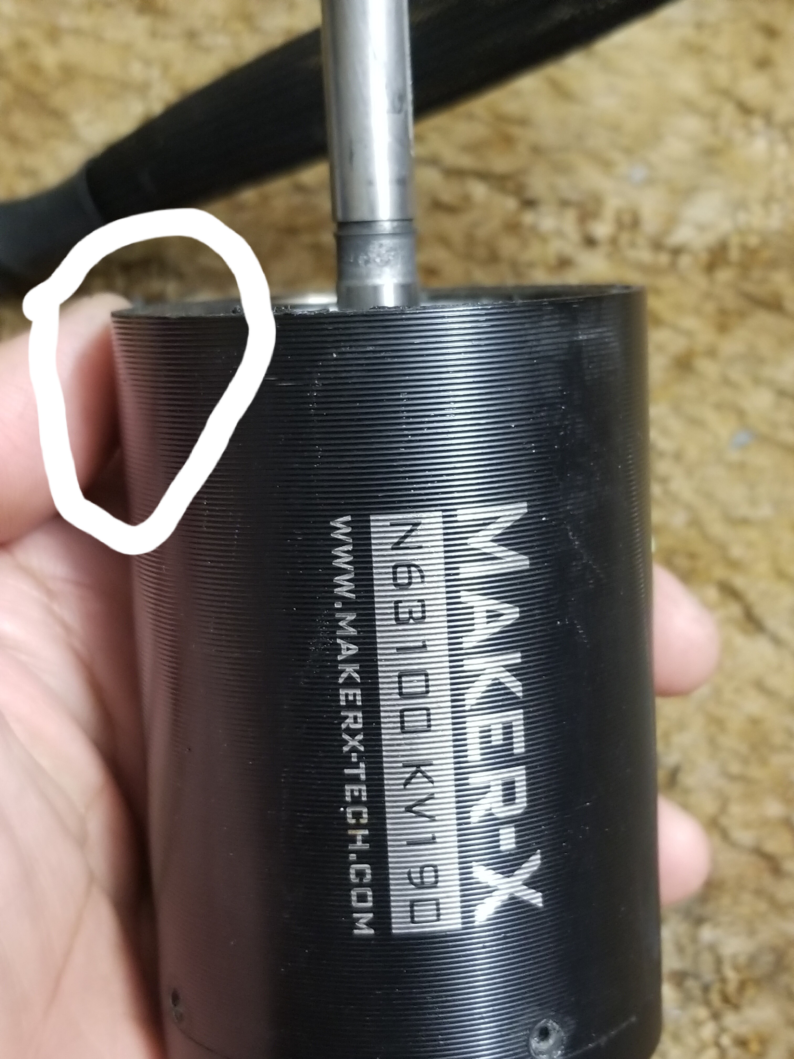

This is also pretty worrying. Not sure if its an optical illusion. But it doesnt look good.
