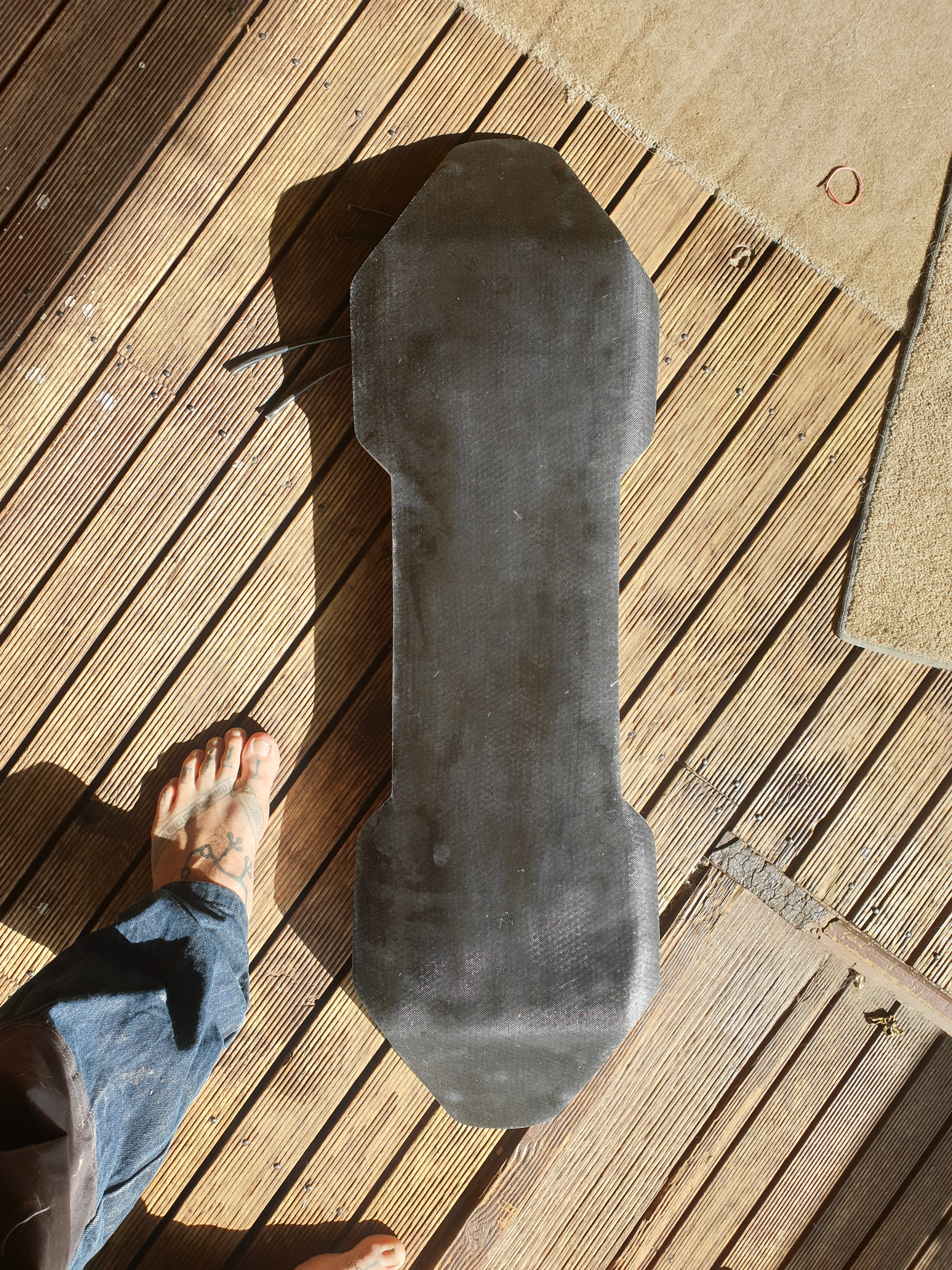

Finally got some time to work on it the last couple of days. Finalised the shape by rounding a few of the corners. When I started this build, I had never ridden a Kaly 2.0… since then I have done quite a few rides on the Kaly and learned that I’m not a huge fan of the sharp angle of the wings so I flattened them out a bit too.
Routed channels for cabling. The channels’s aren’t full depth, I’m gonna build up on top of the wires with resin and then shape it to a nice W concave it the standing areas. The wires aren’t embedded at all in the transition to the tip, I am hoping this works as a bit of a radial drop… we’ll see how good my sculpting skills are.
Everything is ready to start playing with some resin and fibreglass now :ok_hand:

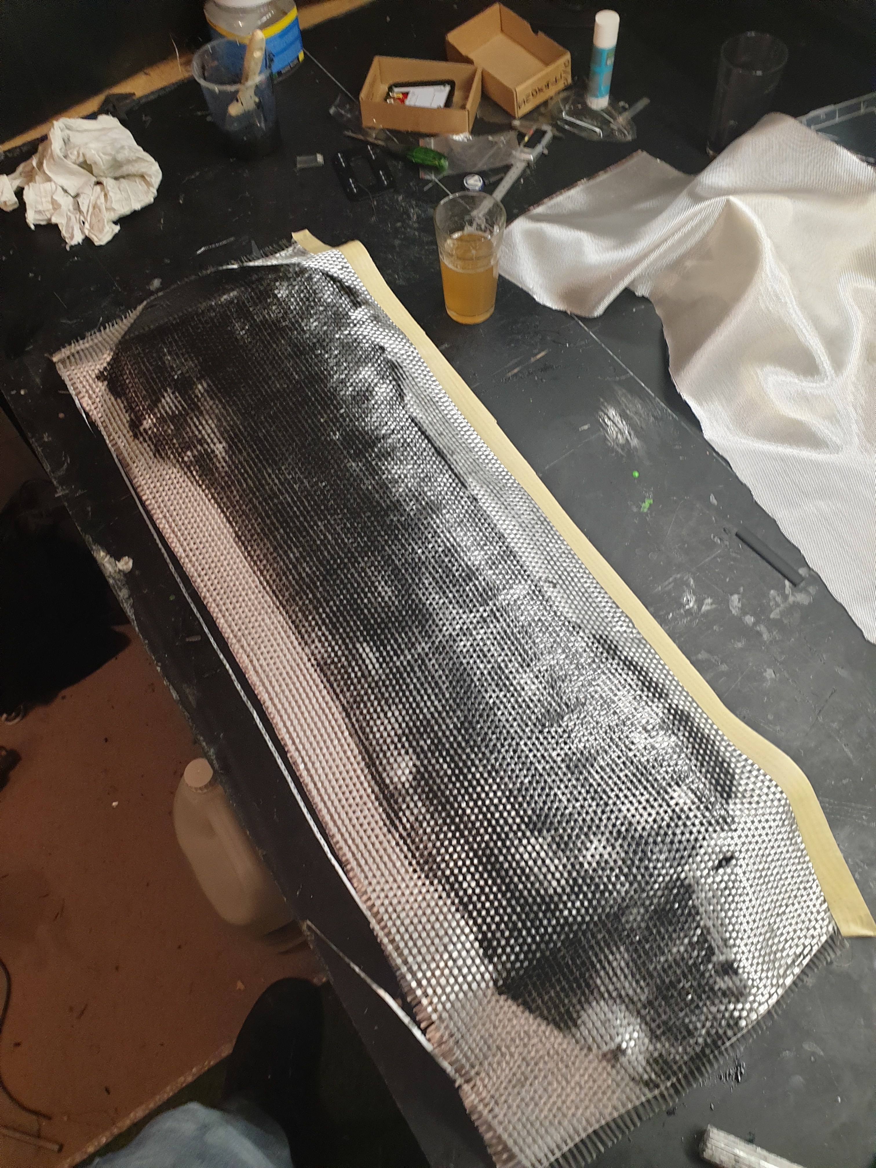

Got the bottom of the deck glassed with 200gsm cloth, 600gsm woven roving, 200gsm cloth

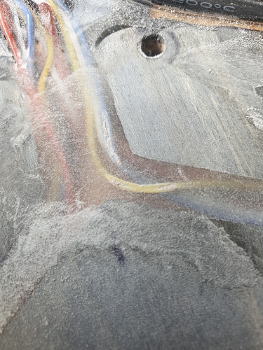

Just sanded through a sensor wire :man_facepalming:
Looks like both the yellow and blue got it
Blue got touched, yellow went all the way through :man_facepalming: gonna try lay a solder bridge or something… FML…
Open to suggestions on the best way to fix this :sweat_smile: im thinking of a bare wire, soldered at each end of the break and sculpt epoxy over it.
