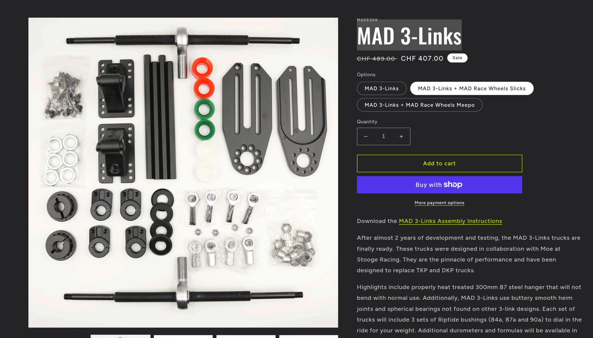

I am running an intro sale. $299 for a set. I also doing a combo with MAD tubeless wheels for $499. The sale will be going for the reminder of the week!

  1. Hangers are 300mm wide. These trucks were designed to replace DKPs and TKPs on consumer boards.
  2. Hangers are properly treated and will not bend from normal use.
  3. Center heim joint and spherical bearings are buttery smooth and do not bind or have high levels of resistance like the Meepo ones. When the spherical bearings aren’t smooth, the trucks don’t function properly.
  4. Tolerances on machined parts like screw holes are better and make assembly and maintenance easier.
  5. Quality customer service - if there is an issue, you can actually reach me and I will help you out.
  6. 3 sets of Riptide bushings. Each set comes with 84a, 87a and 90a Krank bushings. I also have APS bushings that my team and I are riding. I will be putting these on the website shortly.
  7. Step by step assembly guide. I made an assembly guide that can be accessed from the madesk8 website.

The MAD Links have a similar feel to other 3-links. During testing me team and I found that smooth spherical bearings are critical to get full and smooth articulation out of the trucks.

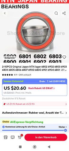

In the picture above, I have the wheel kit included, with the Mad Slikes tires. The 60t wheel is mounted on the rim. Are there really no bearings included for the wheels? Why don’t you sell them in your shop?
Bearing 6900LLU ? 8 PCs ?
