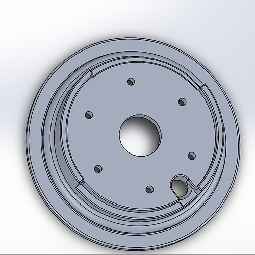

Yes, but that would require two different halves to mill, resulting in more costs. I do think that if you know the pattern its easy to drill afterwards.
I would disagree. Something like this needs precision which is easy to do via CNC but hard to do via hand drill or drill press.
I’m also looking for something that can house kegal pulley inserts
You could just have both sides have kegal :stuck_out_tongue:
now what i can do ishave the pattern drilled in the inner side of the rims, so that way its easy to drill through to the front?
For ISO 2768 medium youll probably want to undersize the bearing seat and have the bearings press fit
i will do that, thank you for that input <3 i looked it up, its about 0.1mm tolerance.
also decided to make the outer rim smooth.

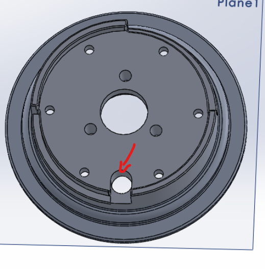

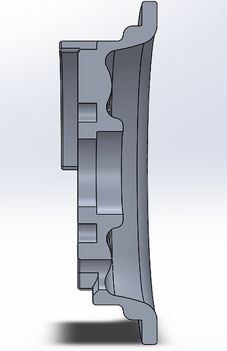

what do you think of this moon?
you probably want a 1mm fillet here to prevent the inner tube getting stabbed by the hub
yes i did that already :+1:

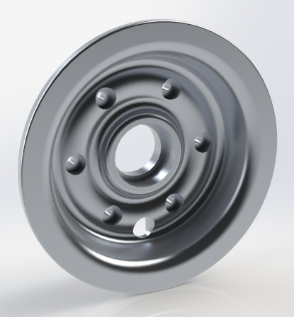

What i will do for the people that wanna mount them on lets say kegel adaptors:
Pre drilled holes, exept not all the way through. this way you dont see the holes when not using them. and when you use them people can drill through them and the pattern will be on point.
Maybe leave just 1-2mm? That’s less material to drill through and it wouldn’t impact what it looks like from the outside
It may be like that already, just hard to tell from rendering angles
yes it is like that now
Awesome, that’d be dope! And helps solve my melting rim issue :stuck_out_tongue:

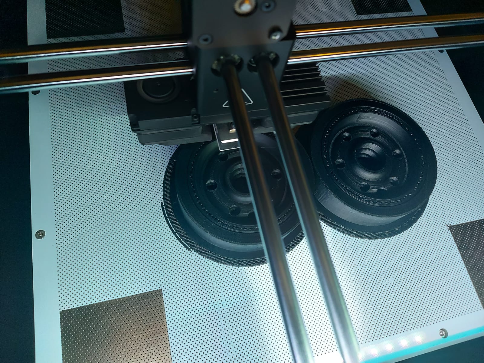

The model is being printed by my friend to see how the design worked out. Im kinda exited tbh.
