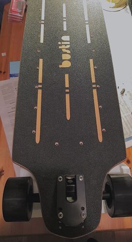

Building and waterproofing
First thing i did was modify the deck for a dropthrough, i emailed bustin asking if the hollowcore pattern would be a problem to cut through and while they didnt recommand it they said it should be fine, and it turned out good but it was a bitch to cut through i almost broke 2 saw blades
Original look
After dropthrough cut
It took some effort to measure everything up but im happy i did it as the board has a much lower profile
End result>
I also drilled the holes for bolts right over the griptape because i couldnt be bothered to replace it and just made them black with a marker after

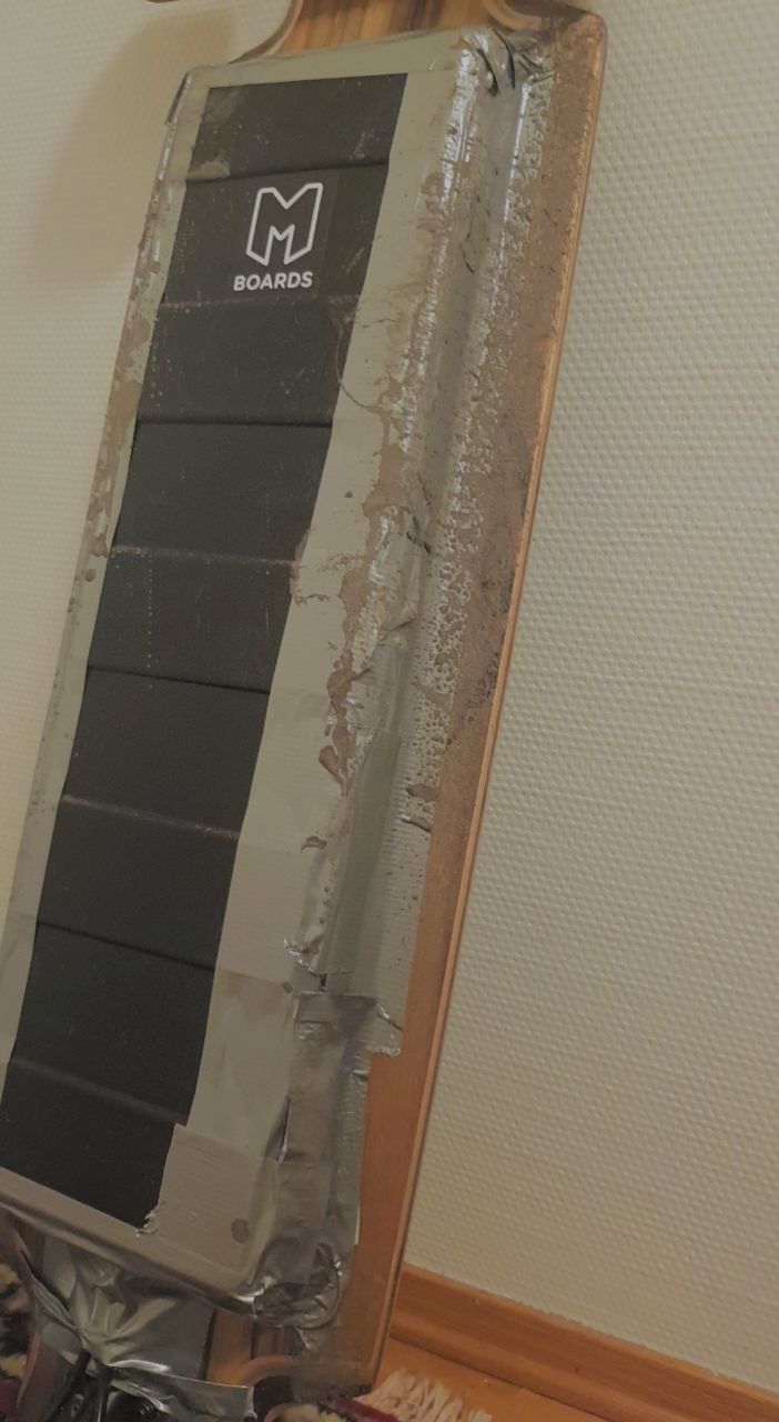

I wanted to make it water resistant aswell so i first laid everything inside and added some cushion foam
Then put everything inside PVC heat shrink
And in the end added a some tape to cover the holes and make sure nothing moves
Then i placed down the foam for the enclosure and just bolted everything together
holding the nuts while screwing the bolts was a bitch again, and i did manage to get 3 slight cracks while screwing it, the components were sticking a bit out so i had to bend the enclosure, but fixed them with gorilla glue
Final look
Im really happy with how it turned out and how low it is, the deck fits the aesthetic really good

Bro if it cracked the enclosure it’s not waterproof, shrink wrap isn’t gonna make it that safe either unless you have silicone sealing it from the inside. She’s pretty though, I’ll give you that’s!
Way to see this through dude! We are all so proud of you.
its not FULLY waterproof but everything is still sealed pretty damn good, ive made sure to glue good the small cracks and its sitting very tight on the foam,and if any drops somehow still get in everything is sealed in the pvc AND taped around, and the rest is filled with foam, if the board ever dies its not gonna be from water :d

I’d be a little concerned about the components if you had to compress the enclosure into them to make them fit.
Good luck with it, by the sounds of it, that enclosure is gonna last like 3 rides if you’re lucky.
actually still holds up fine after 3rd ride XD
