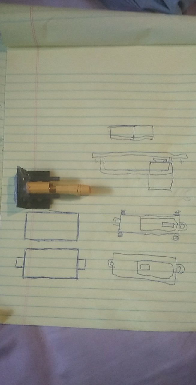

I have a best of both worlds solution to offer… will attempt to prototype today. Be back later with pics.

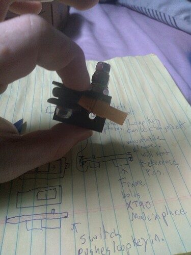

Ok I made a very rough prototype with some shit I had on hand, I dont have my own printer and im not very good at 3d modeling but I sent some sketches to my guy and hopefully he’ll have something done up by tomorrow.
A physical slider switch that connects/disconnects an xt90s loop key from the circuit. Obviously it will require internal housing for both the loop key, with perhaps one screw to swap loop keys if need be, and the xt90 it plugs into. But it has all of the benefits of both a physical on off switch and a loop key. Correct?
Cleaned up a bit…
Should have a 3d model printed by Monday. If it looks good and yall are interested ive got Hella spare xt90s anyways, I can make up a batch of like 50 without much effort xD

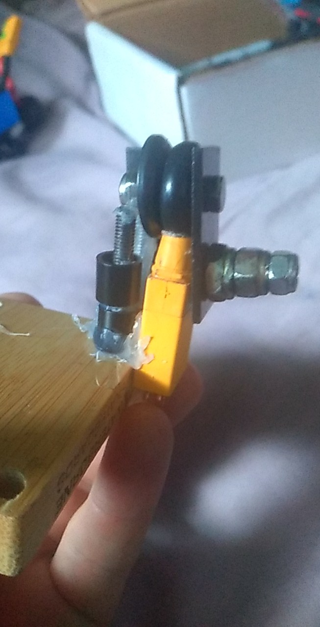

Yep I’m building a fallout level scrap tech one right now just to see how compact i can actually make it xD

Forgive the apocalypse quality, actual outer switch profile could be very very small, like only slightly larger than a direct loop key slot. Now to shrink the internal design and yell at my friend about it!!
Yes, but you still have to mount it somewhere. The janpom design has extra material to do double duty as a riser pad, which actually makes it lower profile than if you were to mount it anywhere else beside inside the enclosure. The ā€œswitch mechanismā€ is the loop key profile, essentially, plus a handle.
Where do you plan to mount your angle bracket? If through an enclosure, I’m curious how you’d seal around the moving parts.
This is purely a 3 dimensional sketch for my 3d modeling guy. I do not intend to use a single part of this xD im just technologically challenged
This has become my project for the day lmao. I think im done, just need to wait for my dude to do his computer magic.
