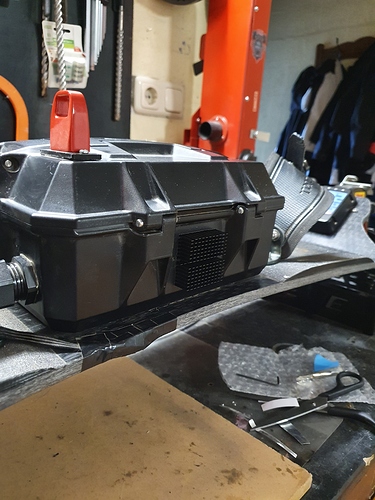

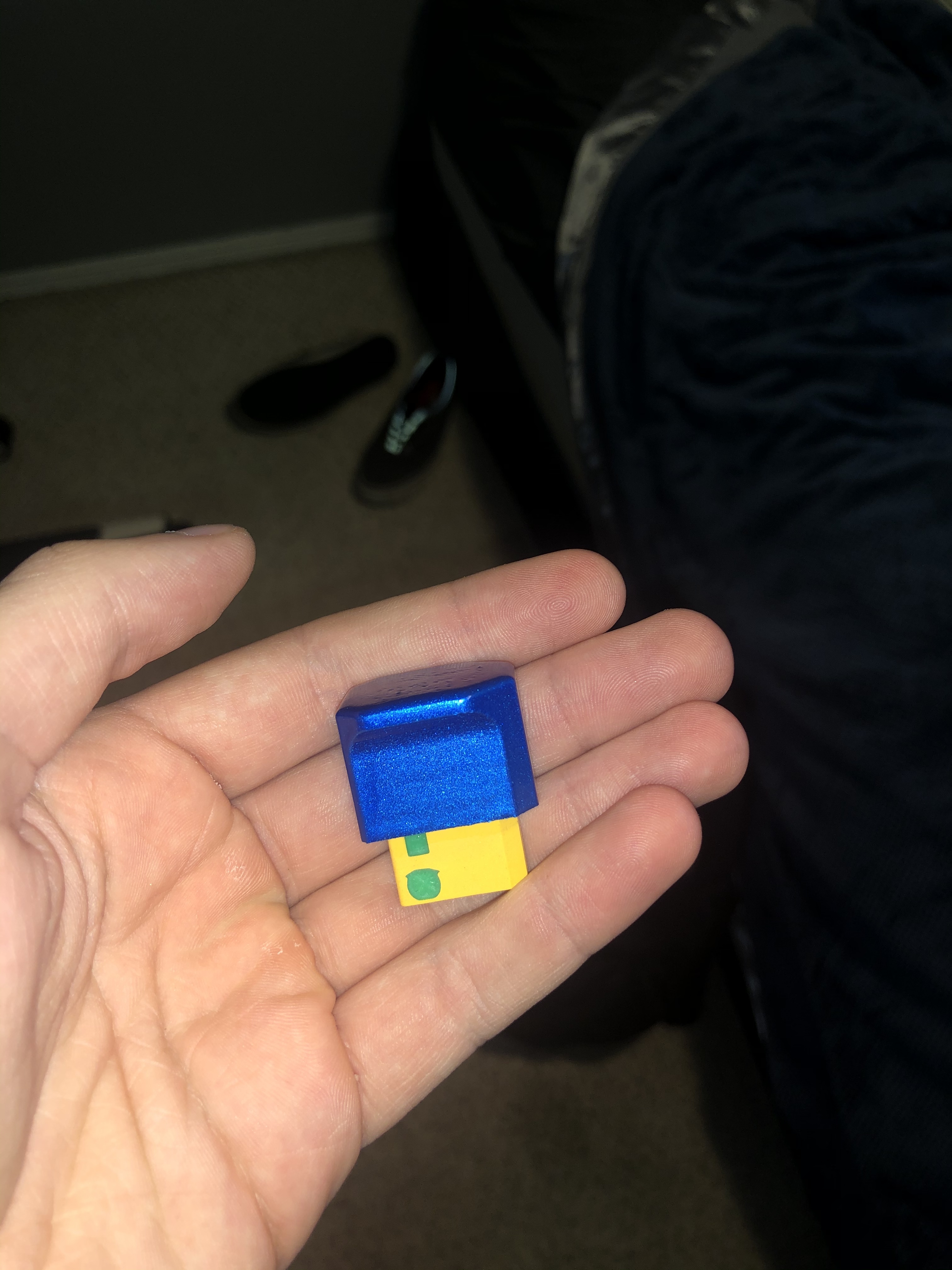

Loopkeys are the cheapest, that’s why many use them. If you search around you can find cool 3d-printed designs for them that start to make them look not half bad.
Like @rusins said… I don’t think that this looks half bad

Loopkey isnt so bad :wink:
that loop key would be a joy to grab in an emergency ! :slight_smile:
