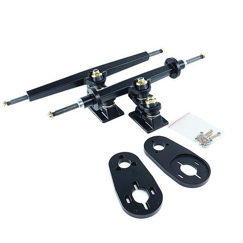

Not DKP, but probably much better Mad Esk8 3-Link Truck Set – SkyartPowerSystems
I second that these are likely better; however, the flipsky trucks have worked well for me! I did change them to TKP tho with the B-One Board DKP to TKP baseplate
how are they better? ive never used 3-links before, but I know a bunch of racers that swear by them
It depends on your goals, DKPs are super good for low speed everyday riding, but they are unstable at speeds over 20-25 unless you install hard bushings, which defeats the purpose of the DKP truck at that point.
3 link for the most part are able to offer both incredible menuverability and reasonable high speed stability
