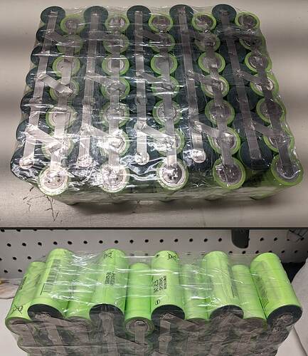

I hope you stopped building batteries like this
IMG_20230911_010123_477
IMG_20230911_010328_947
Yes I do packs at a good price and I have a thread showing off my work
@goblin39
Like what specifically? If whoever I sold that battery has a problem with it they’re free to return it. Do they?
@DerelictRobot its more than safety where lifepo4 are better and while there’s some high power ion cells out there I don’t think any compare to A123 for putting out amps, but the biggest benefit which is very noticeable is the discharge curve of ion sucks compared to lifepo4. When ur actually riding and not analyzing from the keyboard about weight or mass lifepo4 performs better.
I believe he’s referring to the solder points incredibly close to the cells. I would also like to point out that there are minimal series connections so this battery would only be good to like ~30A
I build batteries based on how many amps a customer tells me they will use and add nickel accordingly. @xsynatic who’s battery is it and how many amps did they say it would use? I also stack nickel obsessively well and hard to tell there are layers. This pic looks like I used a narrower strip on top of a thicker:
You can see how hidden the stack can be here:
I see nothing wrong with a soldered on balance wire there. I don’t see any others balance wires and don’t know what battery this is so can’t say.
Can just see some stacked layers.
If ur going to insult my building you need to bring all the info @xsynatic. Hope u don’t just post imoji and run.
