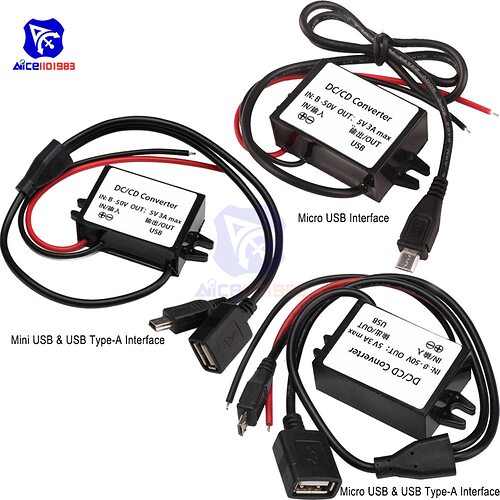

How’s this specific model work? Would it work for a 12s battery?
Yes, that will work fine for a 8S - 12S battery.
You could probably use it for 13S or 14S but I wouldn’t use it for 14S.
15S is no bueno.
Does anyone have experience with the waterproof versions?
The magic “DC/CD” converter. I’m hoping it’s just a fixed output TI LM2596 bathed in epoxy.
