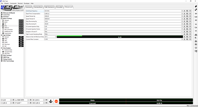

Unfortunately this issue keeps happening without any solutions on the short term. Not sure what to do more.
Have you tried mixing control modes? One motor run duty cycle and the others current control, may need a bit of programming to integrate all
Set the duty cycle on motor 1, set the current on all other models using a PID controller so that the current of all other motors is close to the duty cycle controles motor, this way the load is shared between them
Thinking a bit on this, the problem probably is the slight different Kv between motors, so the duty cycle doesn’t correspond to the same rpm on all motors, if this is true the approach os setting the same duty is fundamentally flawed and won’t work and isn’t VESC fault, a solution as I suggested above may work
edit: Another idea would be to mess with the PID controller of all but one VESC, set them to be forgiving and let the duty run outside the exact set duty, one would be strict and lock the duty, and the other would be allowed to stay near the set point, but not on it, I’m a bit rusty on the control background but can look it up if you want to test

If I use PID speed controller, I have no issues with locking at full speed, but the machine behavior is not smooth as for duty cycle.
The different drive modes probably not, but tunning the PID of the other motors yes
Probably making a mess due to wording, when I’m saying PID, I’m not referring to PID speed control, each mode has a PID controller to get to the target value, you will set the mode as duty cycle on the main VESC and leave everything as default on it
On the slave ones you would mess with the internal PID controller, I don’t even know if just changing the values on the VESC tool would work or you need to dive into the code

I would like to not go into custom firmware, so if this could be achieved with standard ones would be great.
I like the idea of having one master being duty cycle controlled and the others just aiding in current control but I need to achieve this using canbus.
Still, the best mode for this is current control, but with light loads, I have zero control on the acceleration and the motors just speed up. I have also variable load, so even if I keep the throttle % fixed, when removing the load, it will just go crazy on speed.
