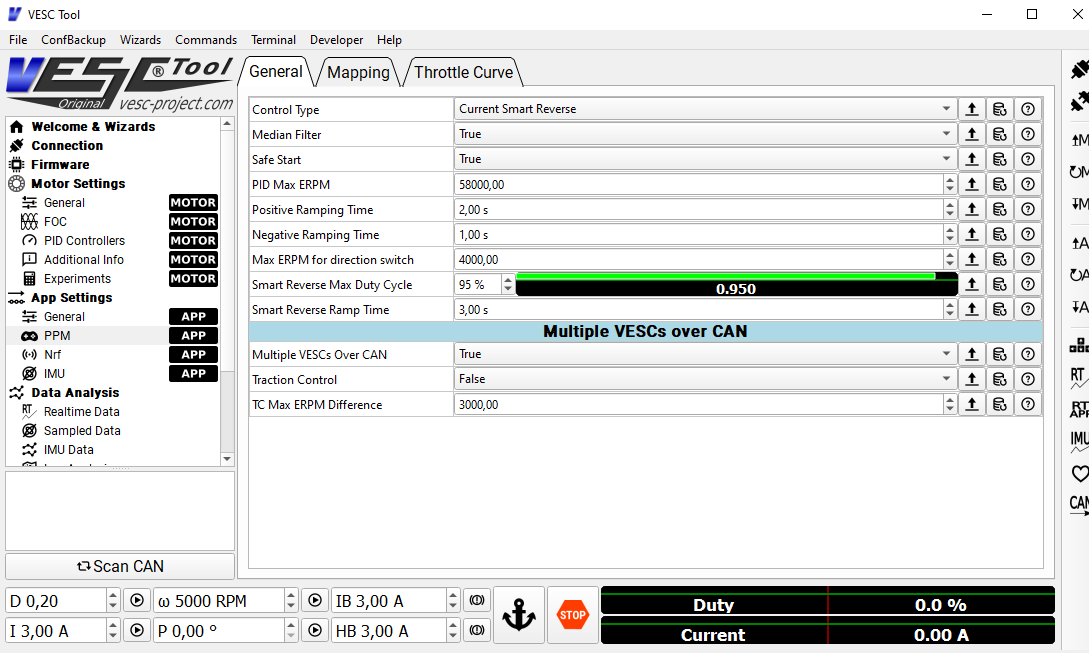

I was looking at this and just out of curiosity I played a bit around with the “current smart reverse” as it can activate duty cycle.
I placed there duty cycle max 95% and it did´t locked at full speed! (altough current on master motor showed up negative.
Below the settings:
I didn’t made extensive tests on this get a conclusion, but for the 4 or 5 times I tested to reach full speed, it always release the motor. Could it be a coincidence? I will repeat the tests today to make sure, but maybe something to look at.
That is actually a duty cycle controller, so that you get full torque while going up a steep hill slowly.
Yes, I know it is duty cycle so that is why I gave it a go to test another duty cycle app and it looks like there is no lock at full speed. Question is “why”?
