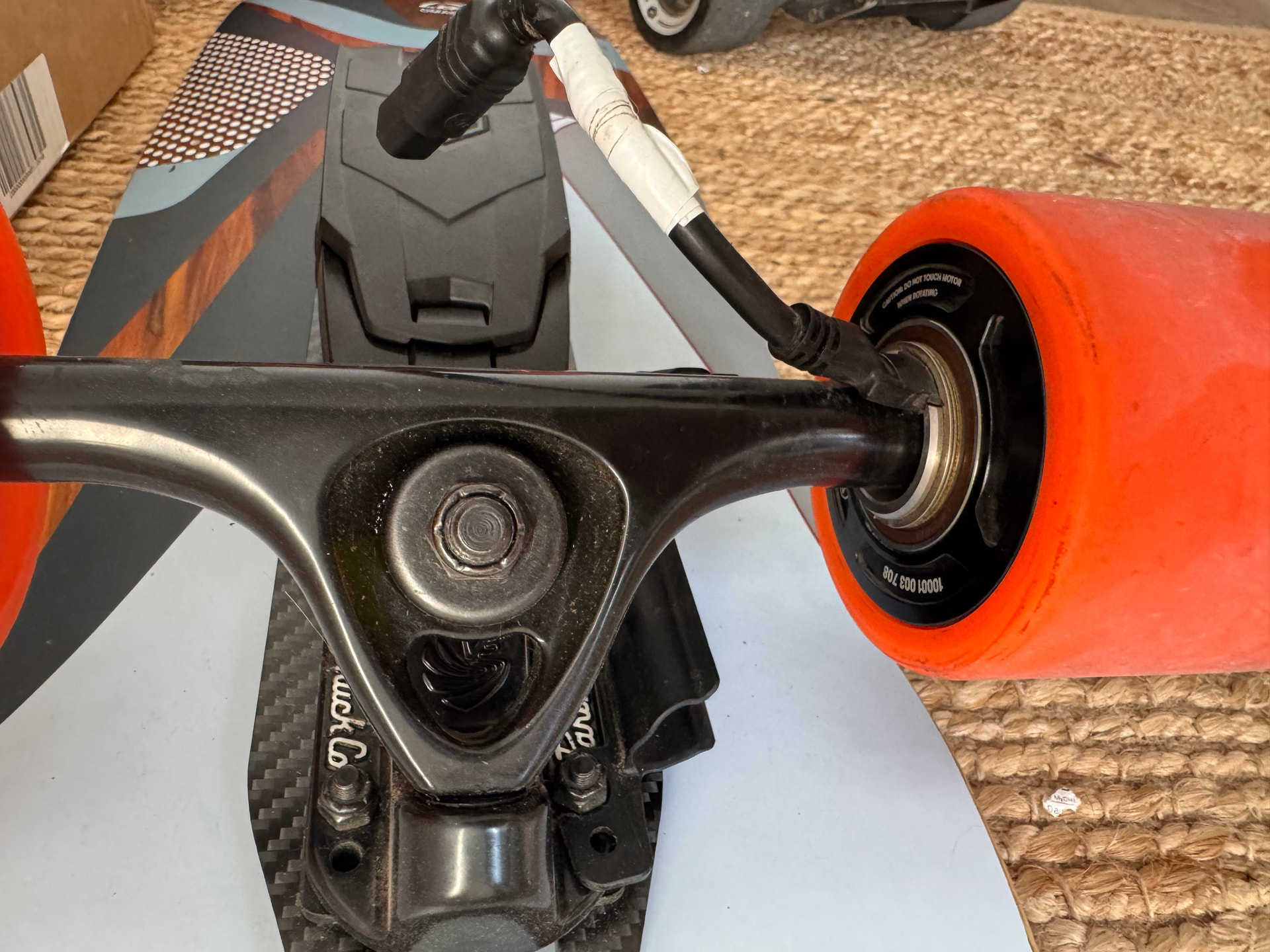

Hello,
I have bought a used Loaded Unlimited setup on a Loaded Omakase with the original hub motor.
I’m experiencing a strange issue with one of the motors. The motor cable exits the side of the hub through a rubber strain relief/grommet. During rides, the cable gradually twists around the axle because the part where the cable exits the motor appears to rotate.
As far as I understand, the cable should remain stationary relative to the axle, but somehow the cable outlet or internal retaining ring seems to be turning, causing the motor cable to wind up over time. This happens slowly and gradually over time. I was actually able to ride for a long time today.
Has anyone had an similar issue?
My guess is that you need to tighten the truck axle nut more so it doesn’t rotate. Do you have the cone washers that come with the kit?
Yeah, this. I’ve seen a few users have them torqued too loose and they slip while braking and rip the wires out
That was the problem, thanks for the great help!!
