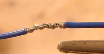

@Zachsnotboard You can also just buy or find more wire and desolder the existing MT60 connector, trim about 1cm or so off the wires to where they no longer have solder on them, and then splice in new wire. You’d then solder the extensions back to the MT60. Works just as well and will save you a few bucks plus you still have flexible wire throughout.
Here is a nice little guide for a good inline splice:
With thicker wire you won’t get as many twists but it still works well. If you think your splice won’t hold up just try pulling it apart yourself after you soldered it for an easy strength test. Just know that if you want a bend directly on the splice you’ll want to do it while the wire is hot. Unless it is a smaller wire then that might not be an issue.

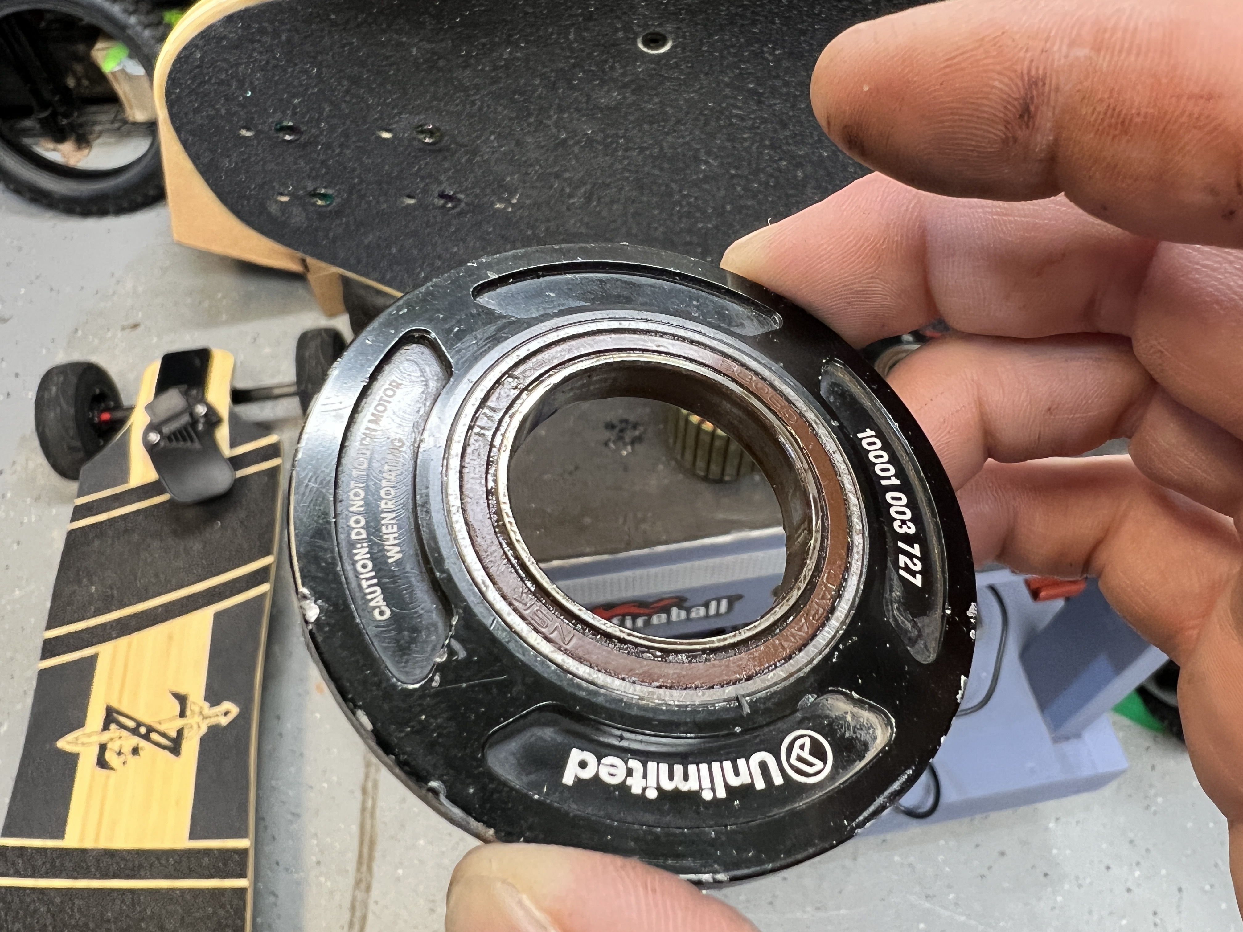

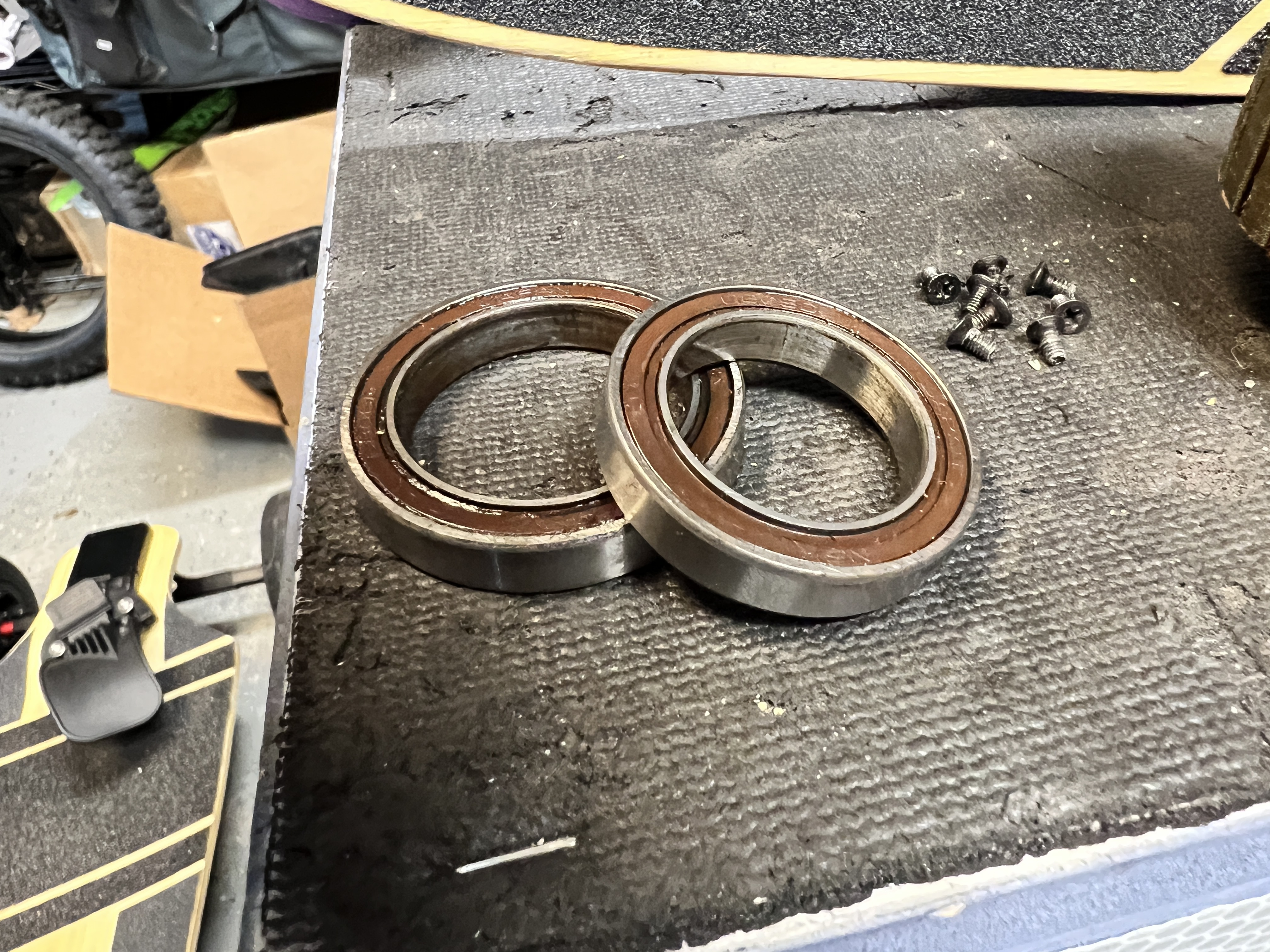

I took apart one of my hubs to get a better look at the bearings. I couldn’t find any real info out there on the disassembly but it was pretty easy.

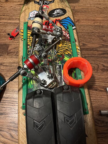

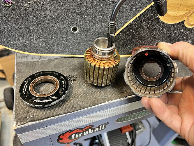

Remove the urethane wheel liner, use flathead screwdriver to remove “circlips”’on each side of center. Use small Philips head to carefully remove the small screws on the outside of the can. Pry open the side and it will open up and you’ll have pretty easy access to the bearings.

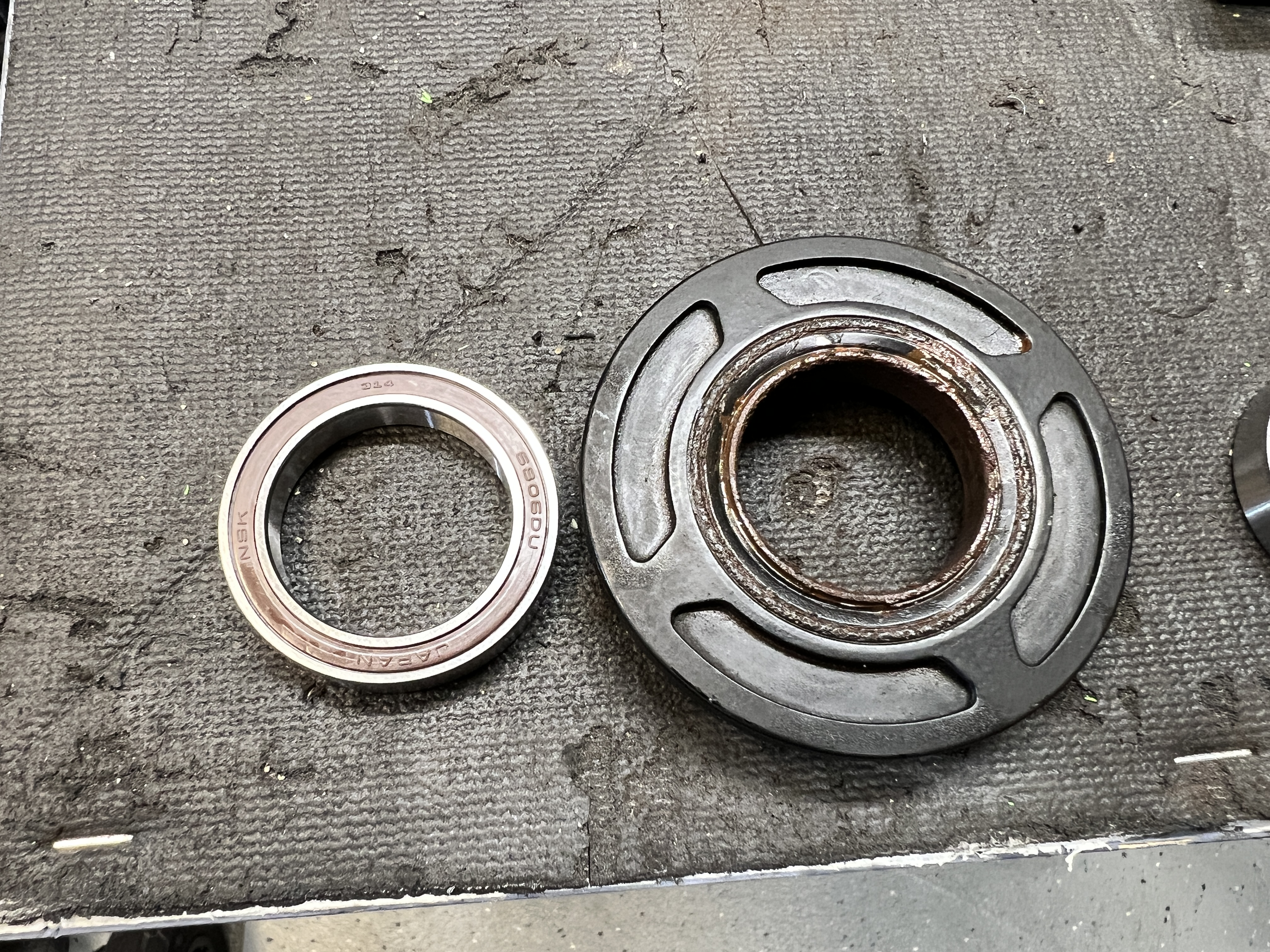

Outside bearing is an NSK 6805DDU and inside bearing is an NSK 6806DDU. I have some on order and will be swapping them in and reassembling.

I’m now eyeing them up to see where an encoder could go…

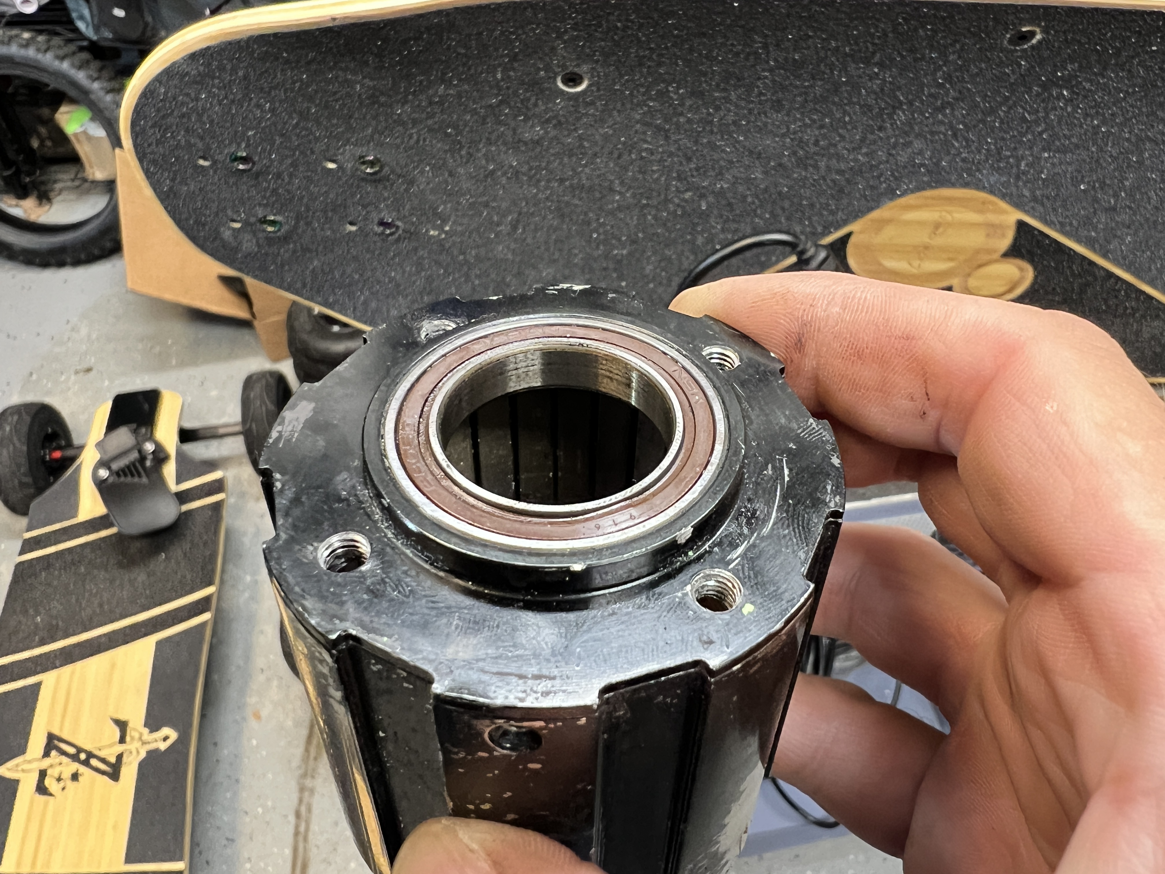

Just a follow up. I got my new NSK bearings in pretty quickly and finished getting them installed today. Overall process is pretty easy. Regarding the small Philips head screws on the outside of the can, you only need to remove the (4) screws that are closest to the back/inner part of the motor (side where the cable comes out). You can leave the front ones in.
Before swapping:
After. Smooth as the inside of a dolphin’s blowhole.
Freeroll for days again.
