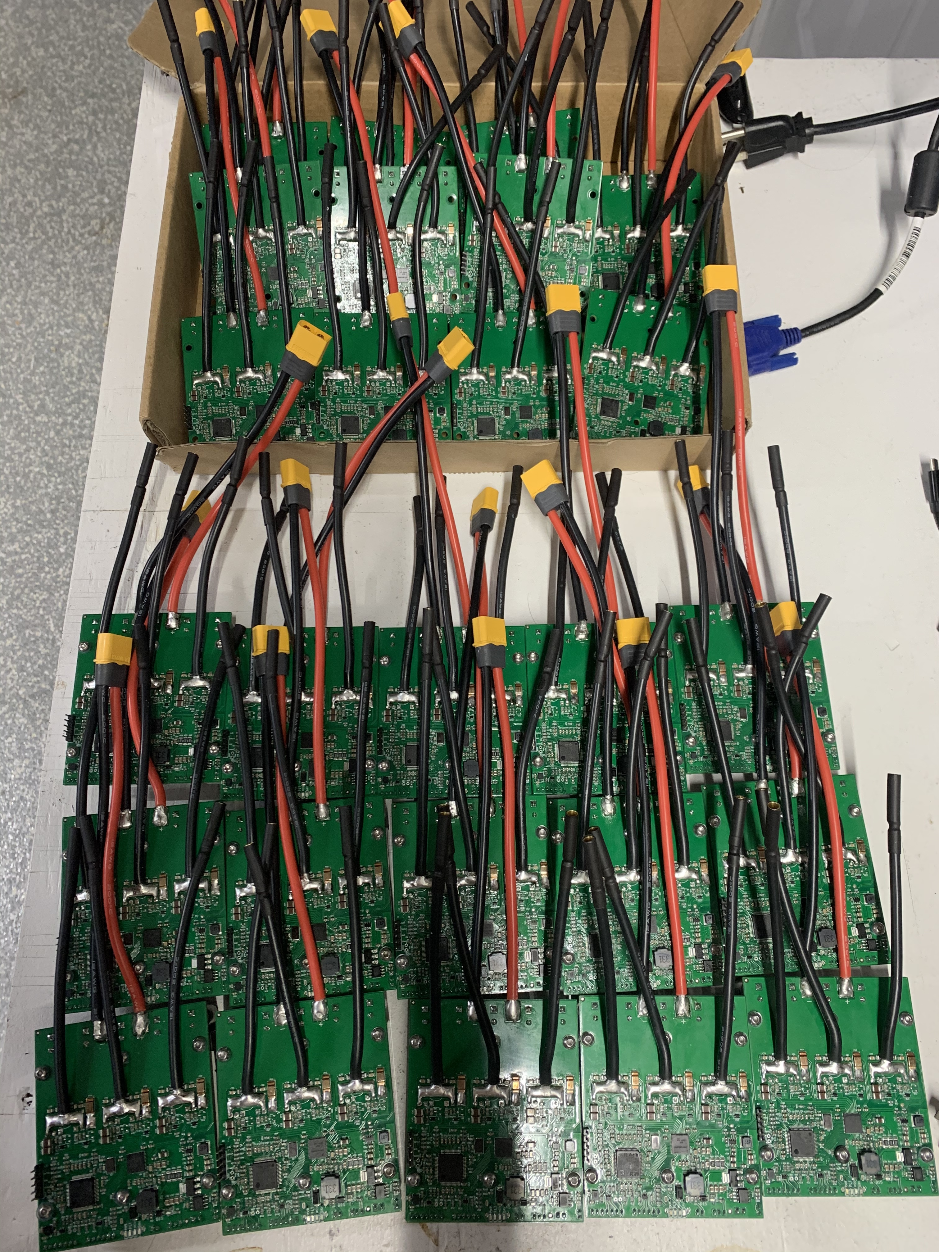

Little FOCer! 84V 5kW VESC-Based Controller
Don’t hope for any performance or efficiency increase going higher in voltage. For Esk8 there is not much gain going higher in voltage…
What Mario said :smiley:
The fact though that your BMS will fit in the space of the original Onewheel BMS is huge (assuming it will fit in the thickness dimension; the Onewheel BMS is 157x37mm). This will allow Onewheelers to replace the whole ESC + BMS combo bascially in-place, without having to come up with some different placement.
That said, I’m looking at ENNOID-BMS-SS-LITE after Mario mentioned it. Supporting up to 24S eventually :grin: And I don’t think it’s unreasonable for a narrow version to happen. If there’s enough onewheelers out there… (the thread: ENNOID XLITE & VESC)
