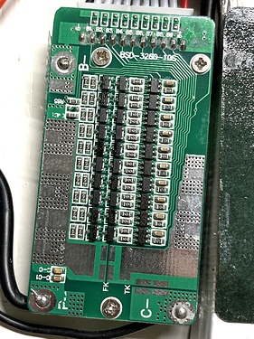

I have a 10s1p battery pack and 2 of the cells have gone bad (puffy) — 3.7v 6.4ah 230wh.
I’m getting conflicting answers on if I can just remove the last two cells, leave the last 2 battery leads disconnected, and still be able to run my ESC.

You could technically run fine on 8s but you’d have to replace your BMS, it wouldn’t like having two disconnected cells
If buying a new 8s BMS - what’s the max A I should look for to support these cells? I see 20a, 25a, 32a, etc.

This 10s1p is straight from my board so it would be factory setup. Would there be anything I can look at on my board BMS/ESC or cables that gives away this answer on discharge?
Oh hmm what are the connected wires on the bms, are they labeled?
The thicker 16AWG black cable connects to P-
The thinner black cable connects to C-
I think that’s an XT60 plug for power (?) and the small red one I’m not sure (power switch?).
Small red is for the charging port.
Hmm well there’s three wires coming out it looks like, so probably it is wired for discharge… Maybe you could look up the part number and see if you could find the bms to see what kind of discharge rating it has
I found the manufacturer website but had no luck finding the part. It’s in Chinese and from Google translate the website seems to be for wholesalers.

Might be this one, but no product description.
I don’t think just disconnecting two battery balance leads is a good idea, I think it would mess it up
It’s possible that the BMS would be confused and try to pull down the other cells, honestly not super sure.

He could unpopulate the 2 now unused circuits to make the bms believe it’s an 8s bms? Or is there a software side to making that happen? I see so many Chinese bms have unpopulated series and always wondered if I could populate them to have a bigger bms rather than buying the exact same one with more populated circuits
Image to visualise what I mean by bigger bms with unpopulated circuits
@Gamer43 kai you’d be my go to person for a random question like that
Some BMS you can leave the two most positive series packs disconnected
Some BMS you can leave the two most positive series packs disconnected but you need to short them out
But if you try it, make sure it’s the two furthest from B-
It would depend on the exact BMS. I don’t think these BMS come with a user manual though…

@BillGordon The PCB backing on my 10s BMS from the same company looks a little bit different. Could be a previous generation?
Does the “60” in the product name imply 60A?
3.7v x 6,000mah x10 cells in series = 60A?
Should I be looking for a 30V 48A 8s BMS that matches the cells (3.7v x 6,000mah x8 cells)?
