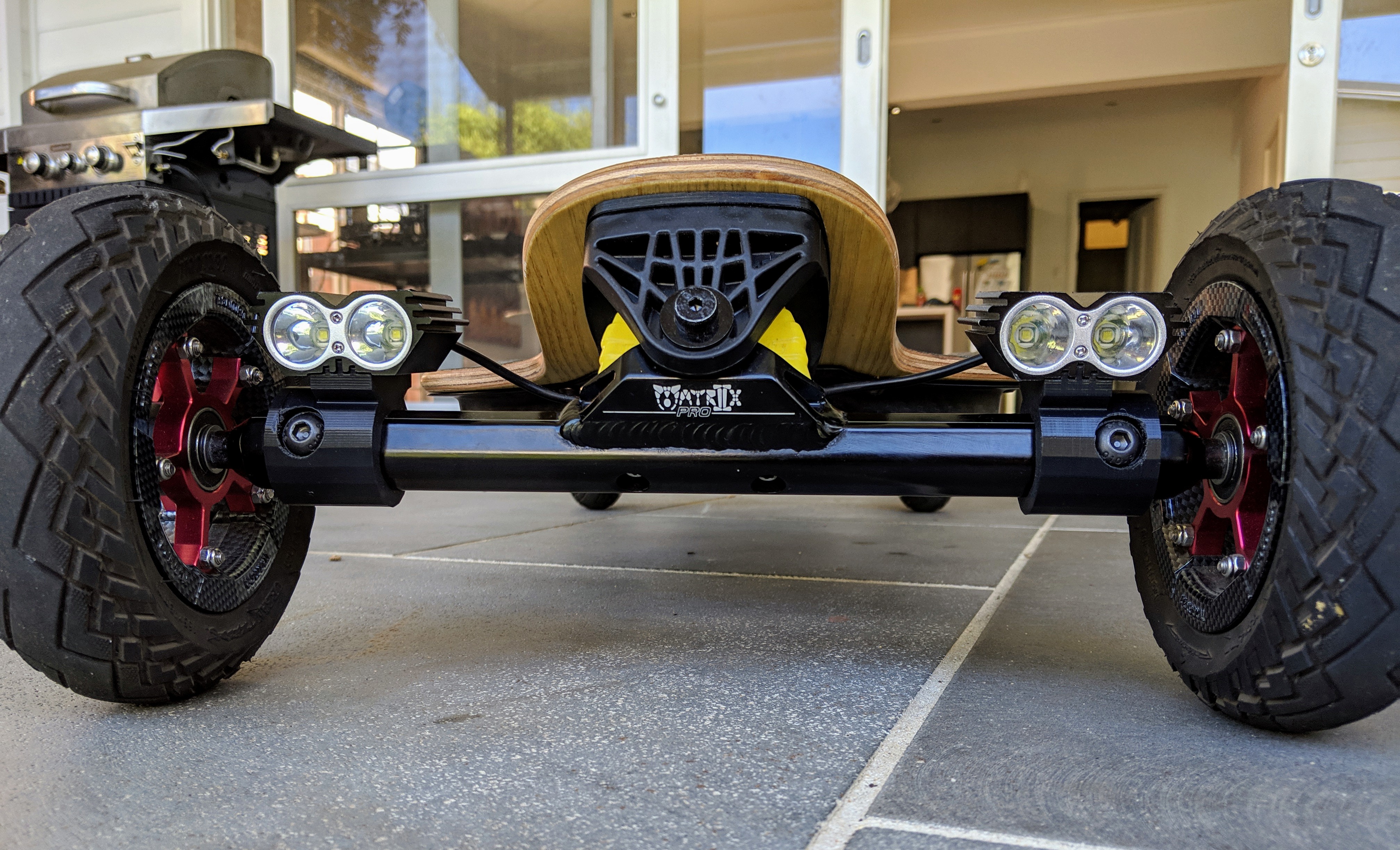

Lights for Matrix II Trucks

multiple questions… link for the light? how is it powered? whatt mounting bracket is that? pls help hahah

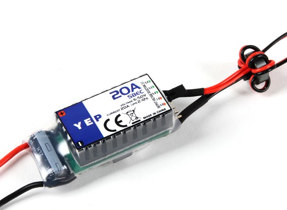

Light are ebay special, solar storm, the mounts are 3D printed, tpu 100%infill. Connected to internal cells by way of Sbec converter.
Stuff hot glue into the empty space in the solar storm lights to stop the coil popping off.
she bright bright? or just bright?
Bright bright,
Wouldnt hot glue just melt inside a light like that?
Been running them for 3 years, same set, same mounts, no issues, :crossed_fingers:(little rust on the screws)

You happen to have a file for those mounts?
I made them using tinkercad, my CAD skills were very shit back then. I’ll see if I can dig out the stl file, should be connected to my account.
I might redraw them.
