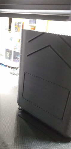

After ridding a hybrid style AT board for a couple months now I realized I need a smaller and lighter board for when going into stores and stuff so I started work on this guy-
It’s geared to go around 22 mph, hopefully get 15 miles of range and be light enough to carry around. My 2 top priorities are portable/lightweight and have a decent range.
I’m actually currently 34.5 hours into a print for its enlosure!
Ooh that looks nice! Same deck that mmaner swears by?
I don’t believe so it’s a skateshred deck
Are those Cals or TBs?
There Cal ll
Nice,
What is the expected weight?
I’m not sure yet but I’m hoping not more than 15 pounds.
