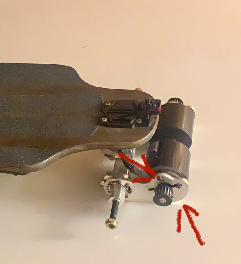

What is the width of the motor mounts from left to right ?
This handle would anchor well where the Motor bolts screw on the motor mount plate
Please confirm I think that Amazon Handle is 10.8 inches side to side.

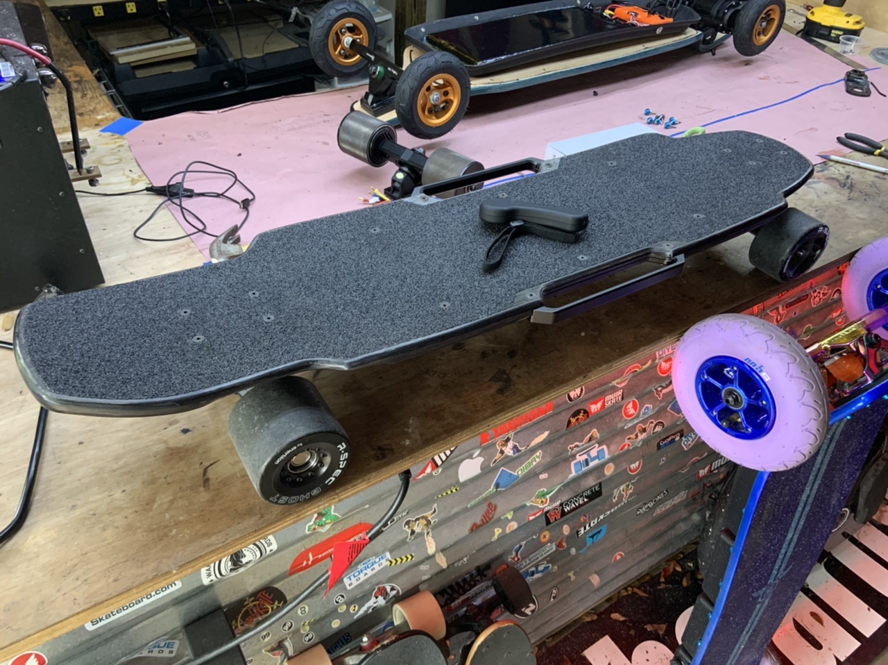

You don’t want to do that. It would mount to the truck bolts, definitely not the motor bolts. Also to keep squish from happening and negatively affecting handling and deck wear, I’d probably dril out the holes in the handle mounts and make spacers for the bolts, use washers on both sides, and use slightly longer bolts to accommodate it.
Please do that, sounds good. I definitely need a handle, plus my house has a few steps to the front door and dragging and managing this heavy beast is a must.

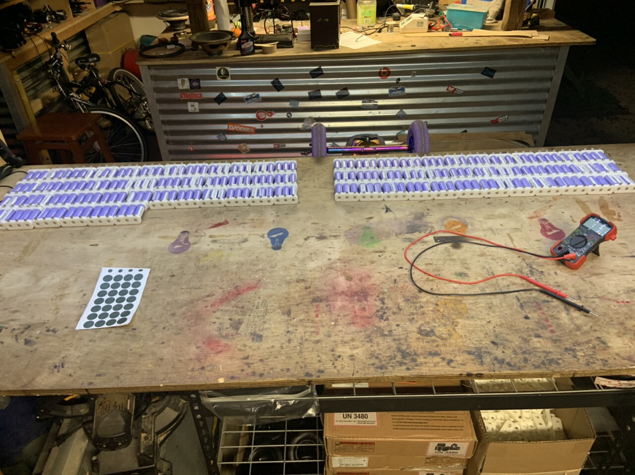

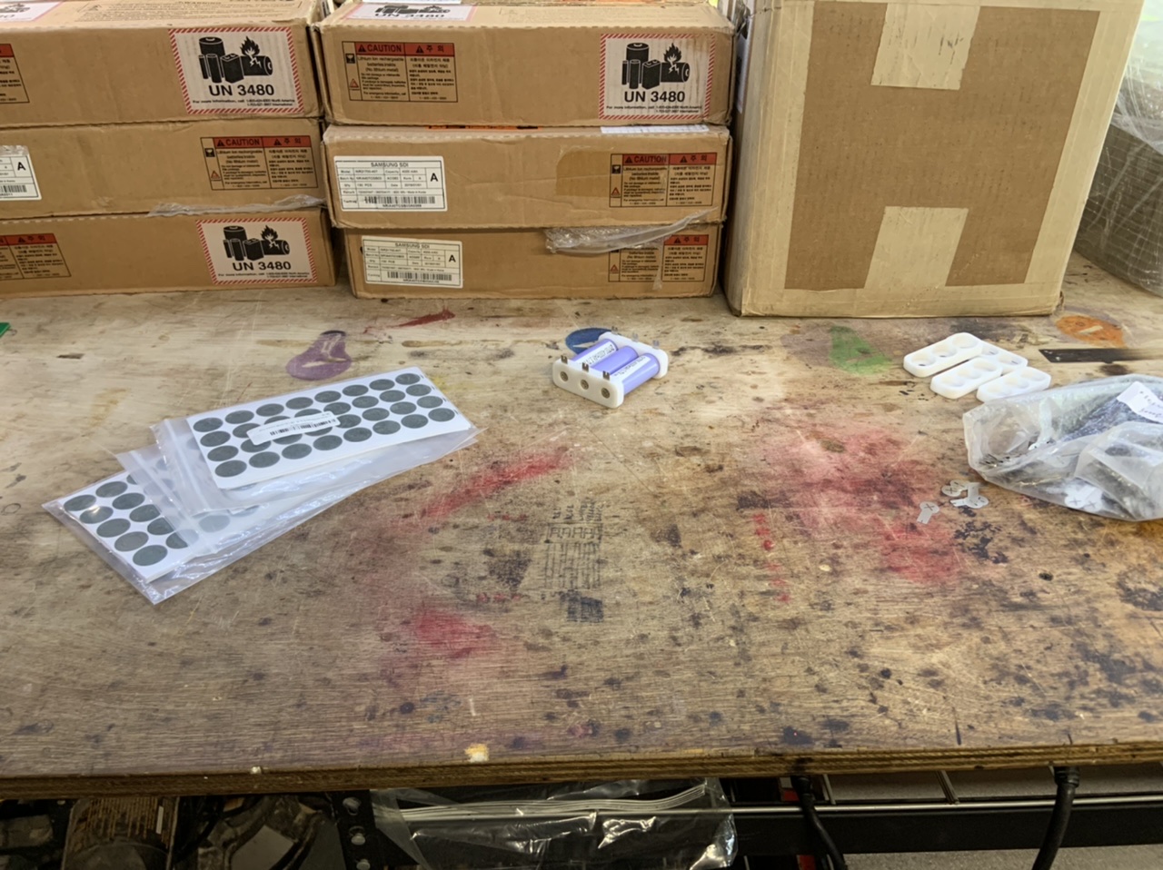

today im tacking cells for bioboards. those aren’t even all the cells, another 434 are on the way. Timing is great though, just finished two customs and took two more custom commissions so i have time to do this while the parts slowly trickle in for the new commissions.

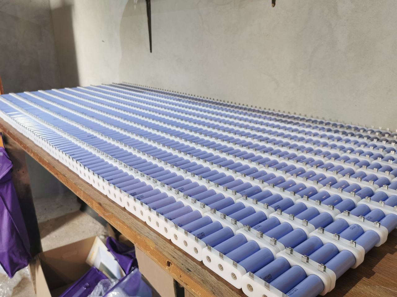

Soon your table will look like this
Lets hope for no fire lol
I may need to rent the house next door.
just 498 left to go lol damn
