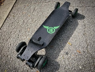

Did you say green look at this LHB masterpiece :call_me_hand:
image image
ya thats a sexy bitch but @longhairedboy just built me the sickest evo! and its a monster. probably all my next builds will be on pneumatics though. and my evo will probably end up on bergs too
