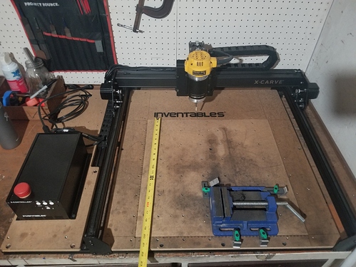

I’m going to use my CNC to make the mold. I would like to cnc a master mold like we see in the video below…
cnc mold
Epoxy tooling board like we see above will be quite expensive at the size we need, roughly 1000mm x 120mm x 330mm OR 40in x 5in x 13in …RIP tooling board.
What else could we use that would be super cheap? XPS foam? MDF? Either one would be easy to machine and very cheap. We could coat the finished shape in epoxy and bring it up to a glossy finish.

My CNC bed is not large enough to cut the full 1000mm in one go. So I will cutting the mold in two sections and joining them together to make the final mold.

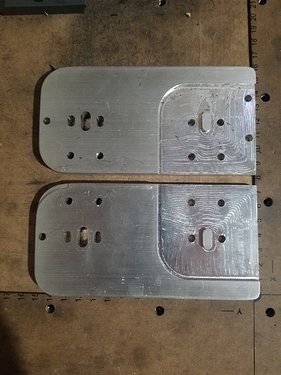

My cnc also does not have enough clearance in its stock setup so I will use these risers I made for a previous project.

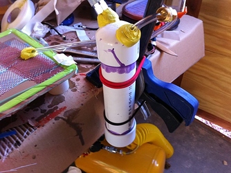

We also need something to catch resin, for this I will diy, something like this but not so F*ing ugly…

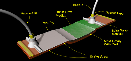

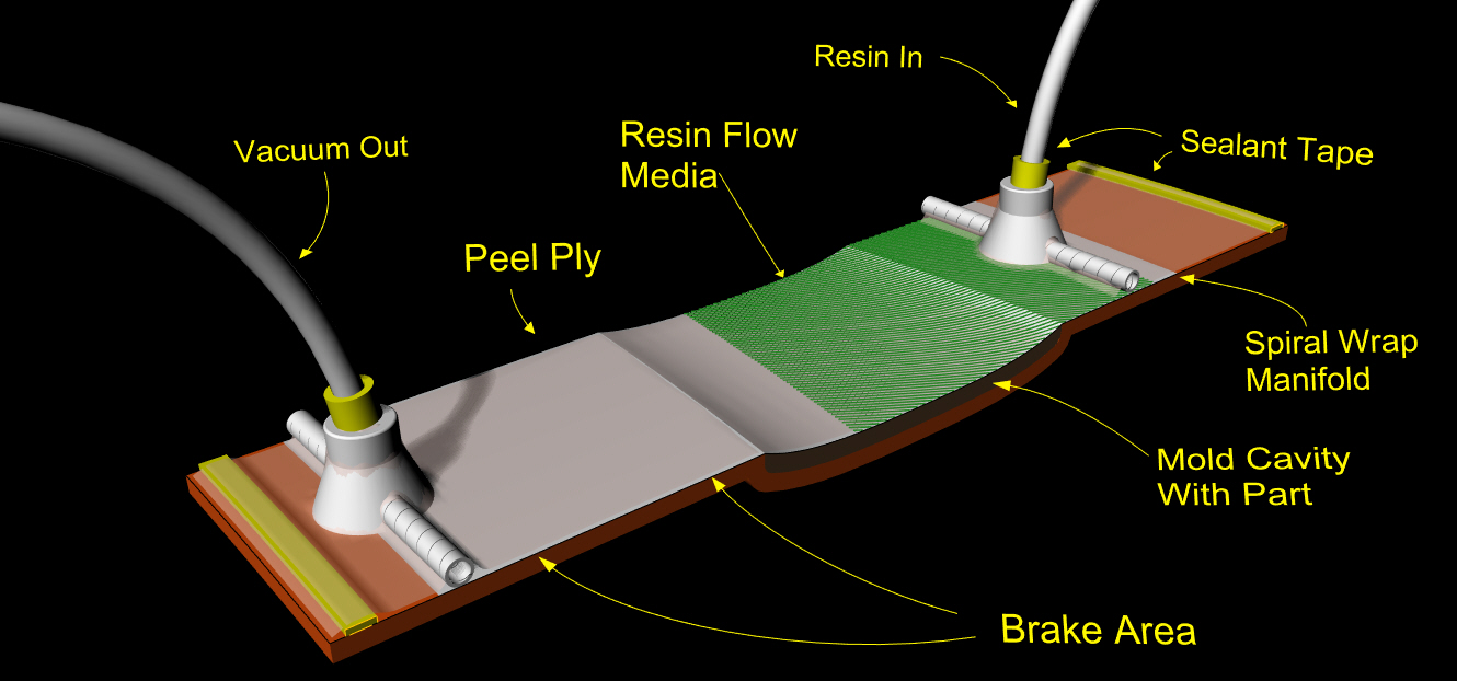

This diagram shows the methodology very clearly:

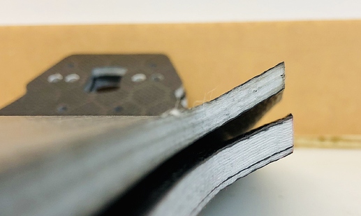

Now we come to the real meat and potatoes. This part will take a lot more trial and error I feel as my exp with composites is limited I have done simple layups with fiberglass and ply wood, worked with pre made carbon fiber plates. But in both cases I was only going for rigidity. Not attempting something that has a specified flex based on payload weight (the rider).

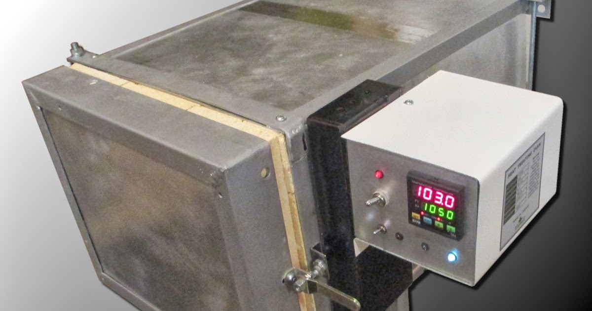

Short of an autoclave, if you want to get your resin to cure at higher temp, you can use an electric blanket under or over your laminate. Quite a few people building kiteboards or snowboards use them, I don’t see how it wouldn’t apply here.

How much does it raise your X axis with those plates? 2" ?

I thought that the excess will get sucked up by the pump into a can, won’t it?

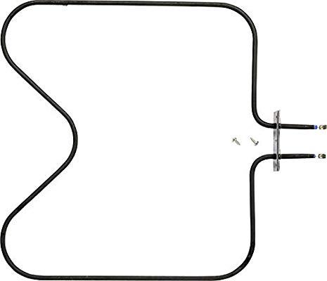

Something like this would be legit…

“How much does it raise your X axis with those plates? 2” ?"
3in
Legit, but a little bit overkill for composites! Everything would be vaporized at those temps!
XD true. I was more thinking precise temp control. I read that the curing of some pregreg requires stepping down the temp over a period of time… I think…

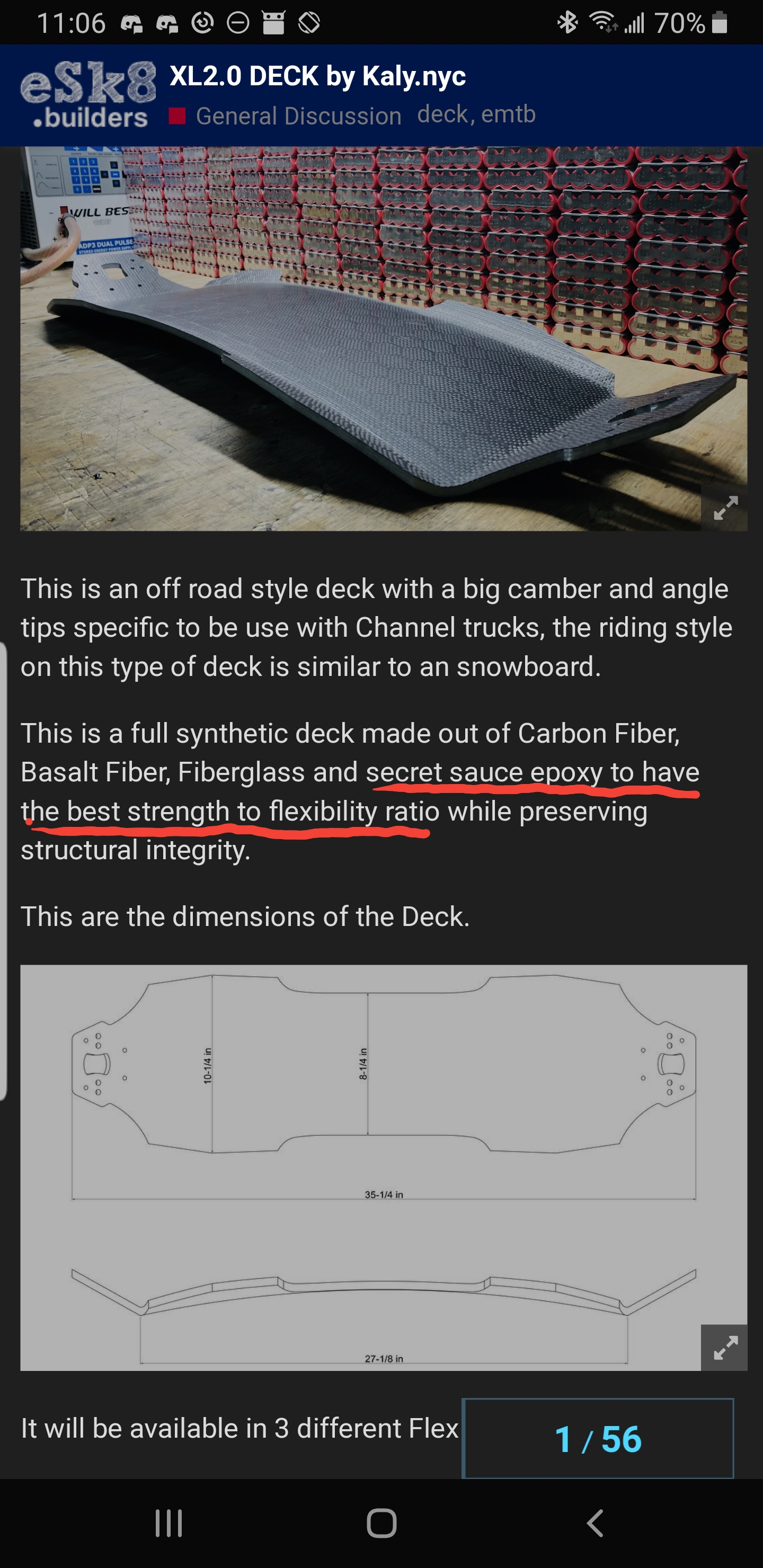

I have noticed that Kaly uses prepreg for his decks. When soft it can be cut using shears, especially when doing layup one layer after the other.
interesting. I thought it was an infusion method.
so maybe prepreg is the way to go then…
I saw this and it made me think he was doing infusion. maybe the “secret sauce” is the ideal ratio that you get with prepreg! XD
