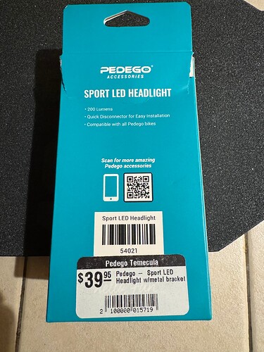

Pedego ebike lights. Good for 48v. 40$ each.
road specific (I.e. shaped light cone that doesn’t make you that guy with bright fuck-off lights aimed at other riders and cars eyeballs)
2 pin Juliet connectors stock. E-bike mechanic at Temecula Pedego threw in a Juliet connector harness for me to cut and solder on. Cool guy, showed me a bike trailer, told me his neurotic Australia shepherd wouldn’t tolerate it. No way George would then.
Mounted in 20mins to matrix hangers. I approve.
And then the Lezyne 500 lumen 52v e-bike single light, (60-70$ for one). Not shaped, gets hot to touch in 2 mins if not riding with airflow. GoPro mount.

Got a link for these or a model number?
