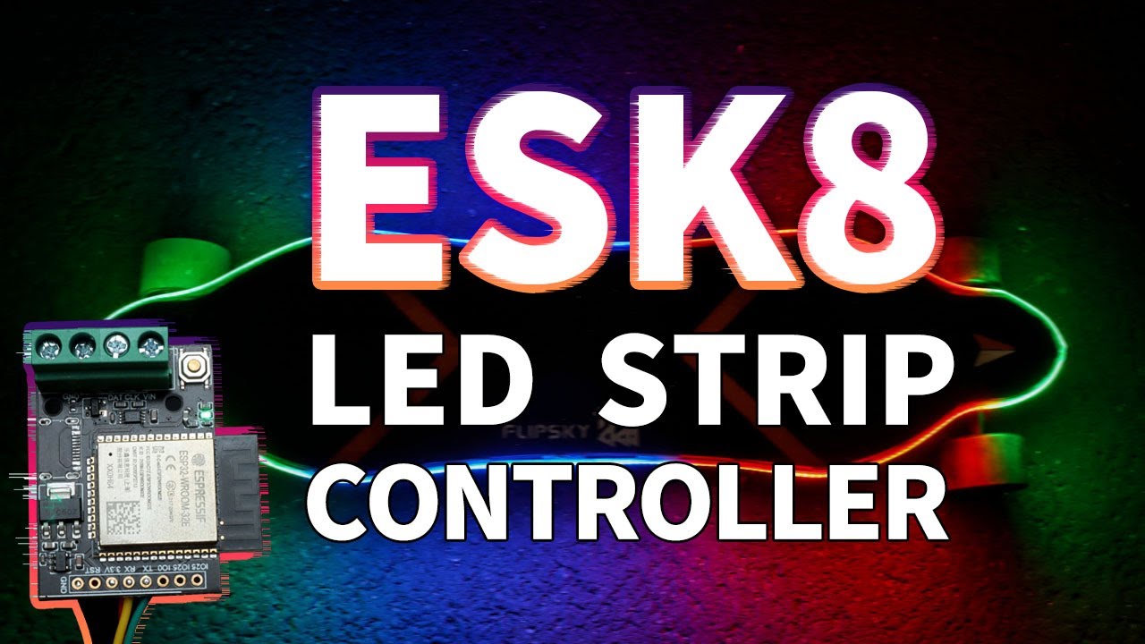

Interesting new thing from Maxkgo/flipsky (not sure who maxkgo is… anyone heard of them?)
Looks like it plugs in to your esc and changes light color and behavior based on your signal.
Flipsky sells it here: Flipsky ESK8 Sport Waterproof LED Strip Controller For Longboard | Sco – FLIPSKY
But you might get a better deal from here (manufacturer?): ESK8 Sport LED Strip Controller Compatible with VESC/FSESC/Focbox for
Oh wow, it’s literally an ESP32 breakout board lol (and a buck converter)
The hardware itself is dirt cheap, but a small price to pay for someone else to do all the coding. And probably pretty easy to hack and modify.
I wonder what the input voltage is on the buck. Probably not more than 10 or 12S, but it isn’t listed
