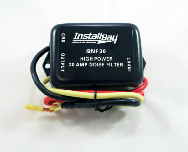

I.appreciate all the info and help… And there’s no easy solution for noise…if it is noise like these?
I know these are more car audio but anything comparable given our application?
There are off-the-shelf noise filters available and they can help, but there are a lot of different types and variations of noise, and some filters are more effective at some types than others. Also the commercial ones tend to be pretty large, especially the really effective ones.
