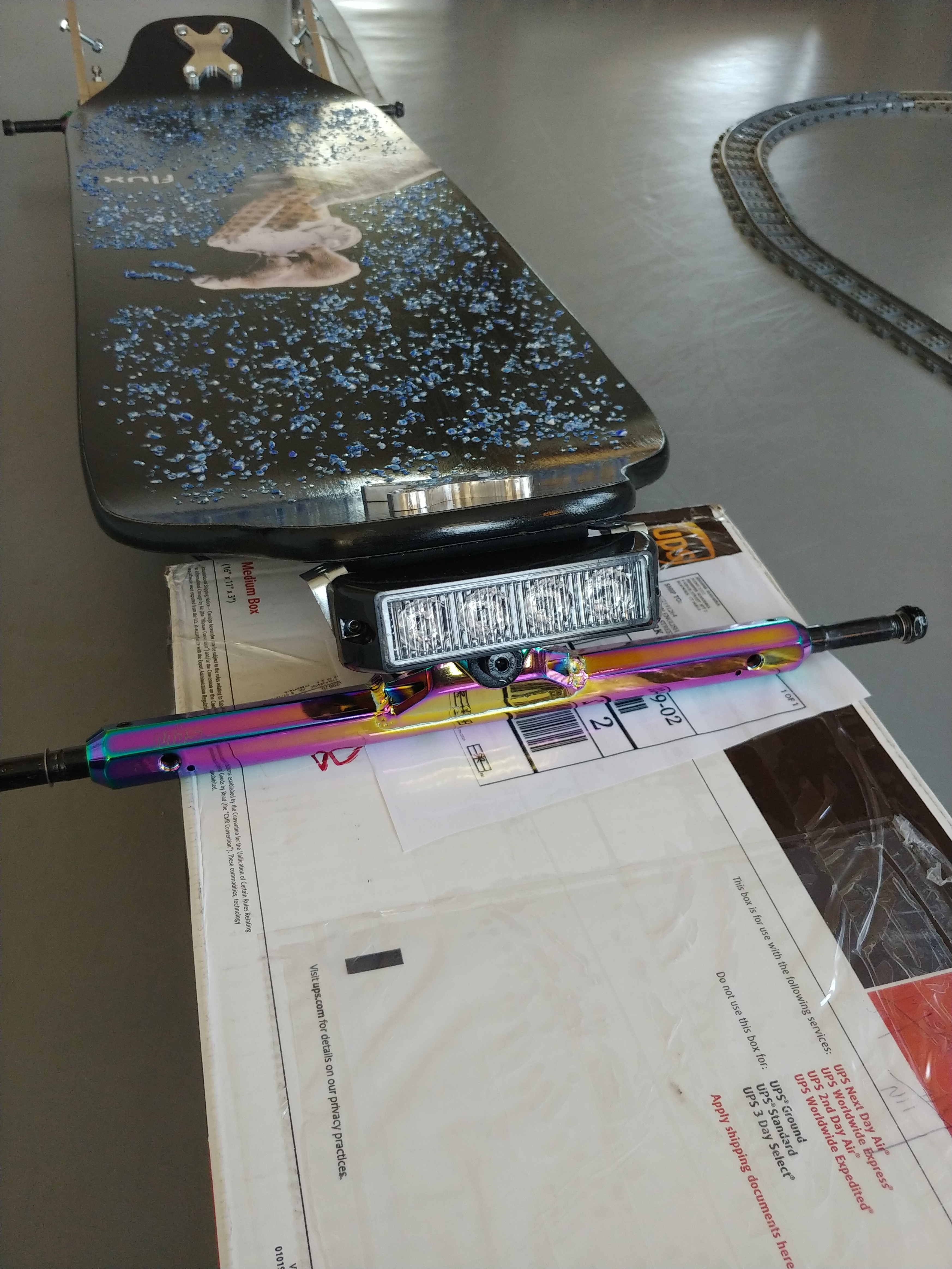

https://www.amazon.com/KAWELL-Inches-Lights-Flashing-Driving/dp/B07VZDHRJ8/
i dont need a headlight but def intereted to see what the throw is for this light. I got one wired up on my new build for a tail light set to super techno flash mode lol… def bright AF but for a rear you dont need as much projection or focused light direction
Sweet setup…
I mean it looks cool, however, it also kind of looks like “time to blind everyone,” I’d think you’d want it pointed down more no?
I guess it works if you’re going for purely visibility though

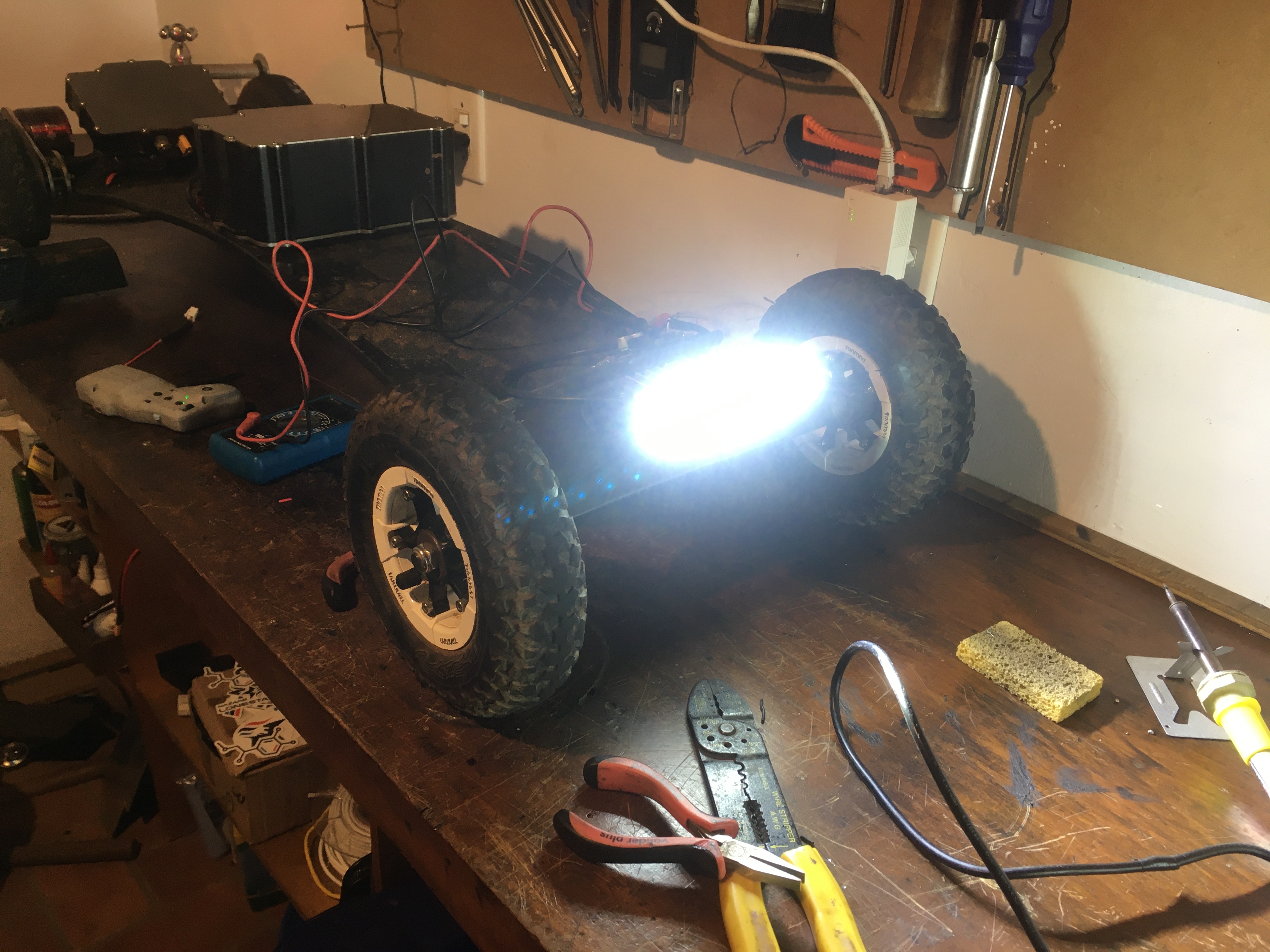

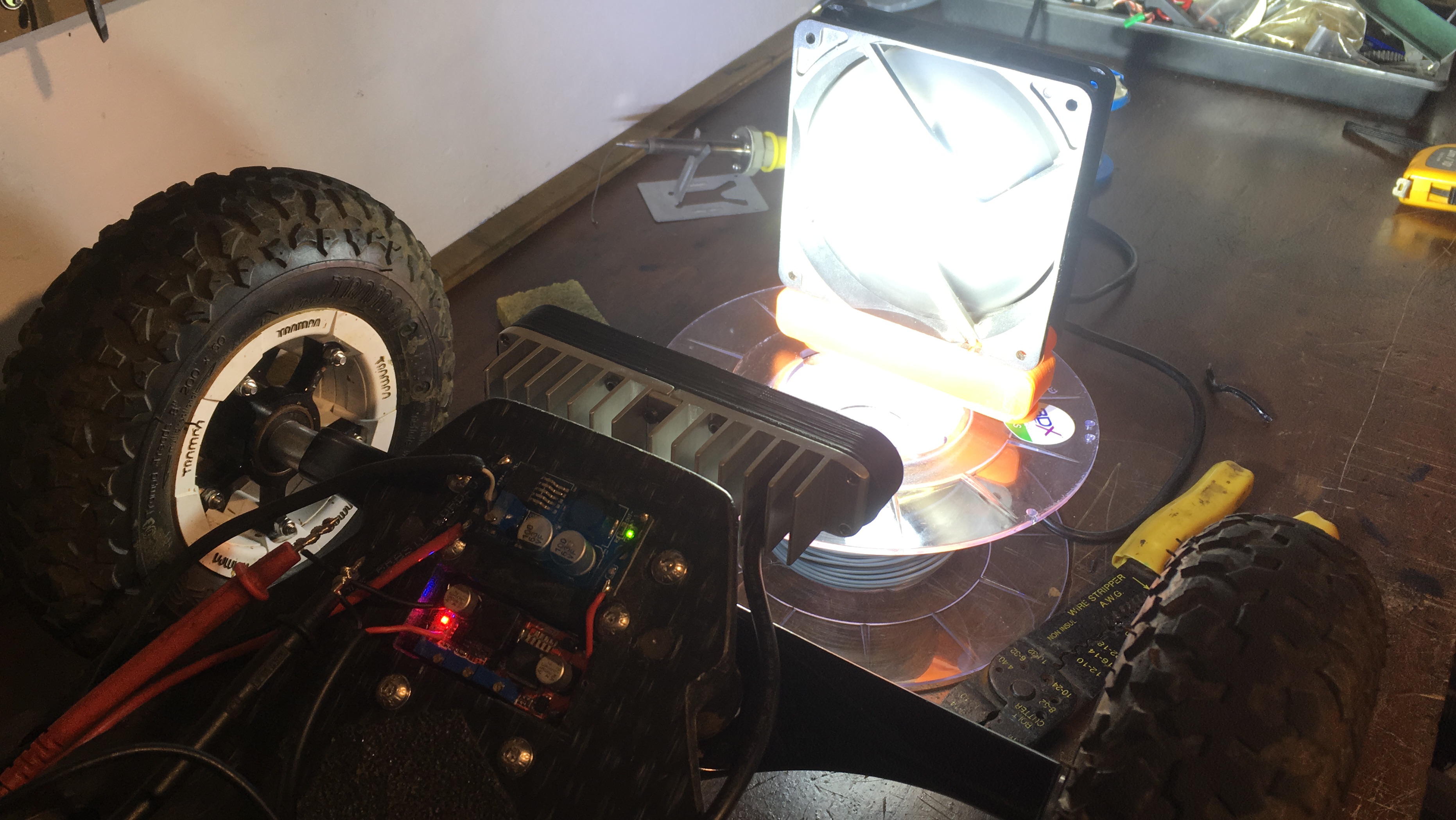

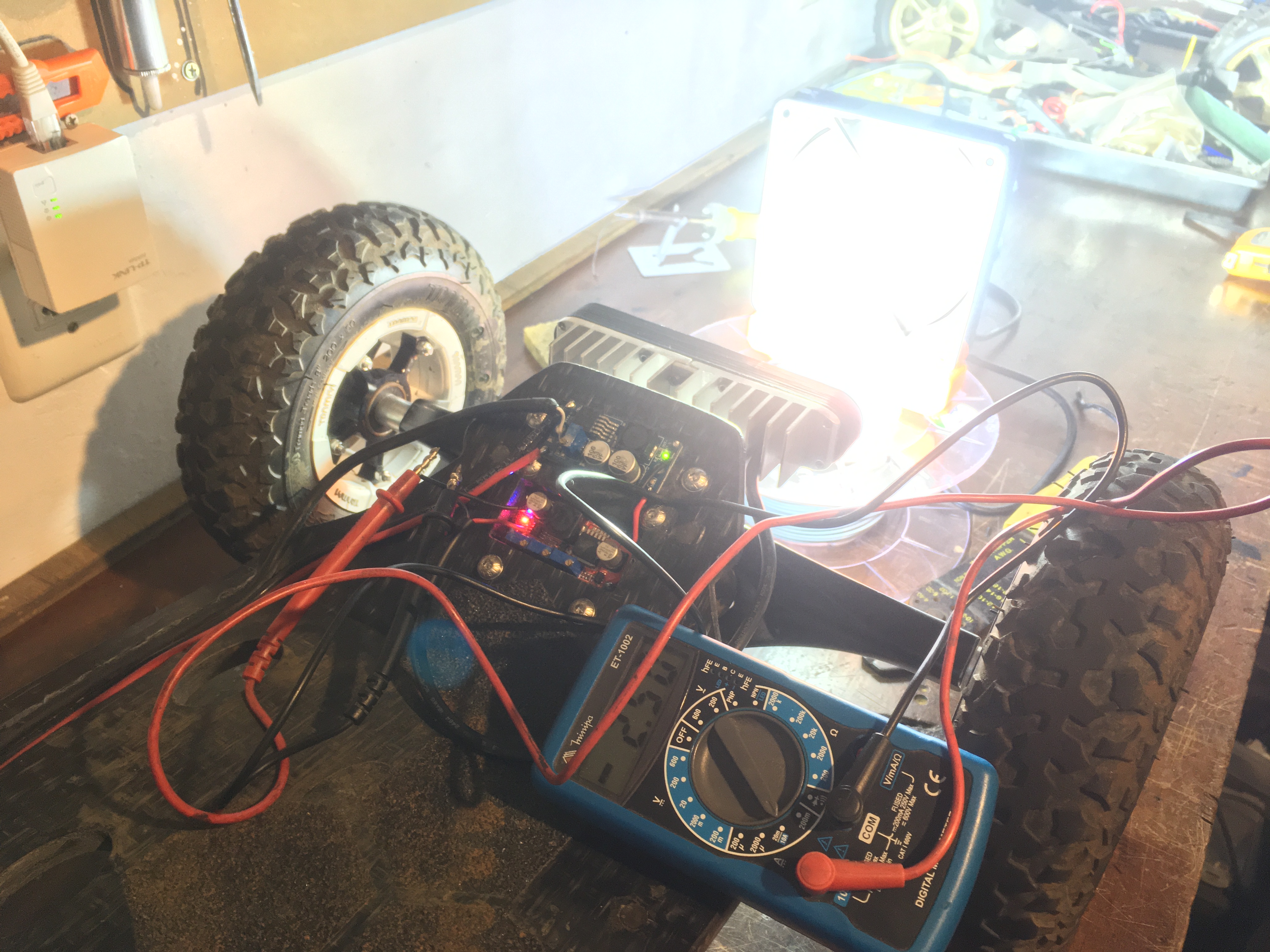

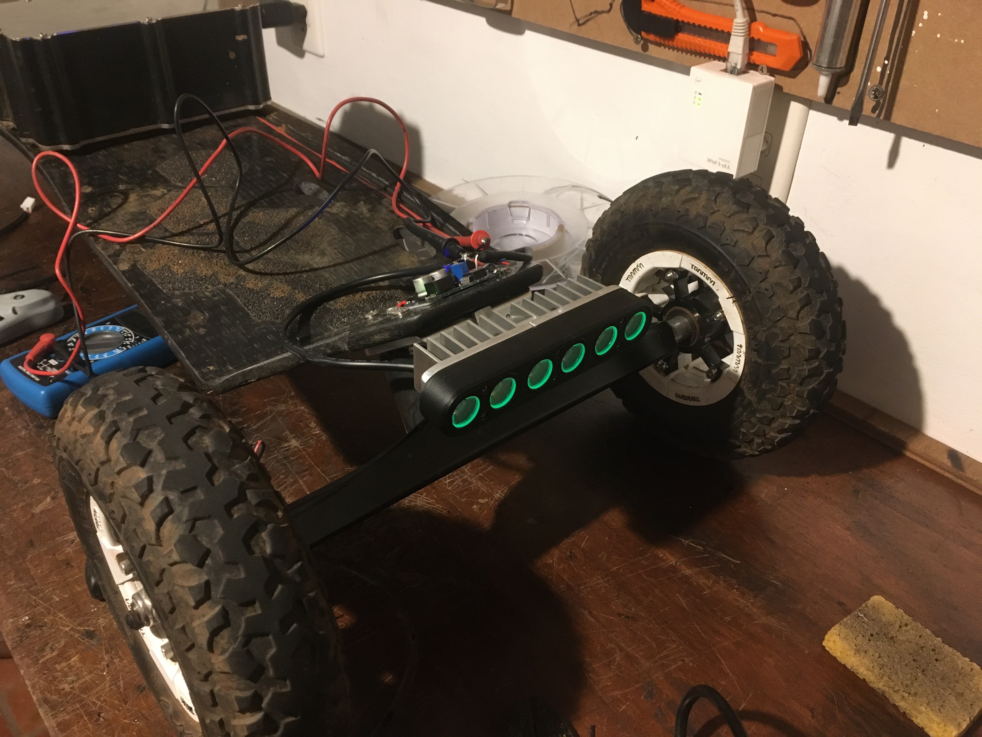

So far I put more time than I would like to admit on this light, cutting the heat sinks without the proper tools was a fun experience
It’s made from 6 Cree T2 U2 bin leds from Lacroix lights, all wires in series, if I manage to keep them cool and drive at the full 3 A current and will produce a total of 7700 lm
I sized the heat sink to handle that, shame I screwed up on the calculations and it’s nowhere near enough with the board standing still
These drivers I’m using are barely being able to handle, there are one LM2596HV steeping down the battery voltage to 25 V and one regular LM2596 acting as a constant current source, this bottom one is cooled by the truck baseplate with help of thermal pads
From my tests so far I can drive It only up to 1200 mA for a 60°C heat sink temperature, and at 2500 mA the driver starts to cut and the light blink randomly, probably hitting the 125°C limit
So now the plan is to ride at the 1200 mA, if it’s enough light, all done, if not, I think I will enter the rabbit hole of designing a custom driver that can take the battery voltage directly and also can adjust the current based on the LED temperature, this way I can have the full brightness at 3000 mA when there is airflow without everything melting when stopped
The previous light I was running had 1000 lm and was nowhere near enough , this running at 1200 mA has 2800 lm
