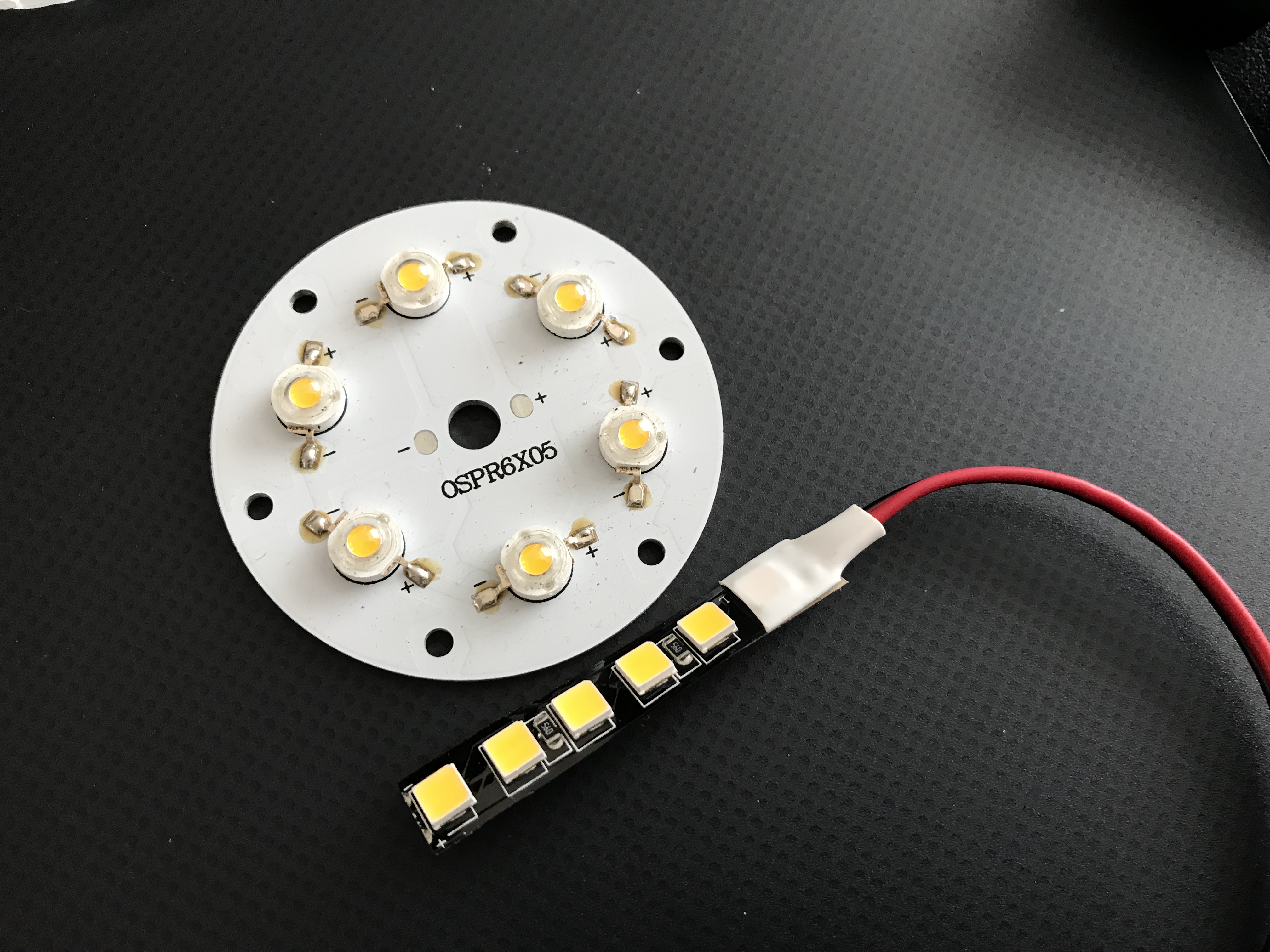

As a very general rule of thum if the LED or strip has inbuilt resistors use CV
it’s equally possible I’m remembering wrong lol

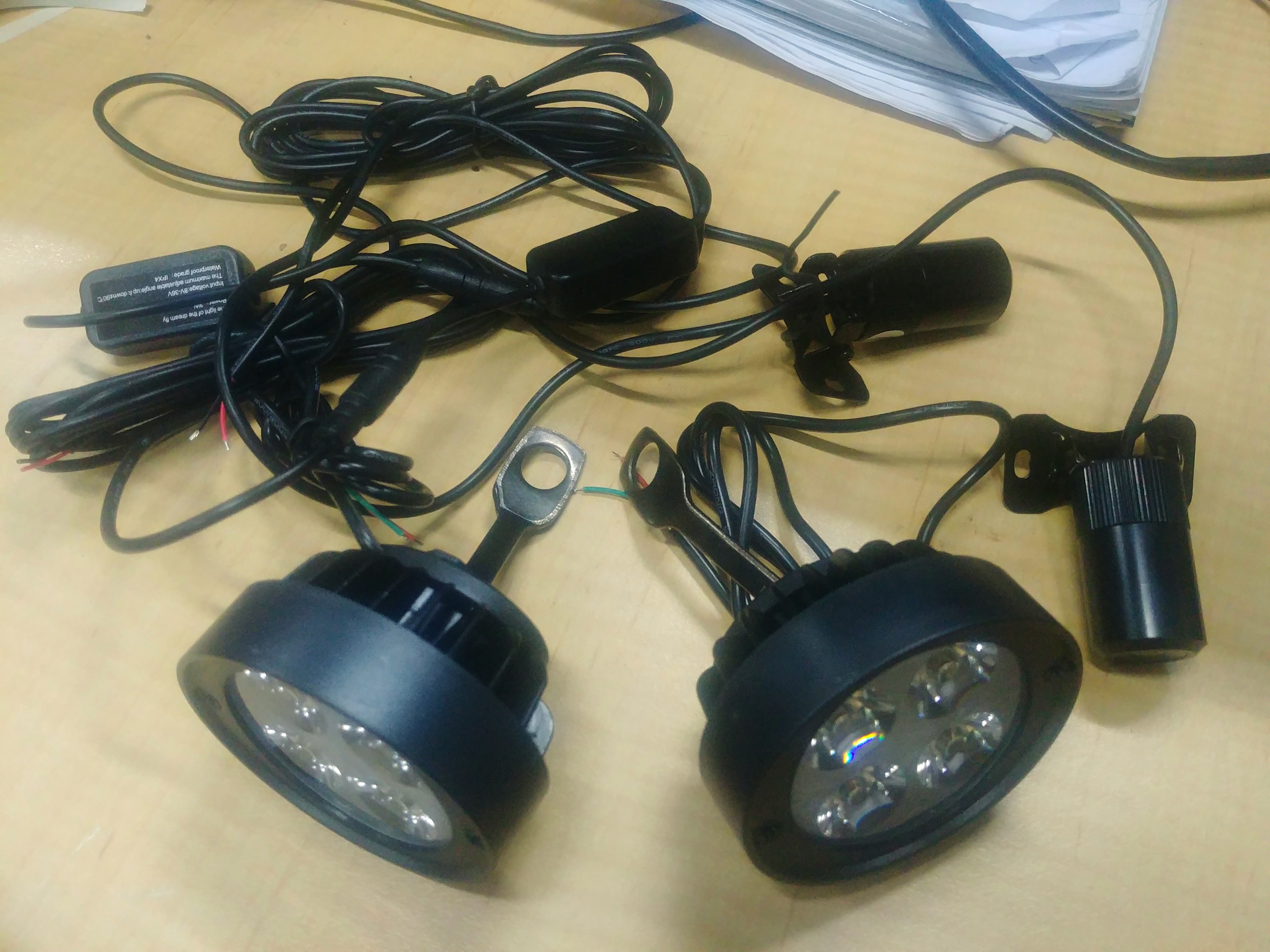

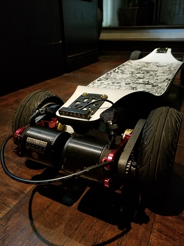

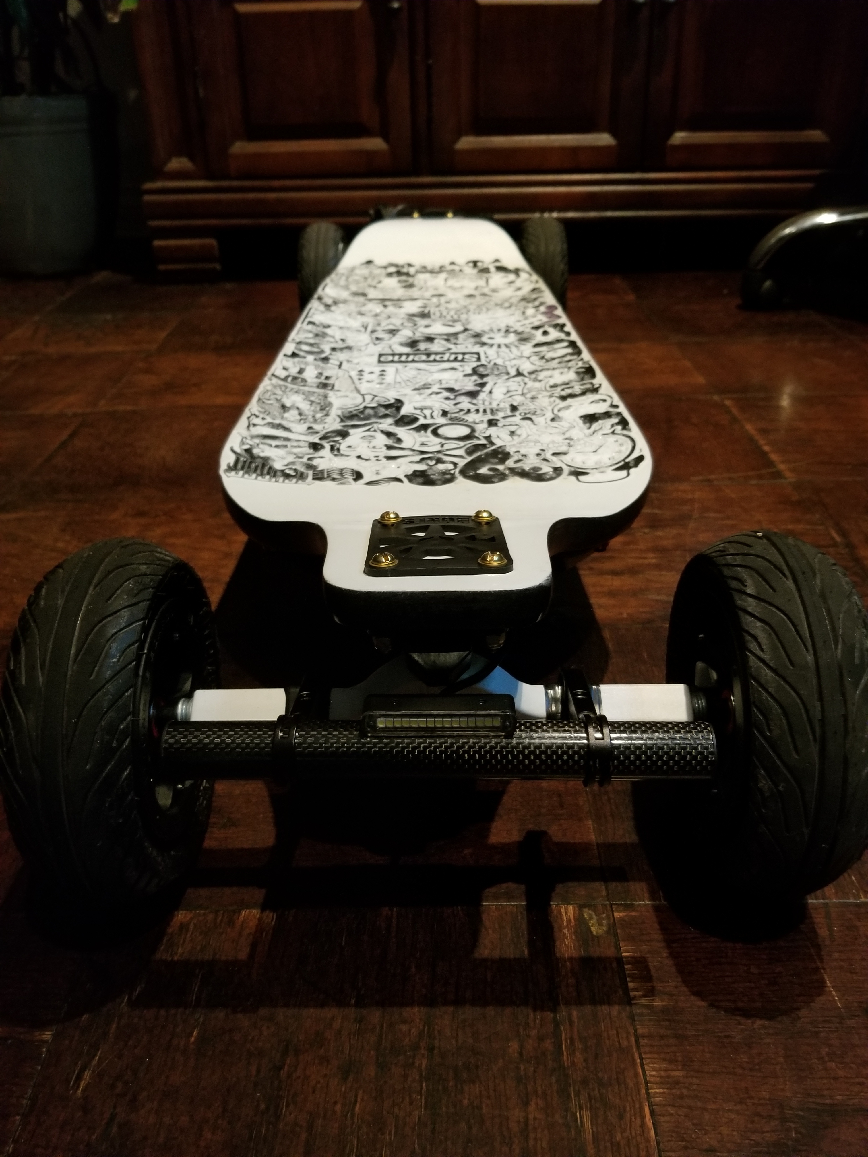

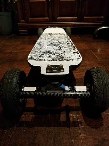

New headlights and angle wings lights arrived from china these will run directly off my battery no bec buck required.
I really want to see how the wings turn out
checked, mine are CC, and looking online that’s what most are 🤷
possibly CC via PWM?

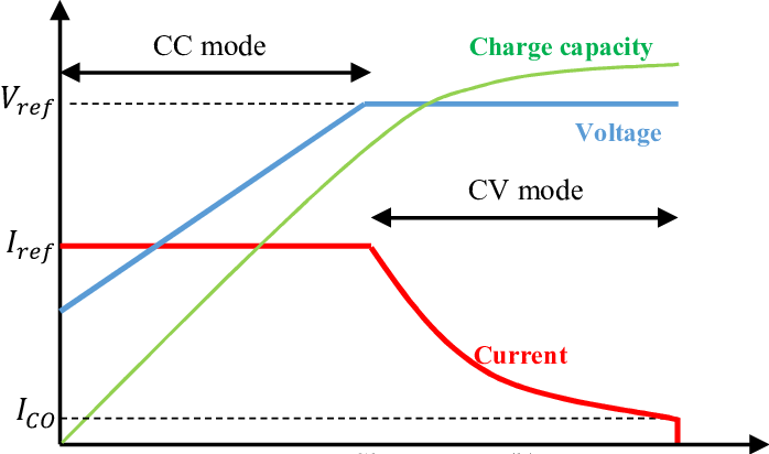

charge profile of Li-Ion battery pack
The strip is best to use cv driver
The round pcb best to use cc driver

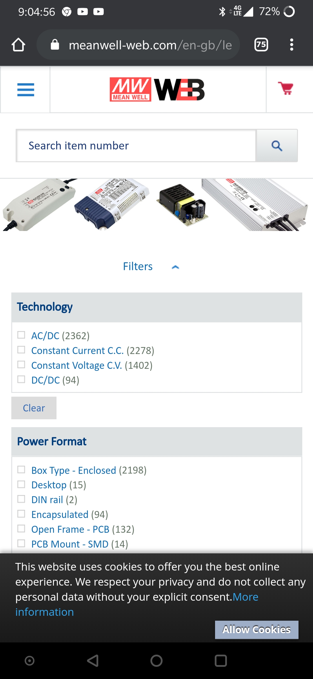

going by Meanwell, cc wins :yum:
https://www.meanwell-web.com/en-gb/led-drivers/
I use a constant current driver kit designed for 12v daylight running lights I learned the hard way burning out 3 12v lights before I learned my lesson.
Well if I was building a weed grow house selecting led heat sinks and power supply’s I probably would use a cc. If I was using eSkate light or I would go CV useing a resistor to limit current.

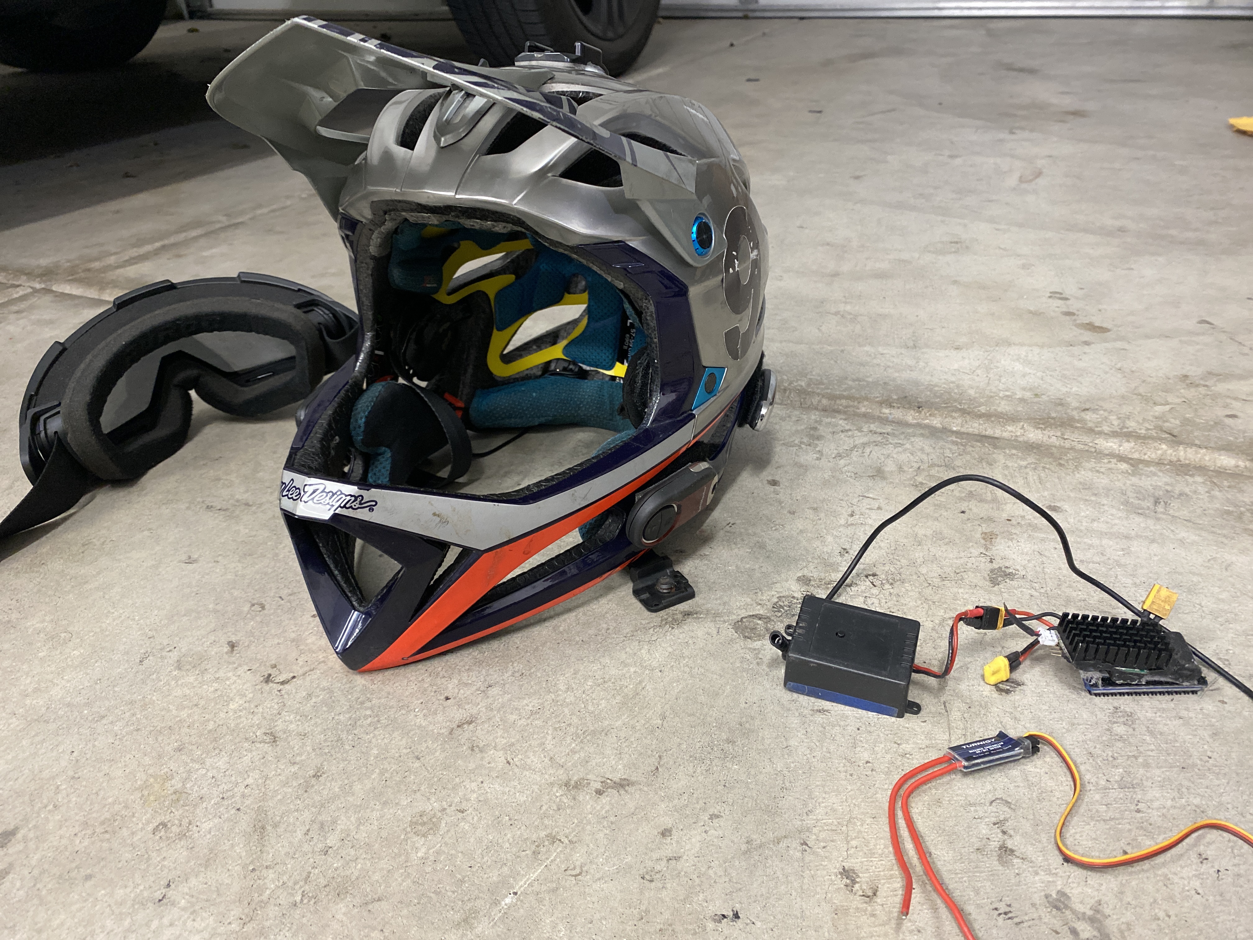

Helmet mounted light slays the darkness.

I feel better about the growing collection of nicknacks on my helmet.
Bluetooth controls, garage door opener, RF controlled board light, motocross quick release googles.
