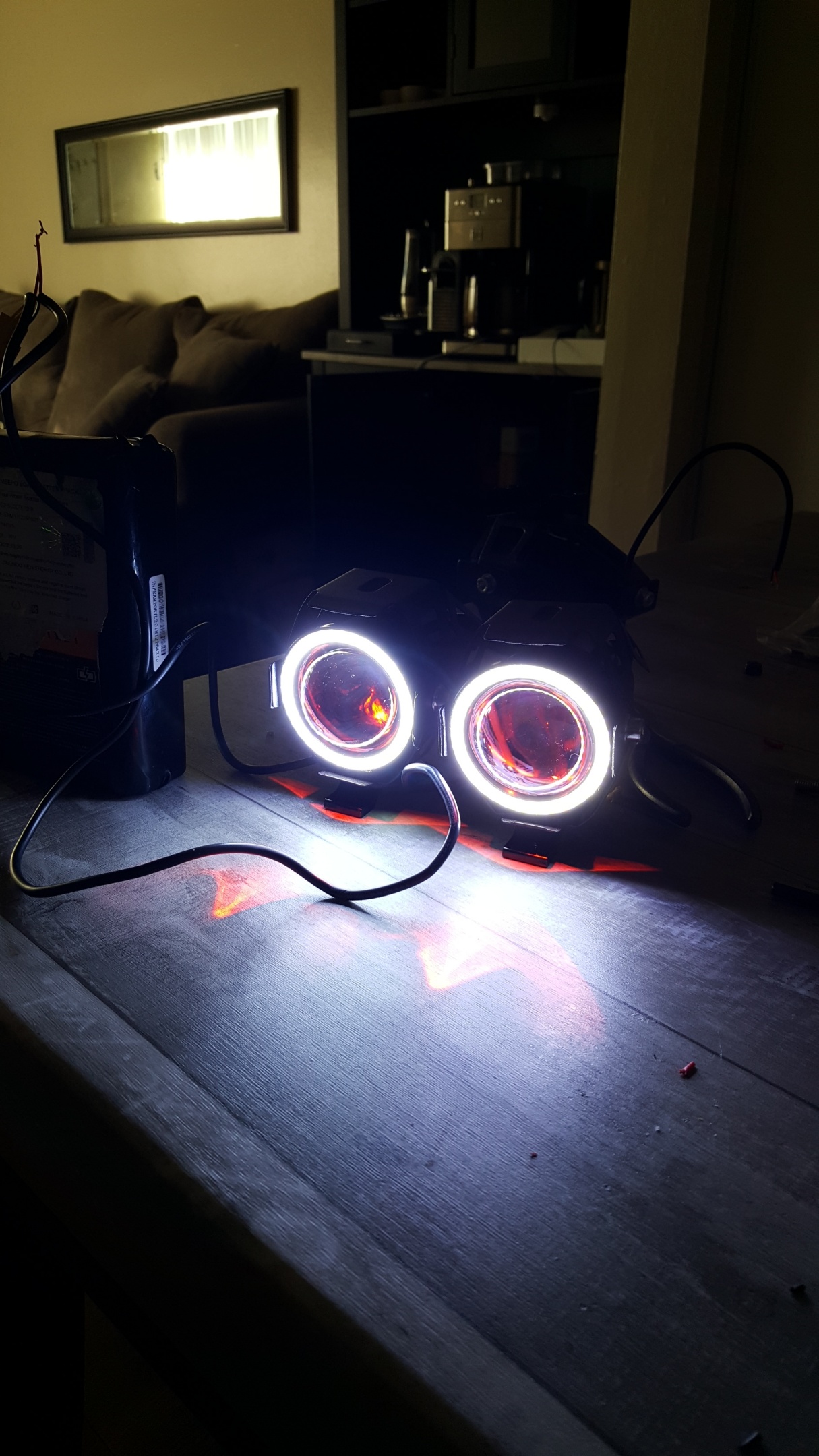

I used to use that light, but the capacitor wires kept shorting and blowing the board. I went through 3 of them before I gave up. It probably works a helluva lot better on your board with your pneumatics. The meepo that I had at the time had a rough ride and the vibration just destroyed these lights. SUPER bright though. I loved it when it worked.

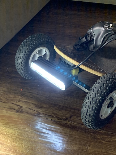

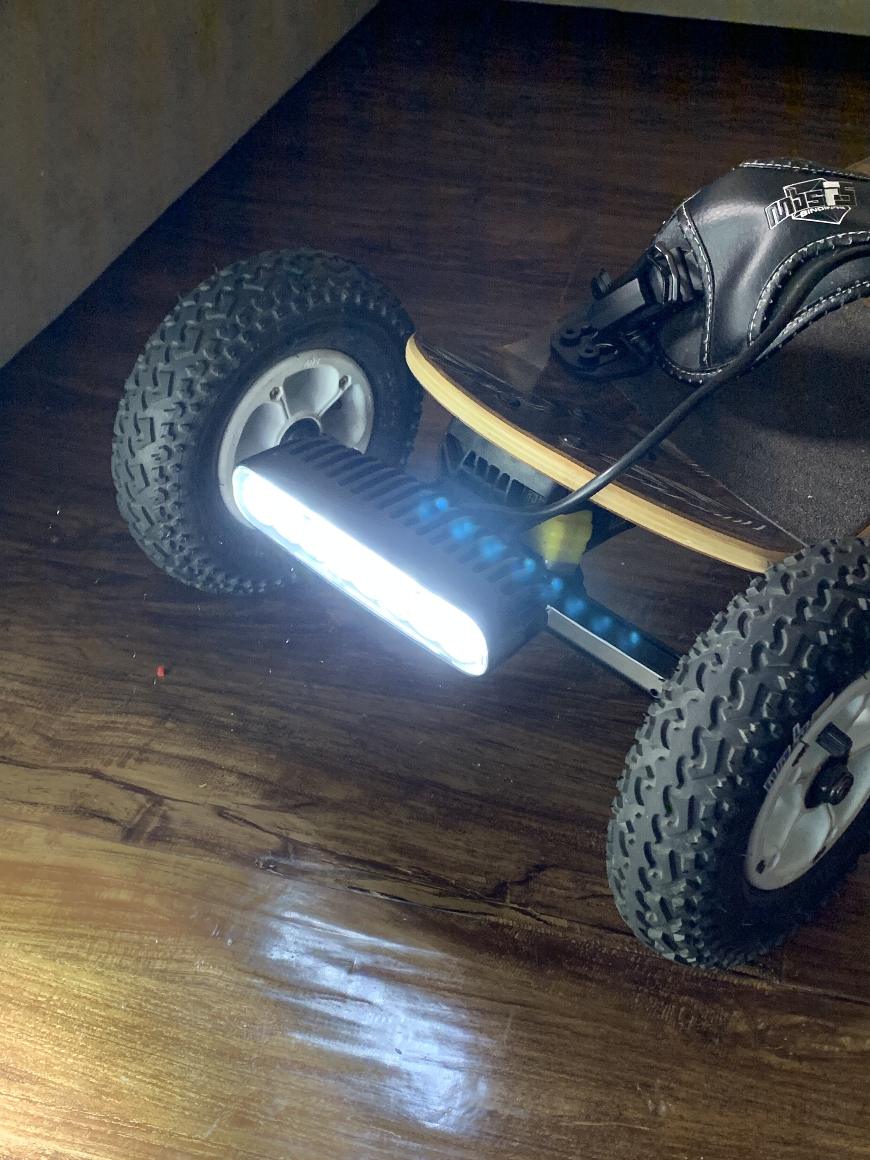

The 60v lights from Amazon can be bolted directly to the MBS Matrix baseplates…I love that so much. Splitter with a toggle switch from the battery to this guy

Awesome! Can you share a bit more on how it bolts directly? I have the metal baseplates
Sure, you know the axle that bolts the hangar onto the baseplate? You can take it out and stick it through the bracket for the light so when you assemble the truck, the bracket is clamped in place, centered and about 5” off the ground, then reconnect the light (use nylock nuts)
Sits in the perfect spot with no mods and about 5 minutes of work
Perfect! Thanks for the deets my dude.
You using a step converter or raw battery voltage?
Raw off the 10s pack which is the beauty of this thing, I have a parallel splitter so it pulls off the pack before the loopkey. Will go to 12s eventually
It draws constant .67 amps at any voltage if I remember correctly
