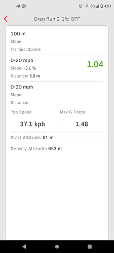

Actually just been looking up some bike accelerations and turns out I can match a 1000cc to 20mph while standing on my wooden plank :eyes: :flushed:
Okay so a new best for me but no change in ranking :laughing:

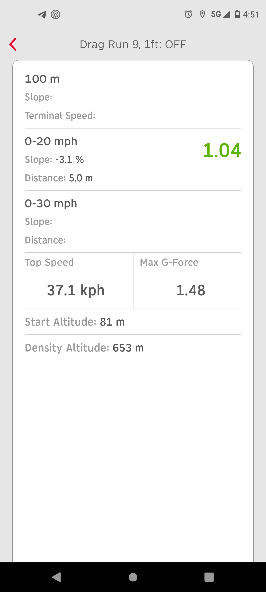

Managed to pull almost 1.5 G’s peak though :eyes:
Might be too much lean, needs to be workshopped a bit I think.

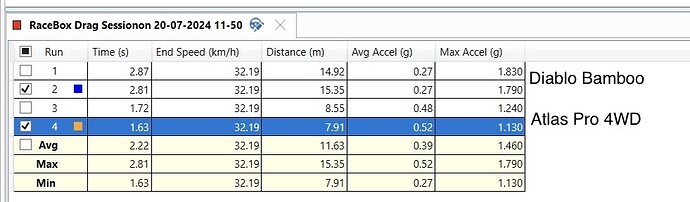

Got a chance to strap my RaceBox to the Diablo today so thought I’d add some production board times to this table. (I had 1ft rollout on in the RaceBox app, so exported the VBO files to VBOX Tool and got times from 0 instead)
“but wait 4WD vs 2WD is unfair” - evolve fanboy?

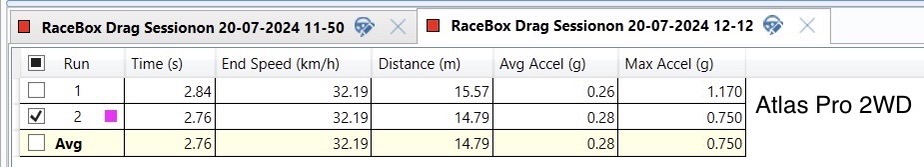

to be honest the Exway did have an advantage as it was running smaller tyres (165 vs 175). The Atlas Pro was running a 4.3 ratio gear drive which should be similar to Evolve’s stock ratio (14/66? - not sure what motor pulley they use). Nevertheless, that shouldn’t offset a over 3x (200a vs 60a (2WD)) advantage that the Diablo should have compared to the Atlas. Another note is that I’m a fatass (95kg sans gear) so these times are far off what the best possible drag times are for these boards, but since I did these runs back to back they are at least comparable to each other.

The keen-eyed of you would’ve noticed that the Diablo actually pulls a much higher peak acceleration figure compared to the Atlas. This is from their burst that in my case doesn’t even get me past 1kph (estimated), I assume this is what they get their 200amp rating from and it’s what makes a lot of riders think that their board have a ton of power when really if you just keep holding it nothing happens. I was honestly hoping that this new Diablo would’ve been a better entry to get more people into racing (they are by far the most popular brand in the UK) but with such a minor increase from the Hadean (unfortunately didn’t have one on hand today to get data from), it’s kinda a disappointment that my now 2 year old Atlas will just disappear off the line compared to it.

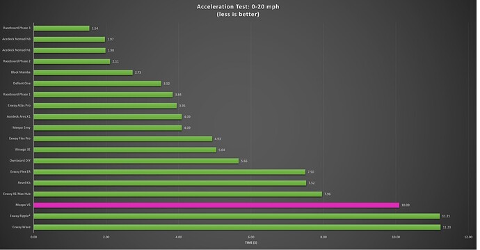

Got a janky looking screenshot for now.
@TZDKB I’m super confused on how you got those times on the 2wd atlas pro. Seems WAY too quick to me.
I tested on stock (175) tires in turbo mode and as you can see below, much slower.
I am about 175lbs
This chart will be in my next review as well and will gain info with every board I test. I’d love to check out the Diablo times but I haven’t gotten my hands on a board yet.
It feels like something is off with your data but I can’t be super sure. My data is all dragy

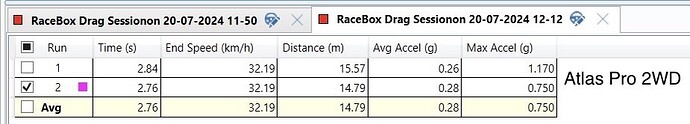

Maybe the combination of 165 tyres and a lower gearing makes all the difference? You’re lighter than me too, but I’ll re-run the 2WD times next time I’m out on the Atlas just to double check.

Which is not the case - and on top of that, the Acedeck N1 and N3 have “slower” times that yours and feel dramatically faster than the Exway atlas Pro, as experienced in my testing, and as shown on my chart above.
