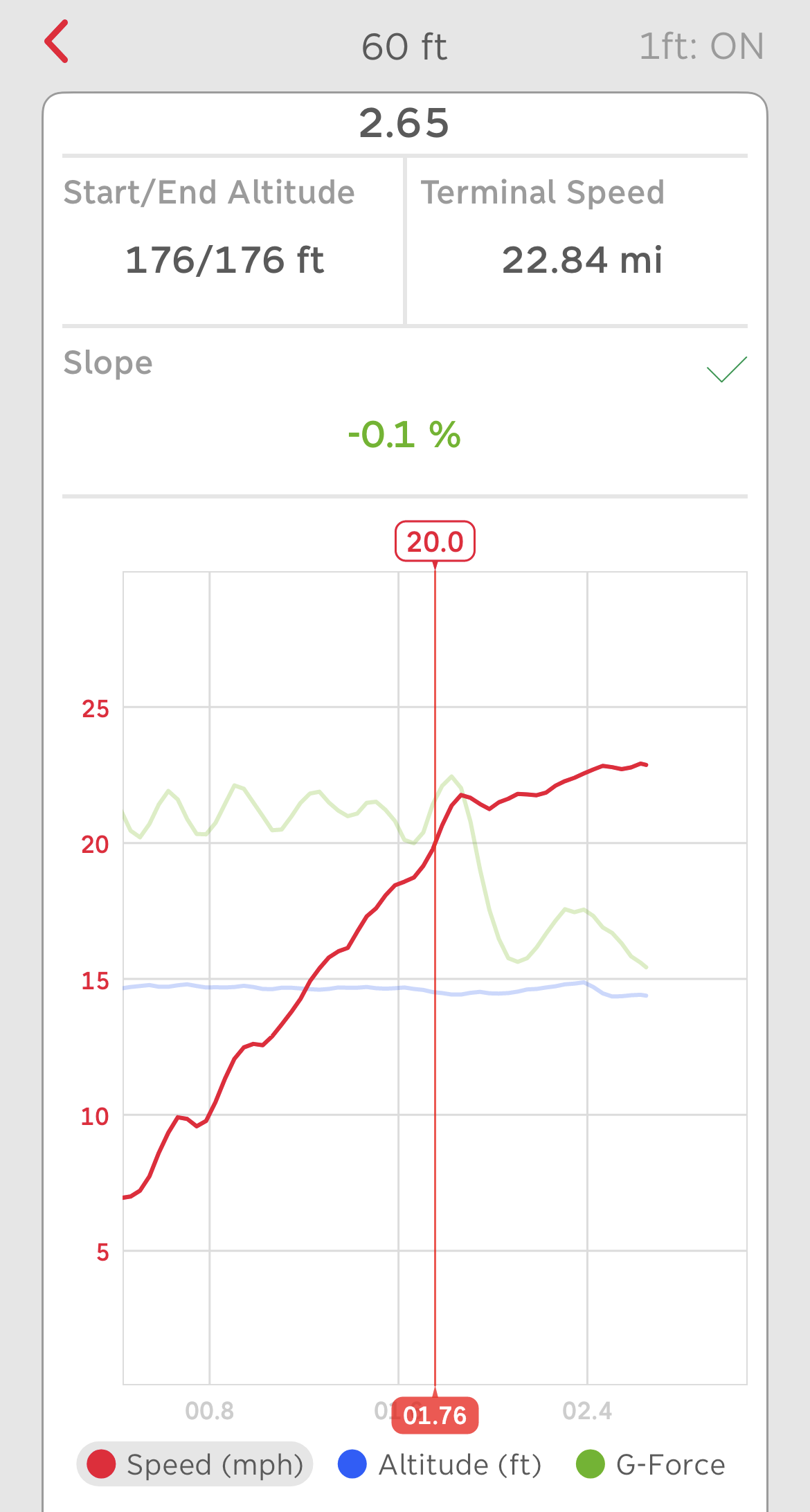

My lacroix (5.5, 18s,151kv) was 1.95s 0-20. Probably good to make a distinction between the board owner and the racer who set the time.

Aww looks like I had 1 foot rollout on
