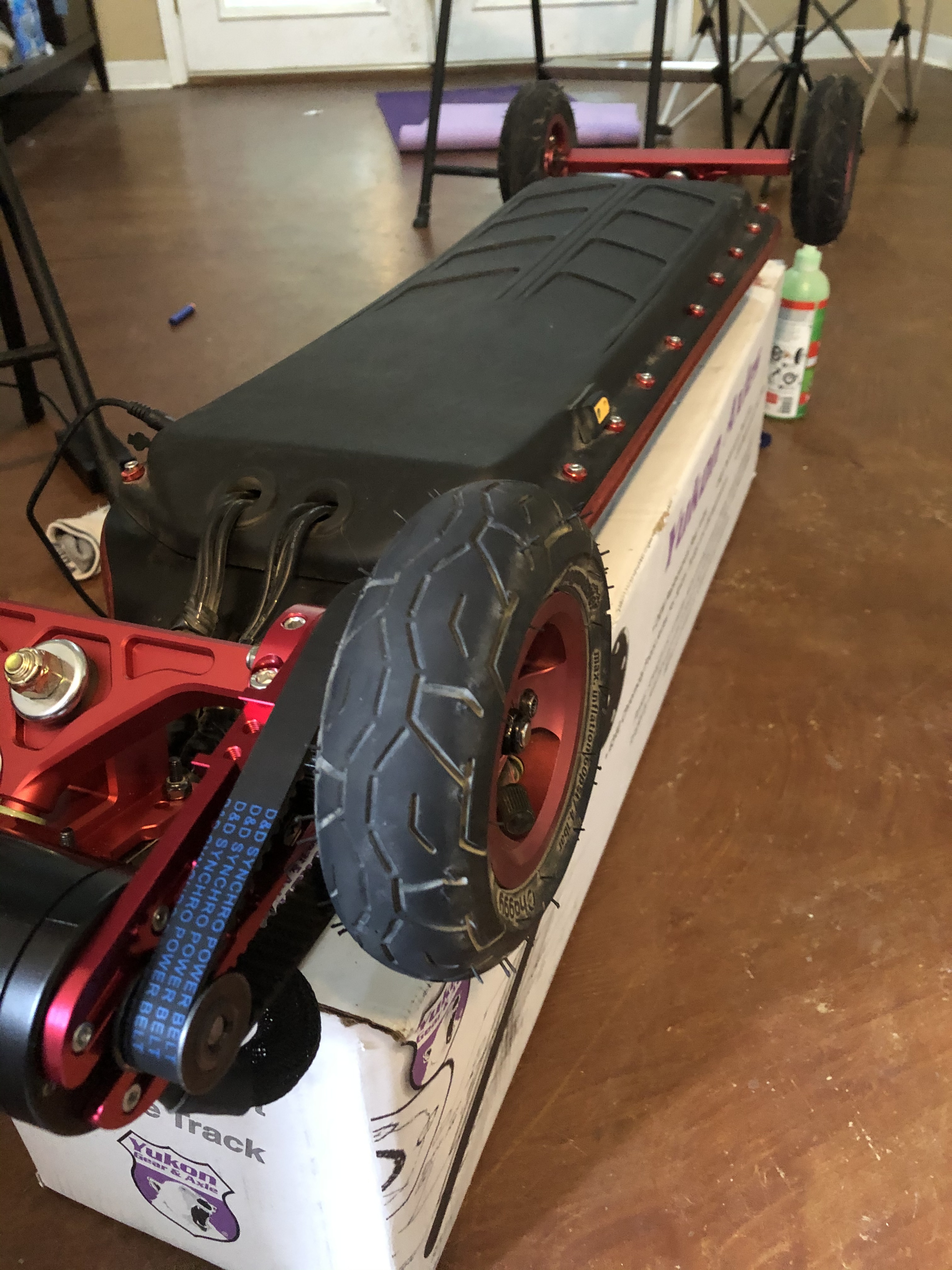

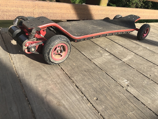

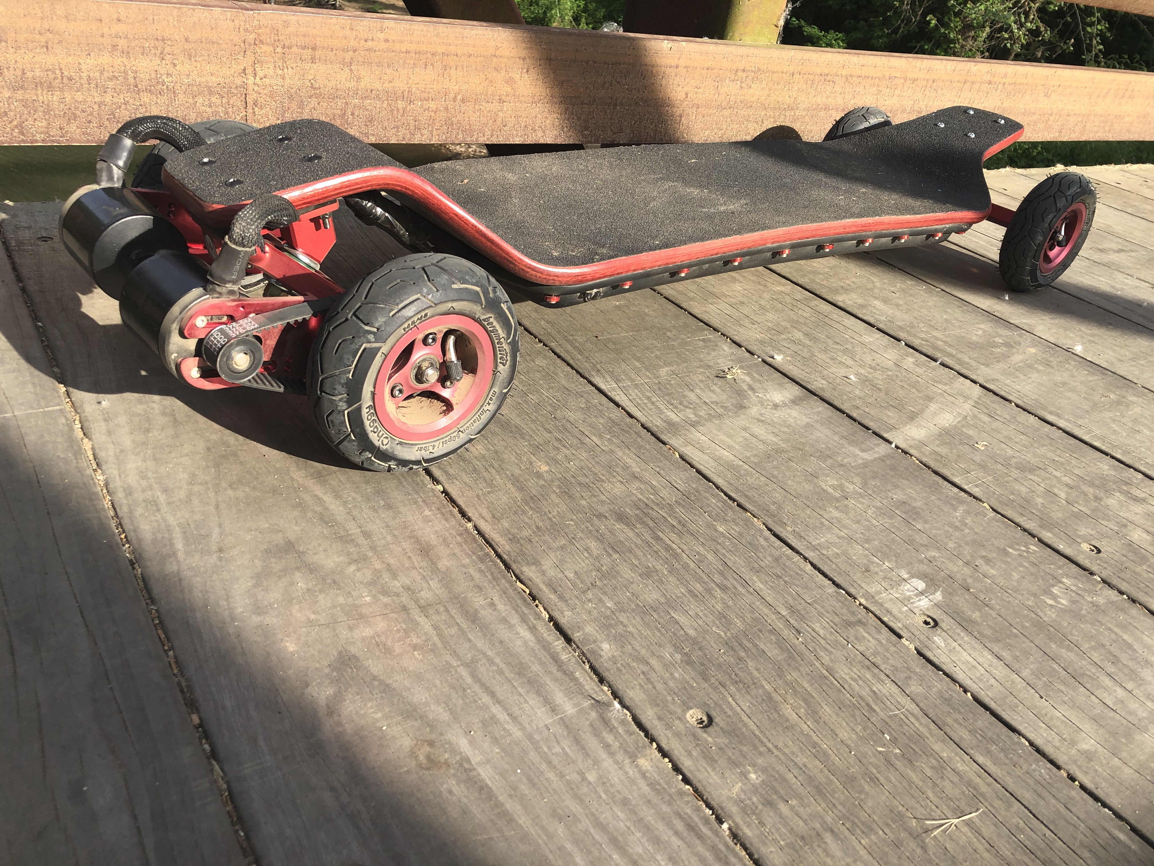

Update time. I’ve had to rename the board to Lazy Lightning. A nod to my obsession with The Grateful Dead. Both kids and all four pets bear a name inspired by the boys. The lyrics are pretty spot on for a rip on an esk8.

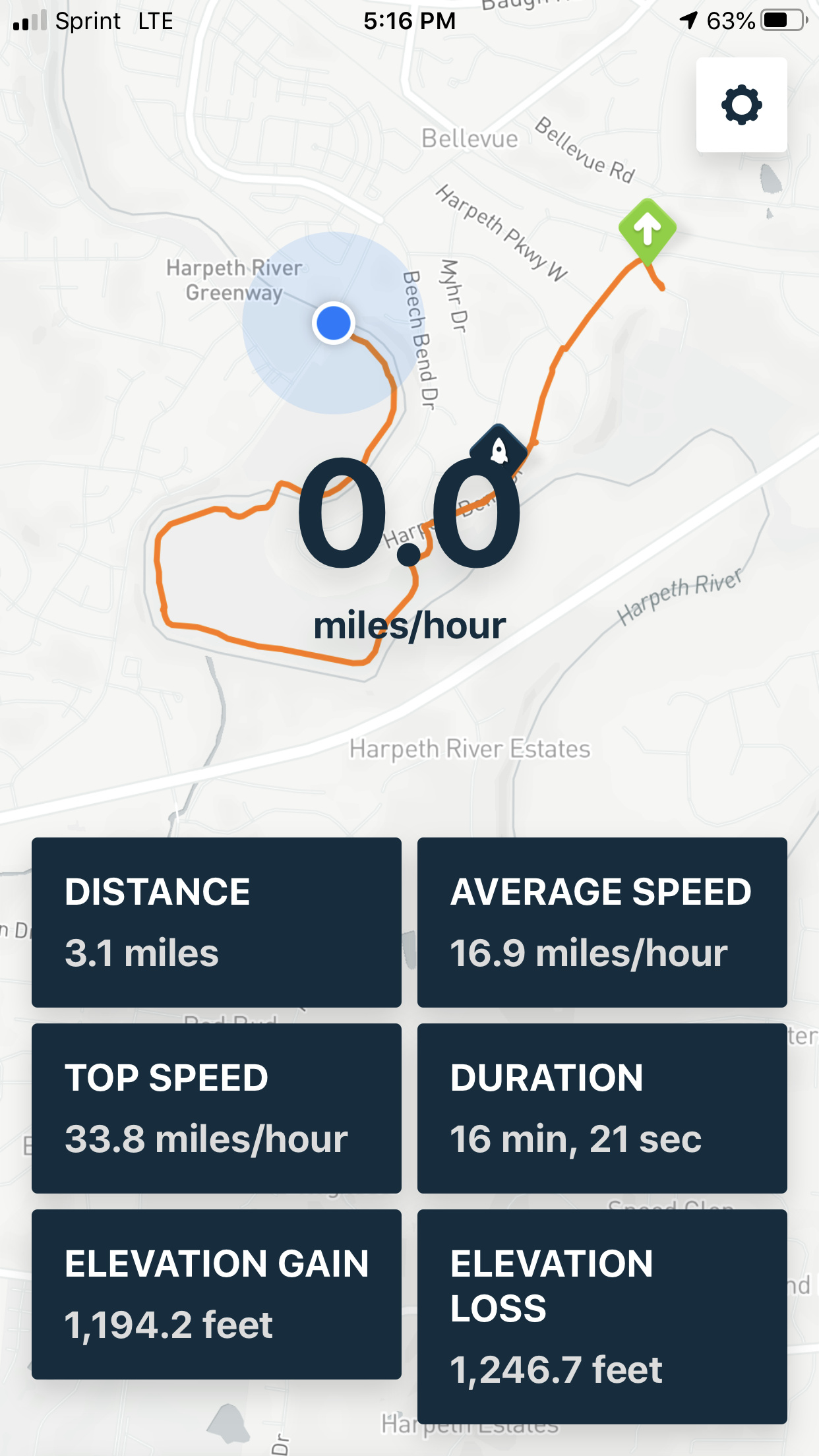

Four rides and 70-80 miles in and I’ve made some changes. Swapped out the Boardnamics hangers in lieu of the Torqueboard CNC hangers and motor mounts. Installation was a breeze and getting everything aligned was smooth. Still need to work out slightly stiffer bushings as it starts to search over 30mph. To date, I’ve only taken it up to the speed below, but still learning. I’m keeping as much weight as I can on the front end but still gets awfully sketchy.
I’ve only taken the battery down to 40.7V and that ride was 18 miles and 3300ft of elevation gain/loss. Should have no issue doing 20+ miles on a charge.
Planning on racing the community for the stormcore 60D when the time comes. Otherwise, going to keep blasting this MFer.
That looks so dope!!! Title fixed

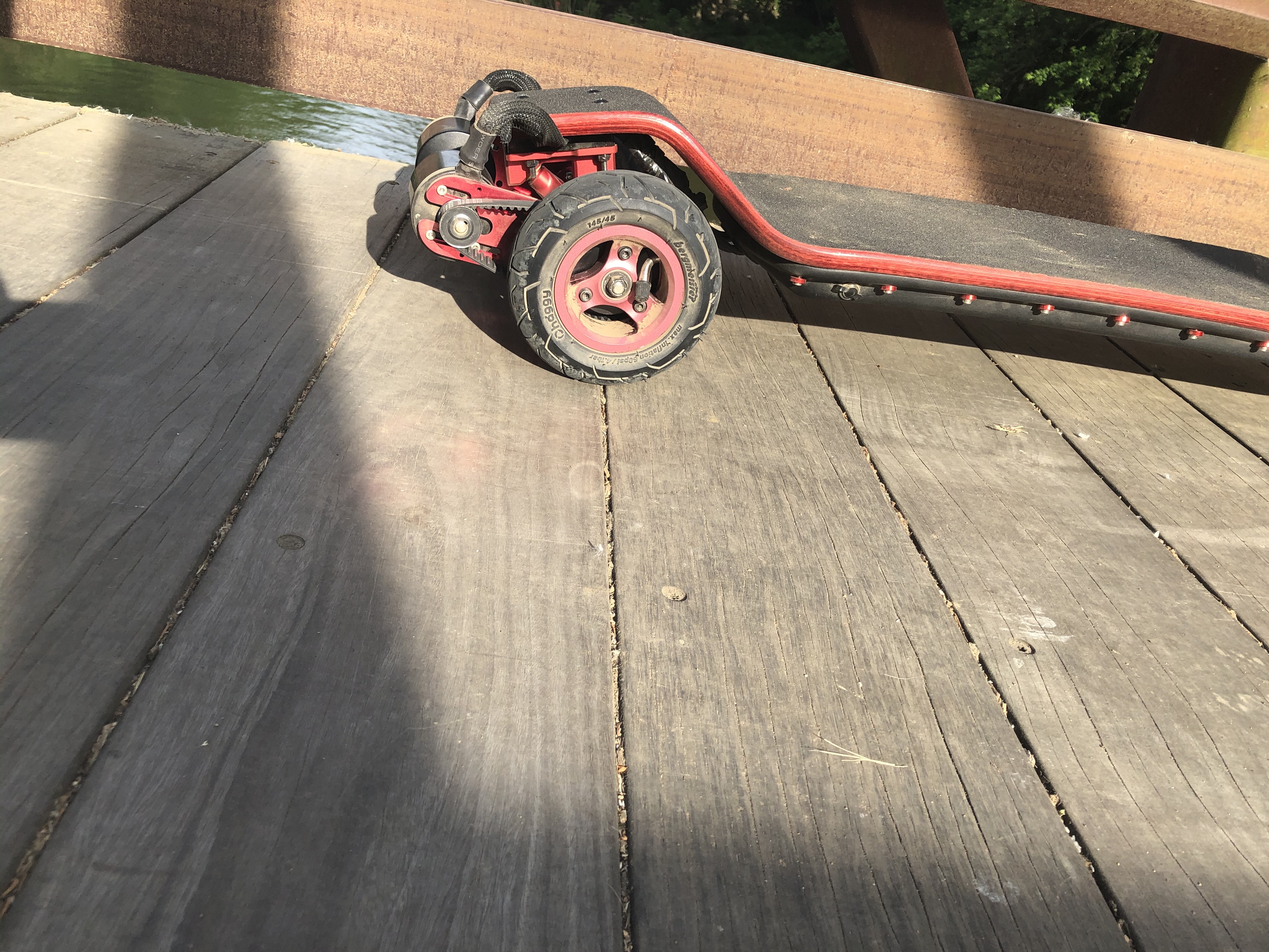

Based on advice from Brad at Rip Tide I swapped the front bushing cups for flat washers and noticed increased a surprising amount of maneuverability. The green 93a’s that came stock seem to be fine for even my weight.
Not sure if it’s the @torqueboards trucks or @RipTideSports bushings on the Century from @Bradley, but this thing is crazy stable for a beginner. To be able to consistently cruise at high 20s with bursts into the 30s says a lot for this set up. I’m a total newb on boards but now totally obsessed.
One last shout out to @Skyart for getting me set in the right direction with the hobby.
