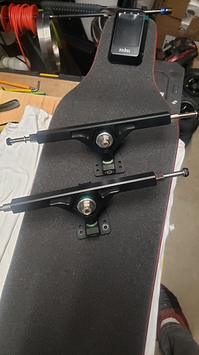

Starting a new build. This will be a very different build for me, mostly because I am not trying to cram as many batteries into a build as possible, this is going to be more on the lighter side. Because of the aggressive drop on the Century 40, a single stack enclosure is pretty much the only possible enclosure for it. Board will ride very low and very stable. Have not decided on the drivetrain yet. I have a nano drive and some 150kv motors that I think will be great on this build. The 3Dservisas nano drive comes with a 1:2.6 gear ratio. In my opinion the lower 150 kg motors with bergs and 6×2s will deliver a good balance or torgue and speed. Just started on this, so there is not much to report. Will update as the build progresses.
Thank you for reading!

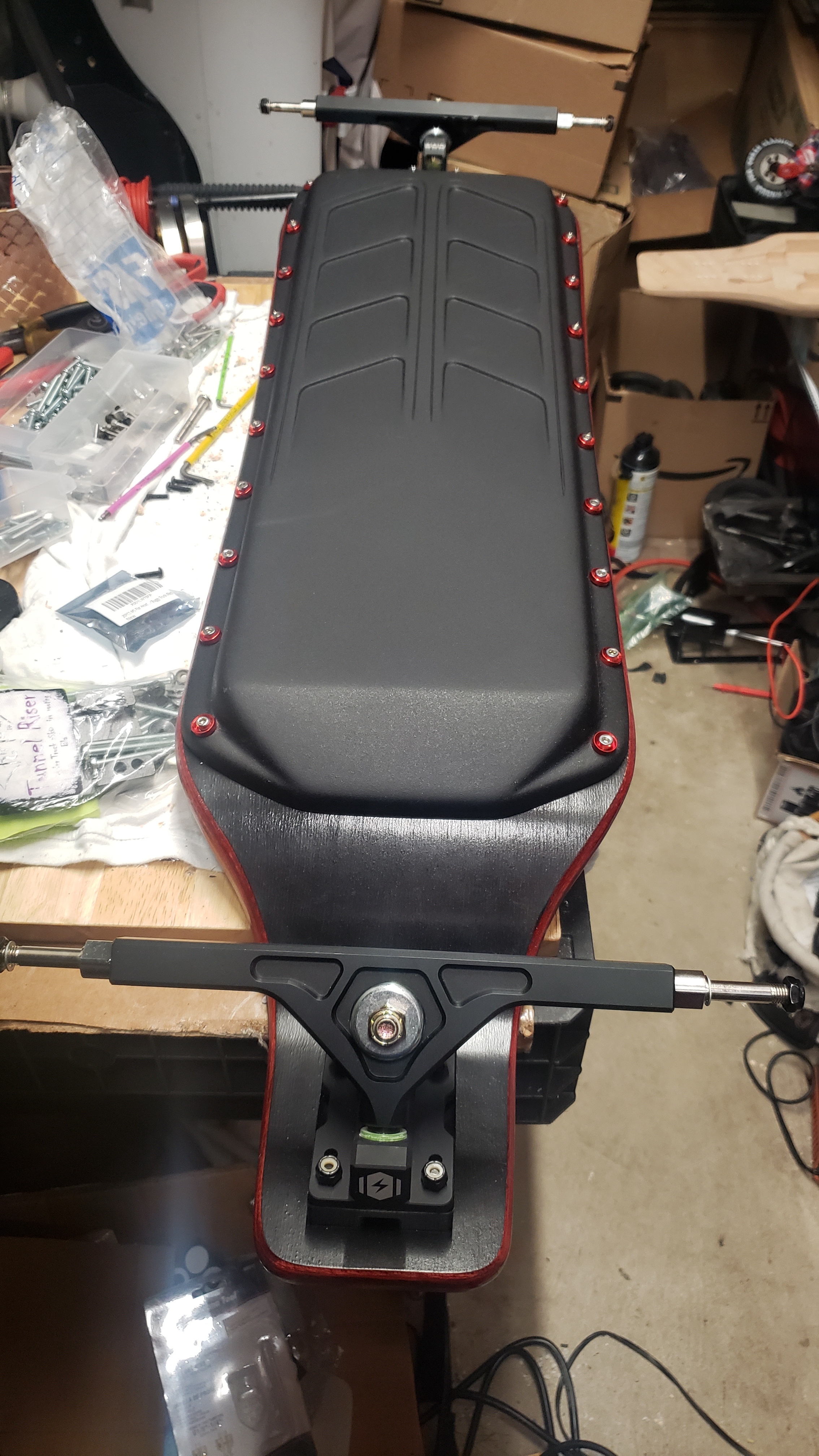

Enclosure is mounted!
When it’s done right, it’s almost psychedelic
Very nice :grimacing::grimacing:
I was worried about drilling 20 holes lol, seems overkill to me, but the enclosure came with 20 perfectly spaced sharpie marks on it!! Lol! I think alan went the extra mile on this one :rofl::rofl:

I just feel really bad for you when you have to unscrew the enclosure cause you forgot your hex key inside
Have fun x20

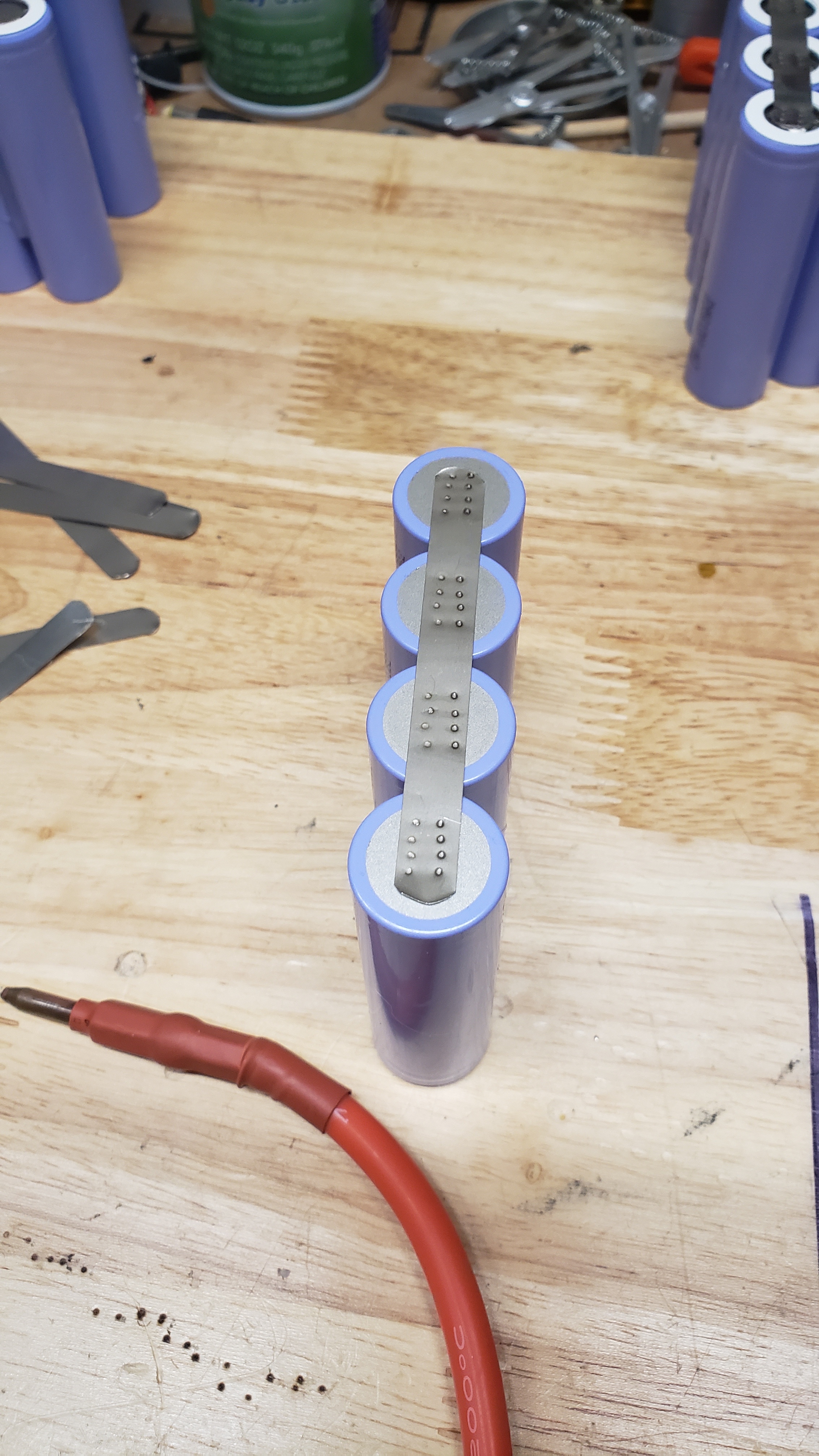

Battery starting to come together! Working on pgroups right now. Will be a 12s4p 40T battery :partying_face:

P groups done!

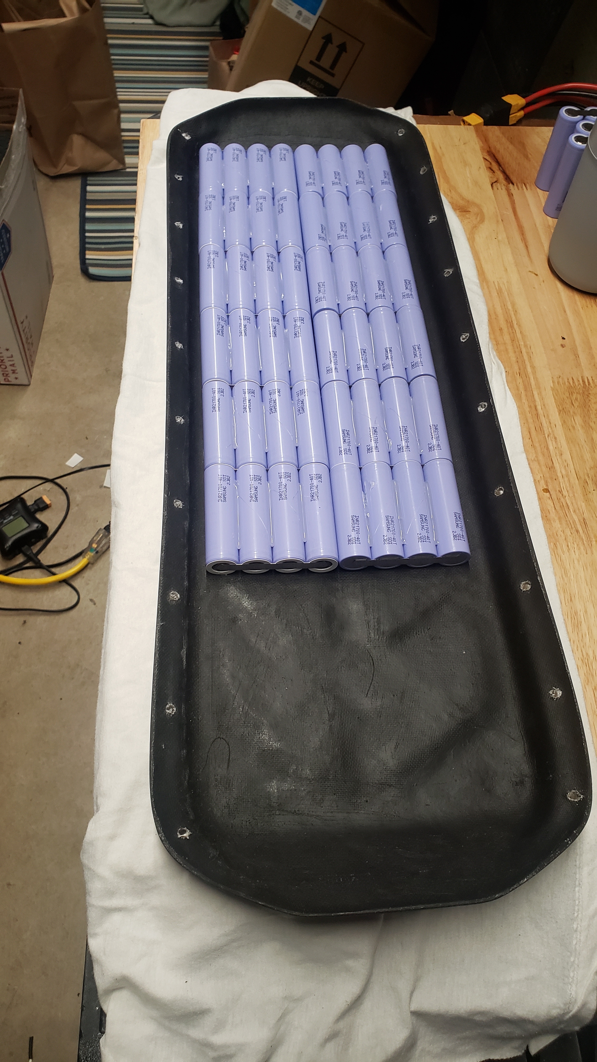

I am thinking thai is the battery layout that’s best for this enclosure, makes maximum use of space, pack will need to have some flex
plenty of room for 14p!
