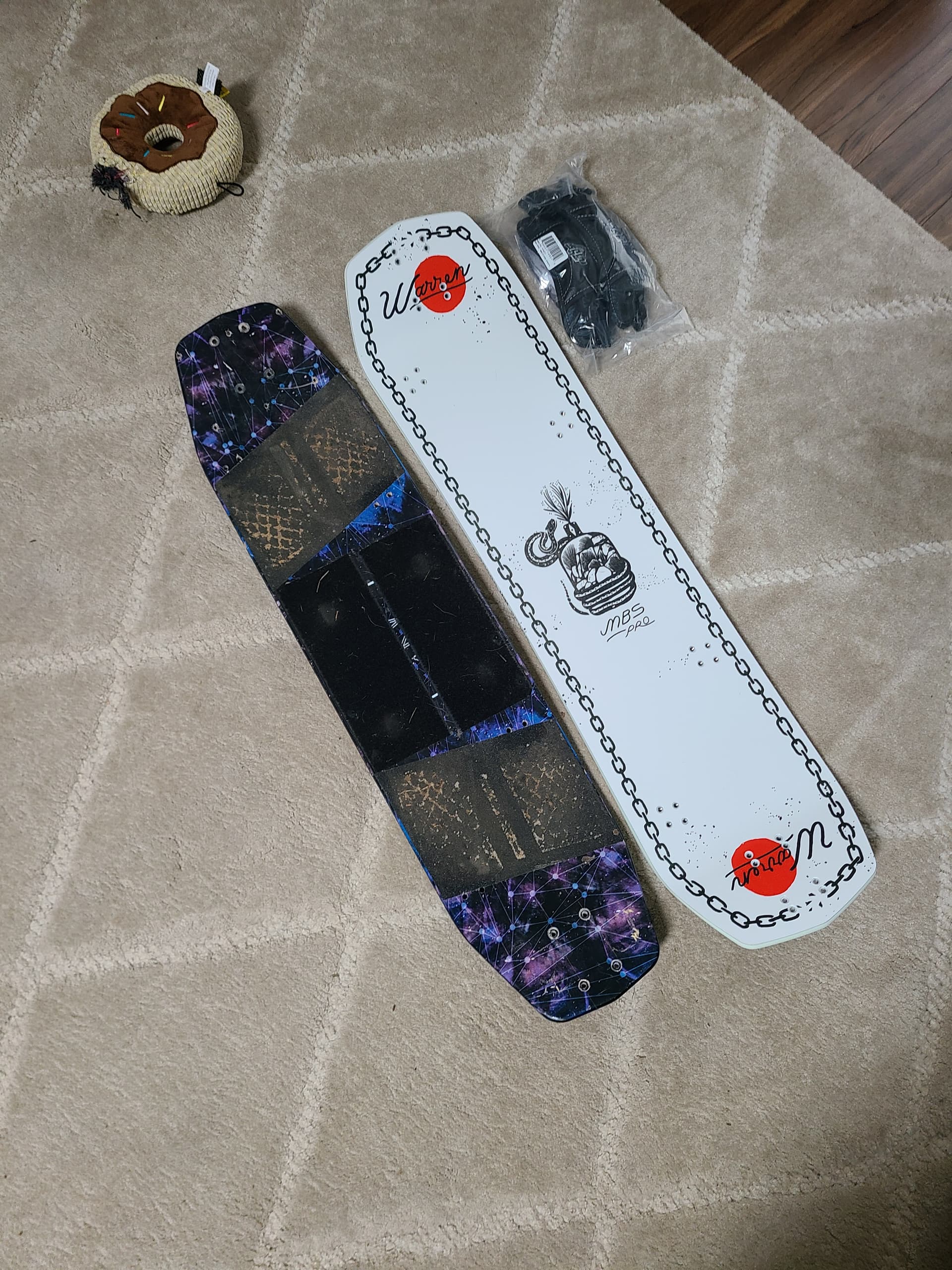

My first diy board is now my first trash deck after an incident over the weekend that cracked the deck.
The old deck is stripped and pretty much everything is going back on a new deck.
New:
MBS Dw pro 3 deck
Heel straps
gotchiPro beta
3mm riser pads
Re-using:
Mbs bindings
Petg pass thru foot pads
Matrix 3’s (minus the risers)
7° front wedge
Apex jump drives and motors
Five stars rims and 9" tires with anti puncture liners
Stormcore 60d+
Peli 1200 12s6p p42a

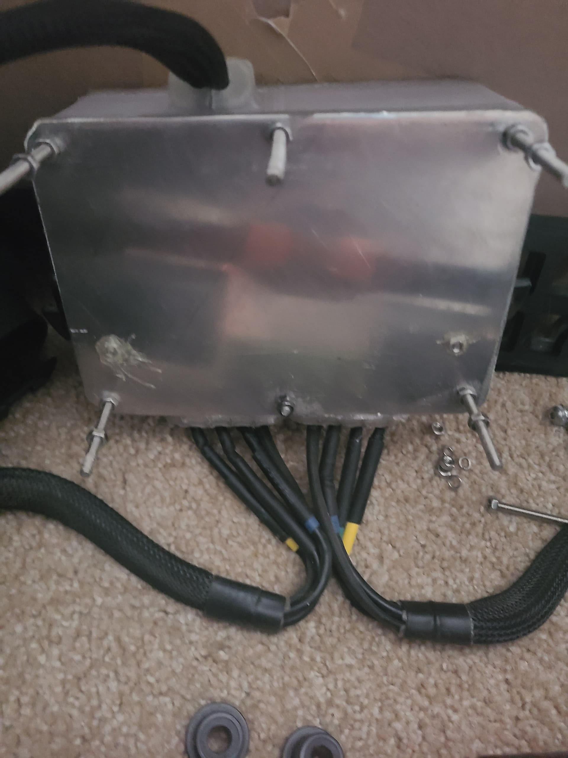

I’m redesigning my esc enclosure situation, to incorporate the gotchi:
Using the original aluminum plate to heat sink the esc and same tpu gaskets.
I’ll print lower profile case walls.

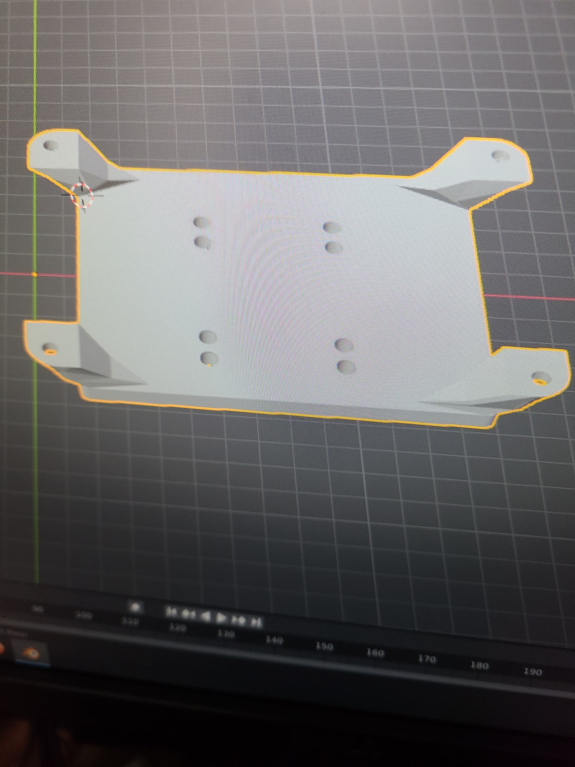

A new cleaner mounting design/anti-sink plate combo.
A new removable lid design that has a combination of petg and tpu to house the gotchi where buttons can be pushed and screen viewed without opening the case or undermining water resistance.

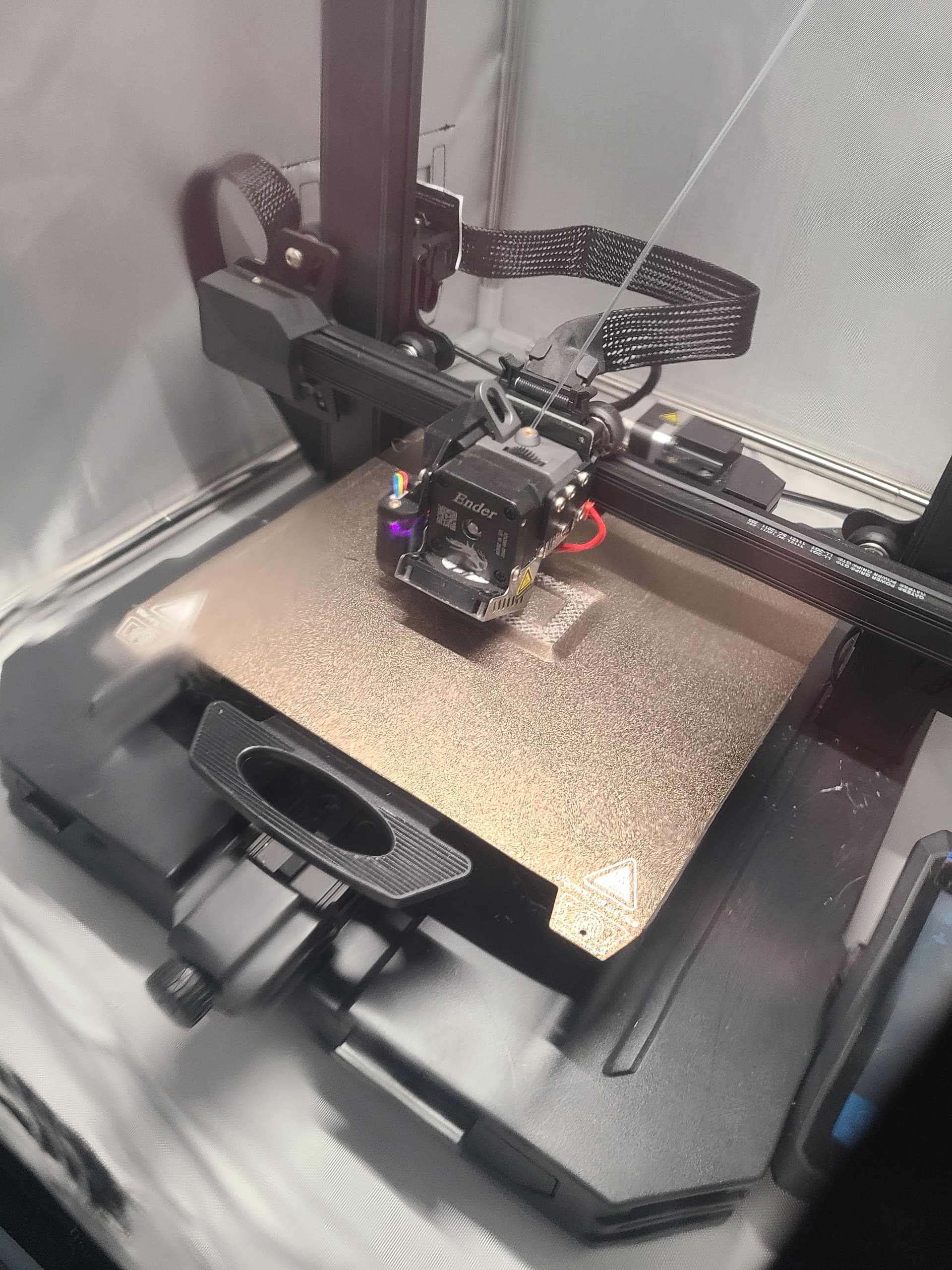

But, first new parts need to arrive and I need to build a printer enclosure so my prints come out cleaner. Lot of irons in the fire now. House projects. Camp trailer build. So, here goes one more.

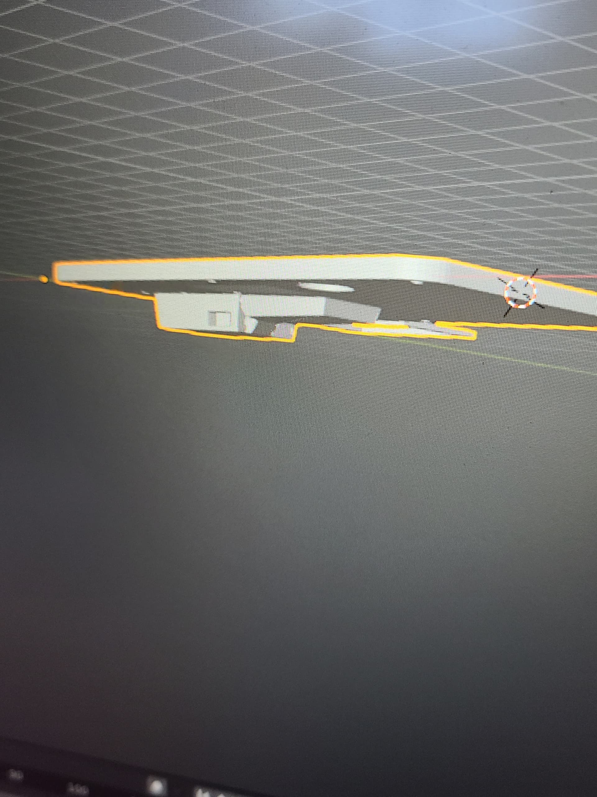

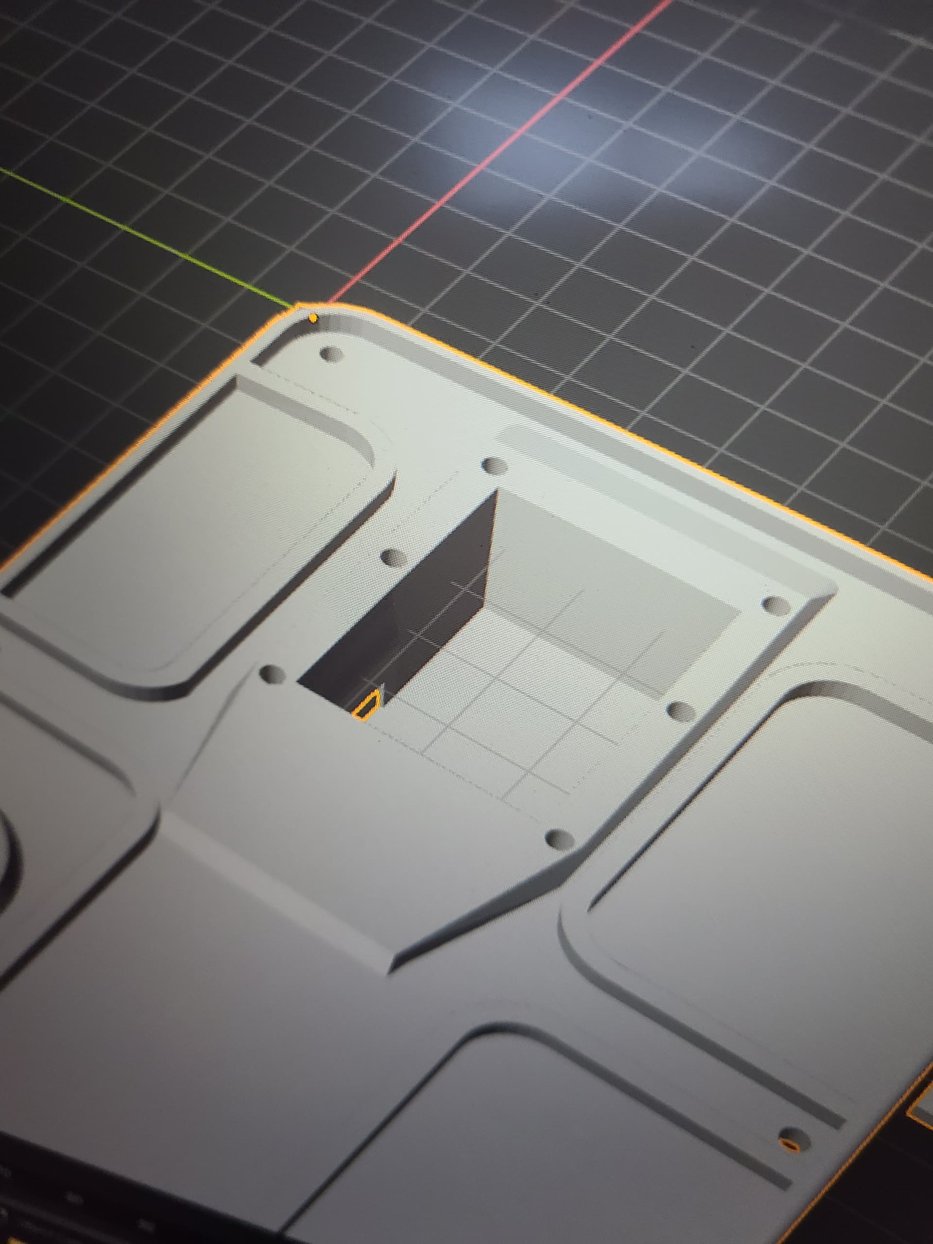

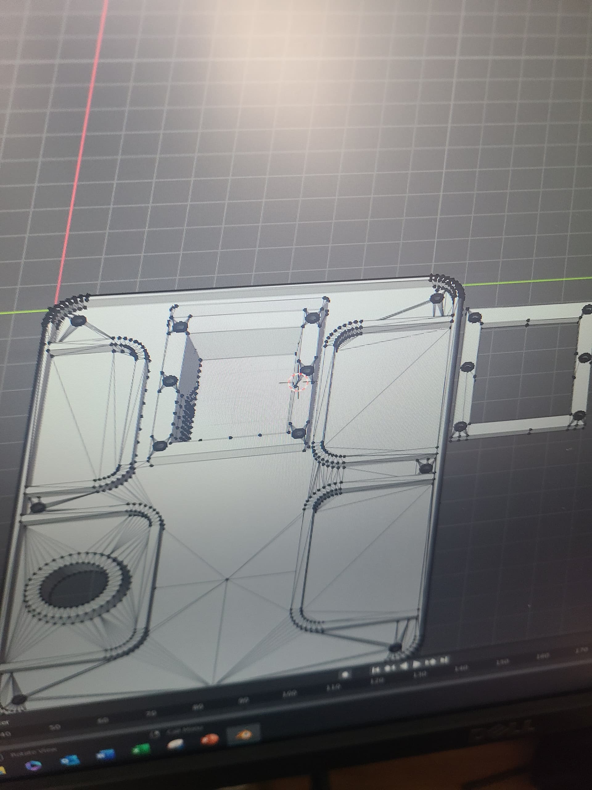

Work in progress on the case lid. I want to be able to more easily accesss things than on my first case version so I’m debating cavities for nuts to be placed into and sealed into the print. I may or may not go that route still but, the gasket sandwich will use hex cap bolts.
Ideally the gotchi will sit below the case walls within the lid. The display (need it in hand to determine) could be flush with the top of the lid if with smaller sidewalled box. With maybe 1mm clearance to the stormcore. ± some gasket compression. This would protect from impacts.
Depending on if the gps chip is cased or not will determine how I am mounting it and creation of wire channels within the lid.
In the photo on the DRI web page it looks like the display may have buttons side mounted.
Probably can’t do much more with the designing now until I have the new gotchi in hand or detailed measurements
I do need to figure out how to adapt my heat sink/base plate to the new board though.

I’ll probably be making some kind of adapter to go between the board and the threaded rods of my box. There’s extra holes in the new deck that won’t be used. Ill have to wait for it to get here to plan something out. As for the extra threaded rod, yes, those get the dremel when I trim to fit.

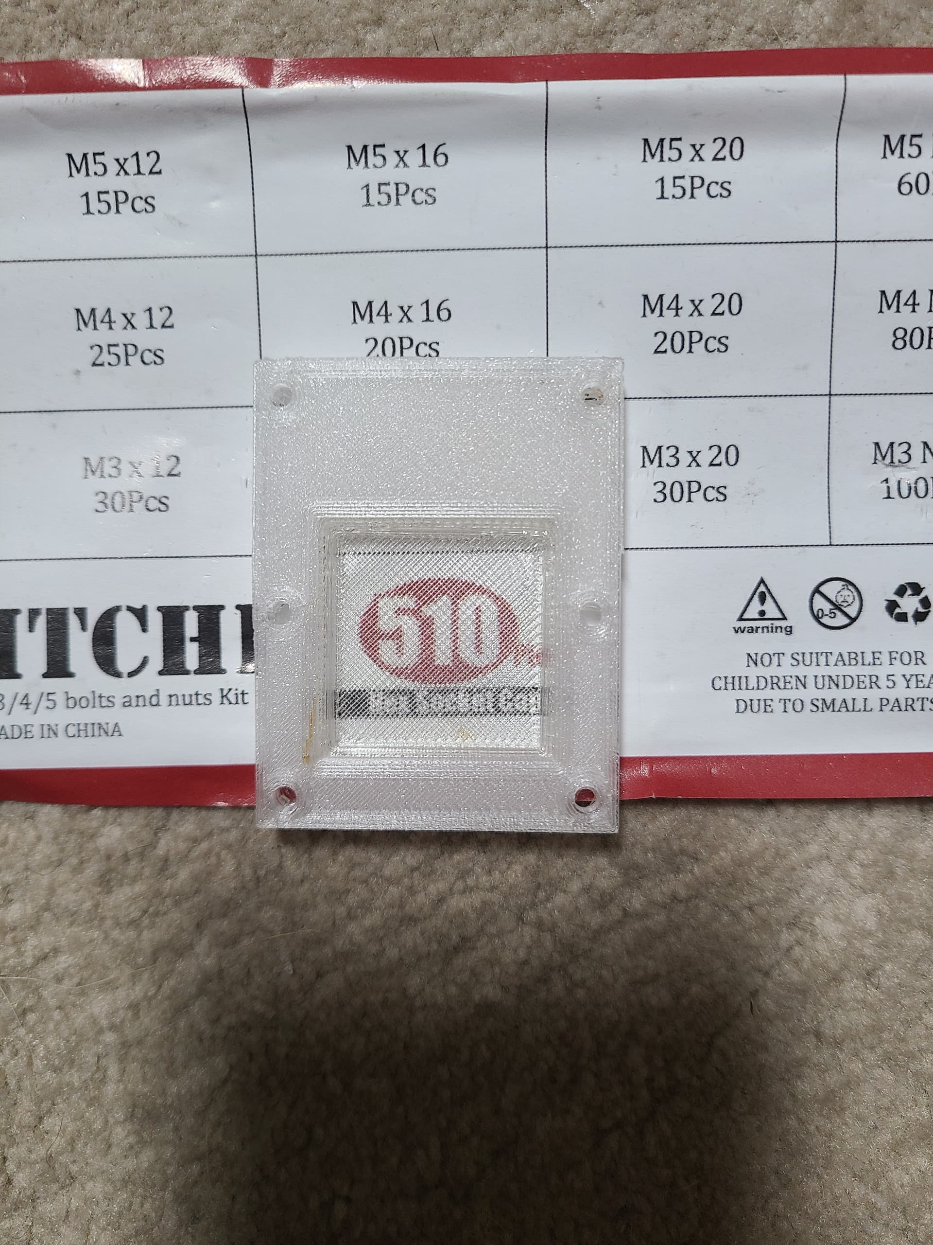

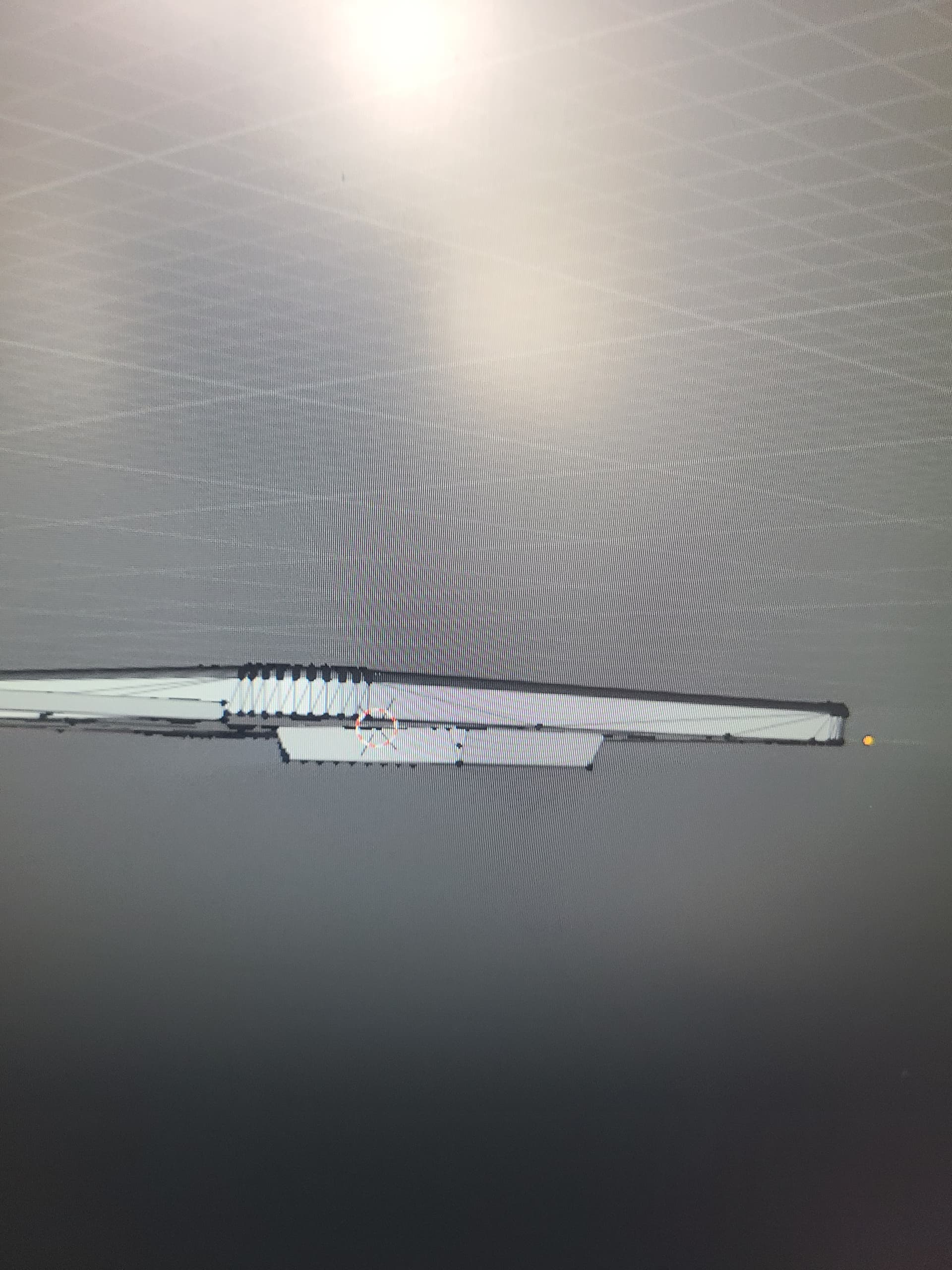

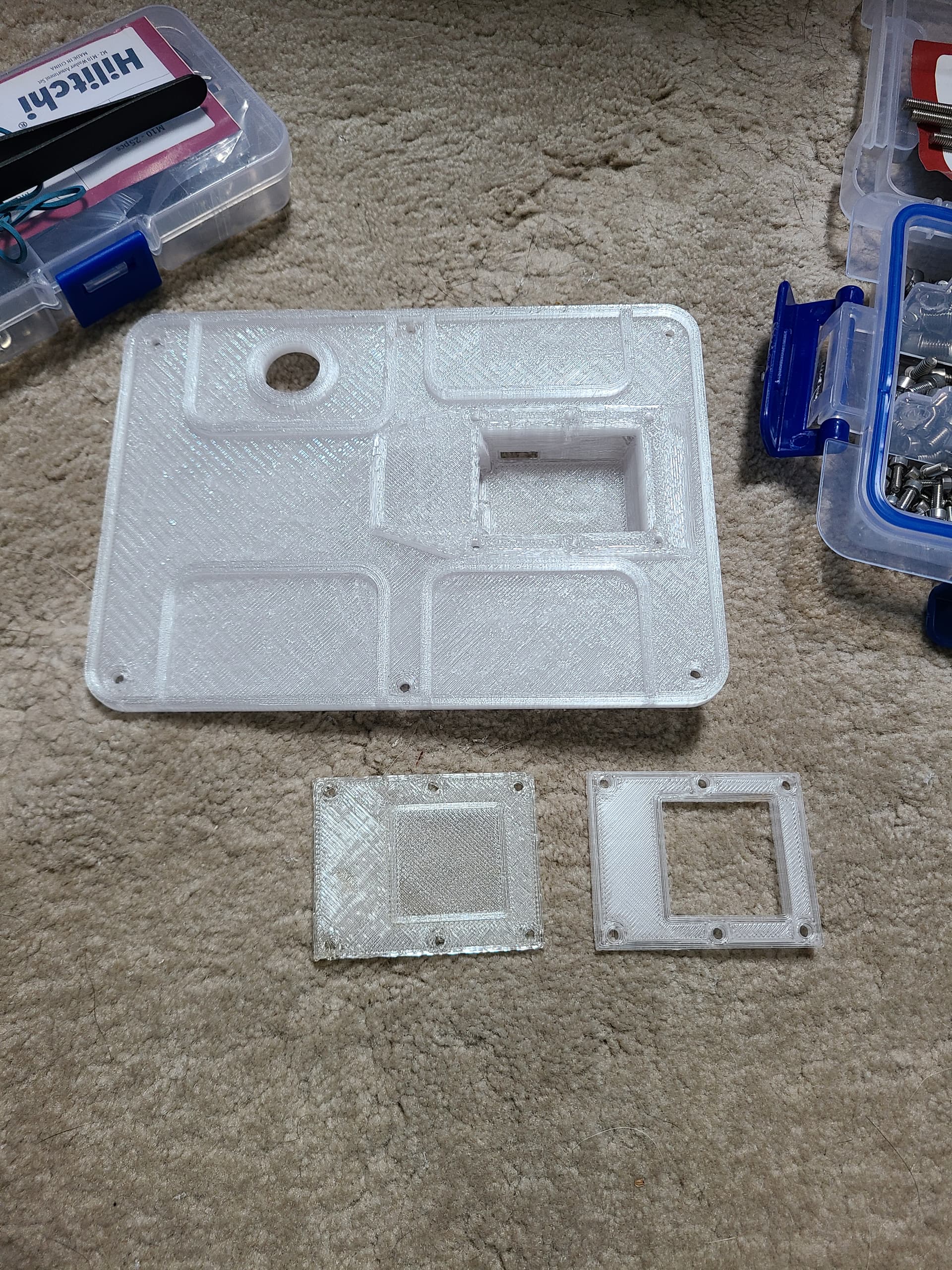

More progress in the lid design today. The gps should fit snugly in front of/next to the gotchipro
Tpu gasket prototyping with supports.
It should work. May need to test treatments for the tpu. The question really is will the light emitted from the display scatter in the tpu even if its so close there’s contact.
Used my calipers and a few images off the site with calipers showing sizing to estimate photo scale. Converted screen measurements to real life with the scale percentage. Once batch 2 ships it should fit right in . Worst case I re-print after taking physical measurements.
What about buying a sheet of petg or acrylic, cutting to fit the window, and gluing it into the 3DP lid?
It would work for clarity but I think the 5x5 led display is also a button. So the flexible translucent tpu should be the ticket.
I want to keep it so I don’t have to open it up unless something is really sideways.
If this idea doesnt pan out, once I get a gotchiPro in hand I’ll rework my design. Takes me a couple hours to redesign/build something with proper measurements to print. And I have the printer and filament, so it’s convenient. I could come up with something that incorporates a clear panel that fits inside of the display size and gets printed into some sort into a gasket which would allow clicking but, since its not like a display screen its a 5x5 led thing… I don’t think, as of right now, that would be needed but, well see.

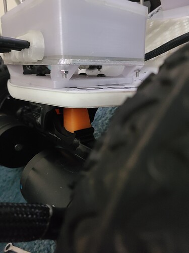

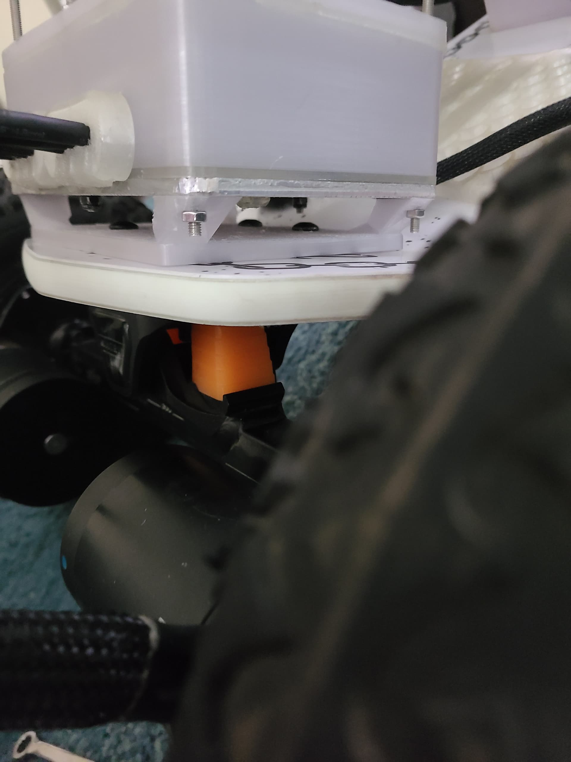

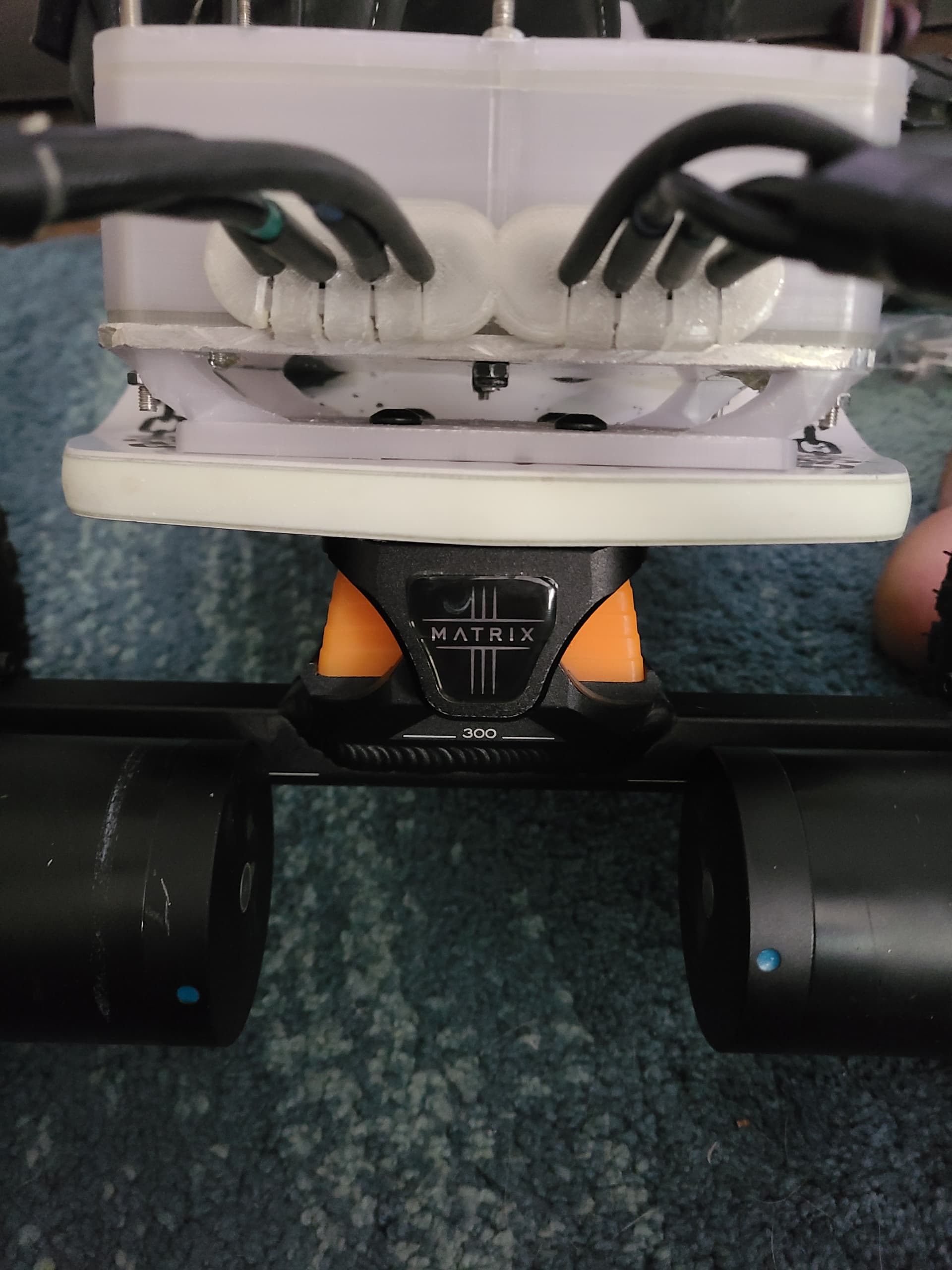

New deck arrived.
Its different, thicker, longer, less of a bend, steeper tip angles.
May work to hold the esc box on the deck. Tbd.

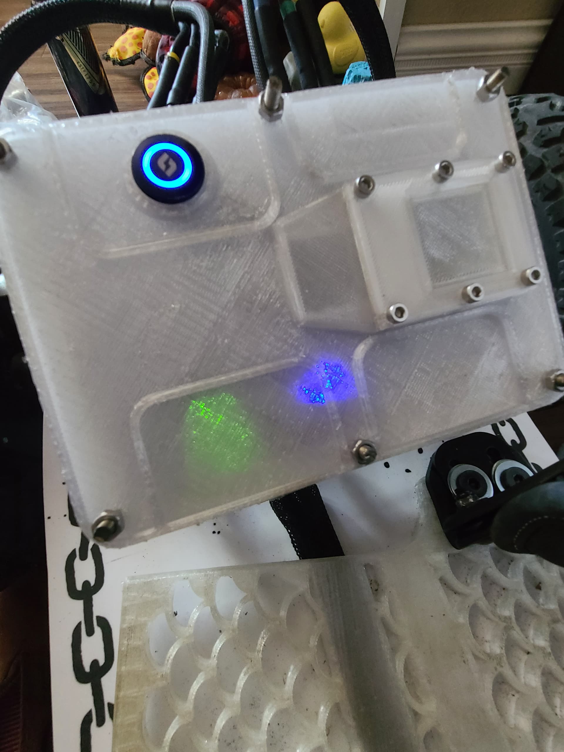

Only potential issue is that in a crash I forsee the base under the angled risers cracking or detaching close to where the risers make contact. The case is secure and rattle free but it moves ever so slightly if lifted/pressure applied to the case.
More testing needed to see if under trail ride conditions it holds up. Pending antisink plate I ordered and replacement TNuts for the base plate from MBS for the ones that were damaged in the original failure.

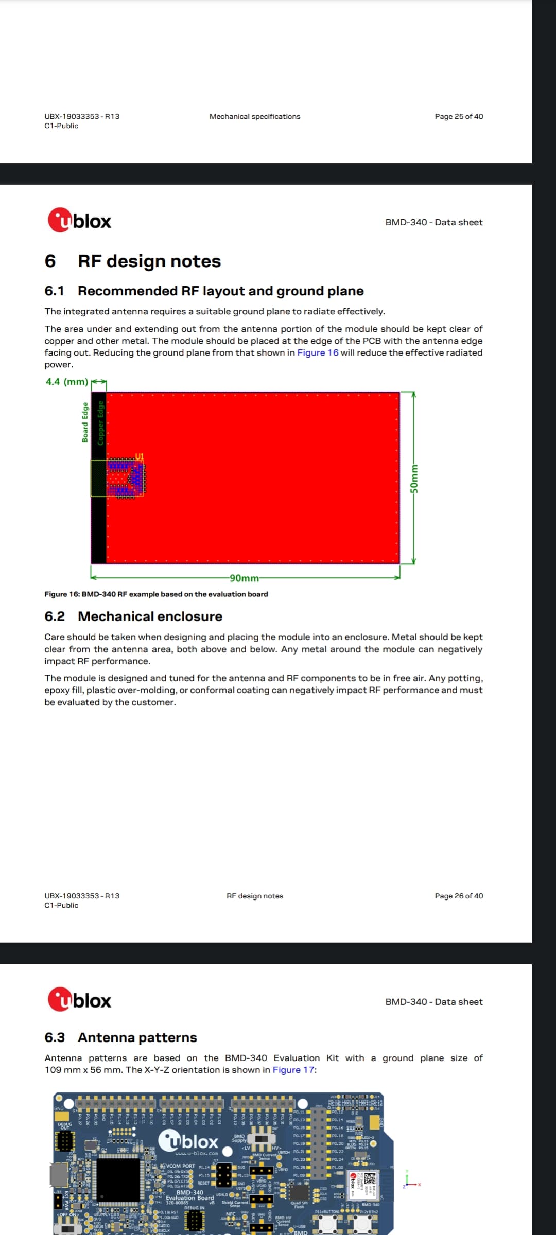

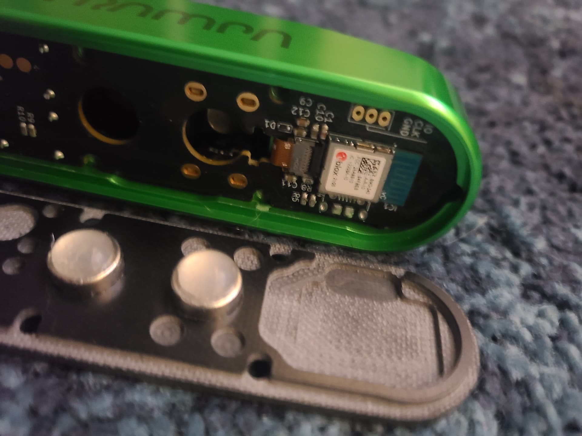

This thicker lid version is too thick for my Stormcore to reliably recieve the signal from my trampa wand. (Likely the wand is really more of a problem with it’s known weak signal issues)
Testing yesterday revealed cutouts where last signal input was continued when my body was between it and the box at normal riding position. The thicker lid also had to be tightened tighter to the box and the nuts have started pulling through.
When the signal dropped or was blocked/recieved interference. Throttle changes did not respond until line of sight from the box to the wand was established during these incidents.
Today was the same story after thinning out the lid again. Better than yesterday but, definitively if my chest is between the wand and stormcore it loses connection and continues whatever last input was. The angle the wand is held at matters too. If the bottom plate or screen is facing the reciever in the vesc it is better than if the aluminum/side is aligned.
Makes sence since the ble chip in the wand is on the bottom in a depression in the carbon fiber looking base plate and at that angle the maximum amount of material to pass through is present…
What I dont understand is why I haven’t noticed this before while riding on the board…i have been drinking less lately :sweat_smile: maybe thats disrupting my signal…
Will be interesting once the gotchi electronics are in, what kind of effect those have.
As a last resort I’ll try printing a petg cover to go on the wand in place of the aluminum cover. If anyone has a 3d object file already that would save me a couple days of building in blender.

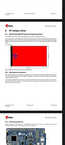

This is from the manufacturers (ublox) info sheet for the BMD340 ble chip in the wand.
Definately has metal within that spacing.
