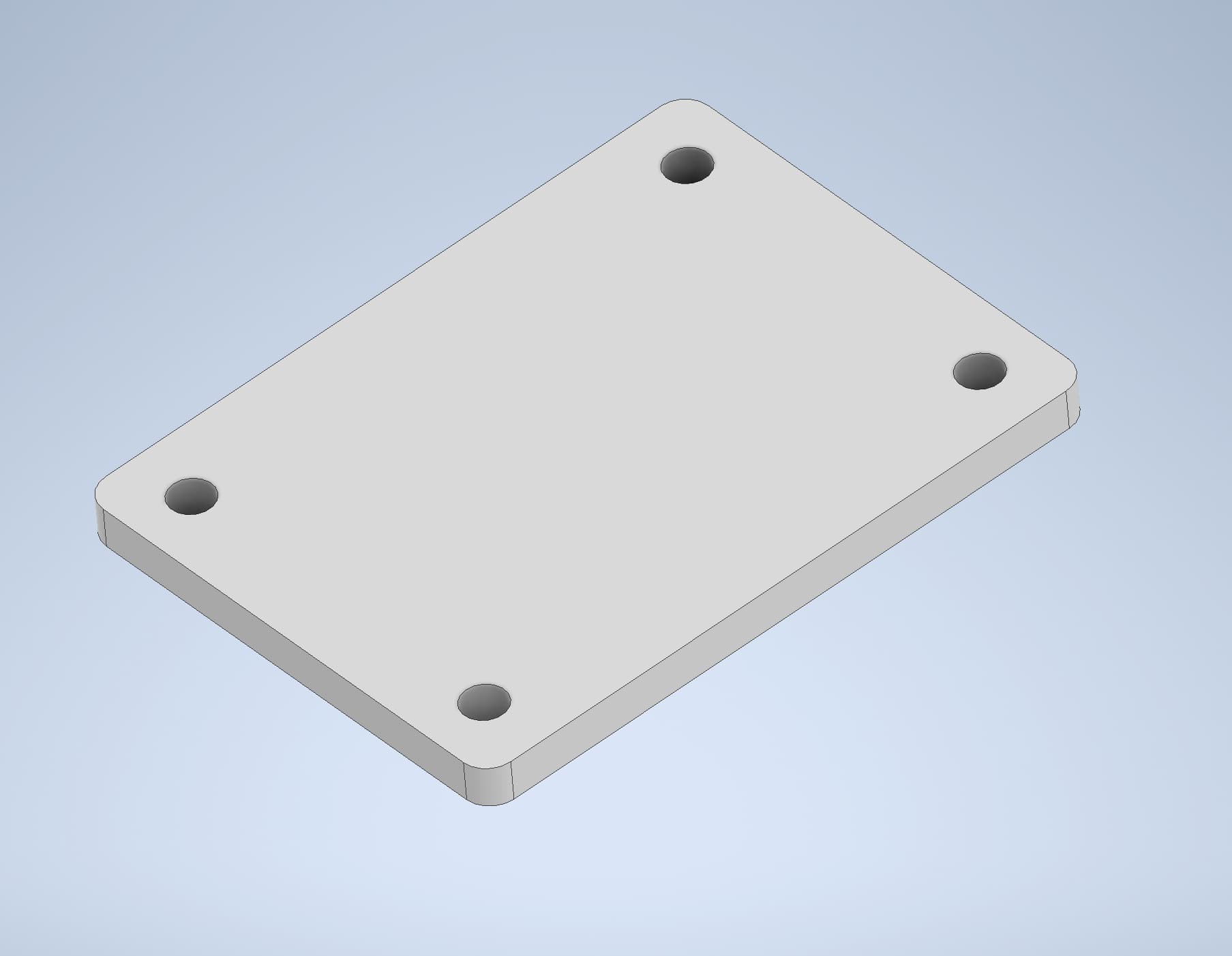

I’m making some aluminum top mount plates (similar to the ones offered by torqueboards), but with better material and quality. I’m having them lasercut in 7075 aluminum, .190" thick, with only the new school mounting pattern, sized to fit inside of the area left inside of drop through carbon fiber decks when switching to top mounts, tighter tolerances, and without chamfered bolt holes to allow more bolt options. Was wondering if anyone wanted in on a few of them to save on part costs.
Full transparency here, these are just being made by sendcutsend, nothing special, I’m just trying to save a bit of money by ordering more than just 2. Price would probably be around $15-20 shipped for a set of two within the states. If there’s enough interest, i can also have them in a gloss black powdercoat for an extra buck or two.
Images below of the dimensions, and actual cost to me so you can see i’m not just ripping you off.

Just curious why you feel the need for 7075? 6061 is plenty strong for deck protectors
The cost difference is pretty negligible, and holding the 6061 torqueboards truck plates on my desk here, it scratches and marrs way too easily. If i could afford it, i’d be making these out of titanium as I like to go all out on my personal projects though haha (I’ve already spent way too much on titanium hardware).
You’re correct that in terms of purely strength, 6061 is more than adequate though. If there’s interest in dropping down to .187" 6061, i could probably do that for around $10-15/set?

So incase anyone wanted an update, these have been completed and fit to my own personal board - ive found some issues with the edge finish when lasercutting thicker aluminum, its a bit rough and requires a lot of manual sanding to polish the edges up to a standard im okay with, which is annoying. For thinner parts, its not an issue though. Pictures below!
(This part is almost 10mm thick for reference, so i think if i keep the parts around 6mm or under it should be okay, its only really thick parts that need a lot of hand finishing).
If theres any interest still, i can definitely start making a bulk order of these!
If you need softer edges, you should consider a supplier that offers a wider range of finishing options.
For example xometry.com will provide tumbling on sheet metal parts for ~ a dollar more depending on qty, material, etc.
