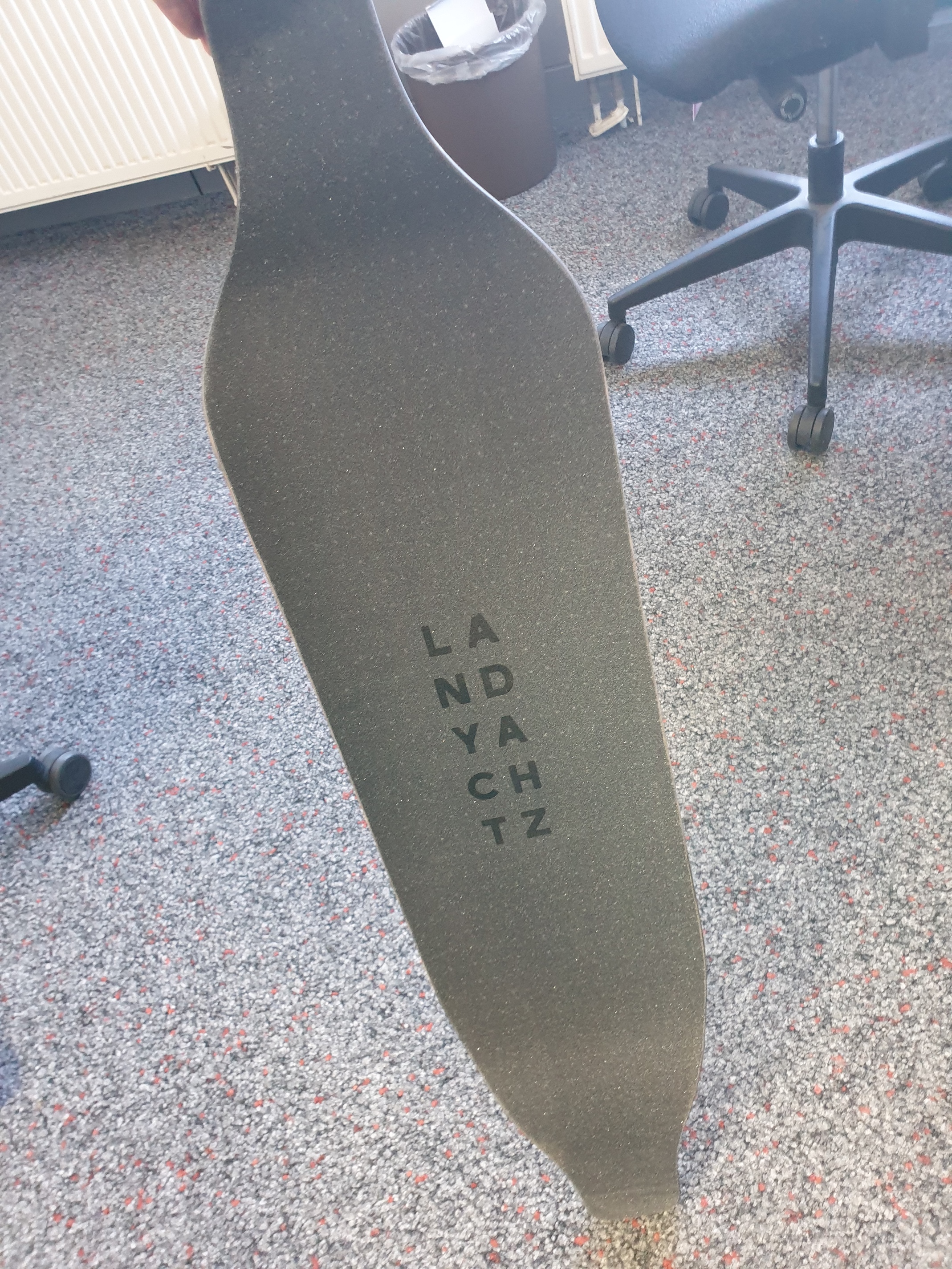

Hello everybody,
I am expecting my DirectDrives from Torqueboard to arrive next week. I’m currently driving an Enertion Raptor 2.1 but i’m going to slaughter my Raptor and keep only a few components (Unity, Battery, Remote Reciver, Battery LCD & Charging port) for a new DIY build.
  • The battery will be converted from 10s4p to 12s4p (BMS d140) by a user from the builders forum
  • The deck for this build will be the Landyachtz Evo 39" Skate and Explore (2018) with an enclosure from eboardsperu.com
  • The ESC will be the FocBox Unity
  • Wheels are the 97mm Lazyrolling Glows
  • Battery LCD indicator & Charging port I’d love to take over from the Raptor. Is this possible at 12s? What do I have to pay attention to?
I’ll probably need some more raisers and screws. Did I miss anything else?
Pictures will follow as soon as the reconstruction begins.:partying_face:

just arrived, so sexy
If someone from europe needs one
Next Part is here
Today, with the help of friends, we placed the enclosure on the deck.
First the enclosure was fixed to the deck with tape and marked with drilling marks.
Drilling with an angle so that the screw lies better on the angled edge of the enclosure.
Screwed into the drilled holes.
