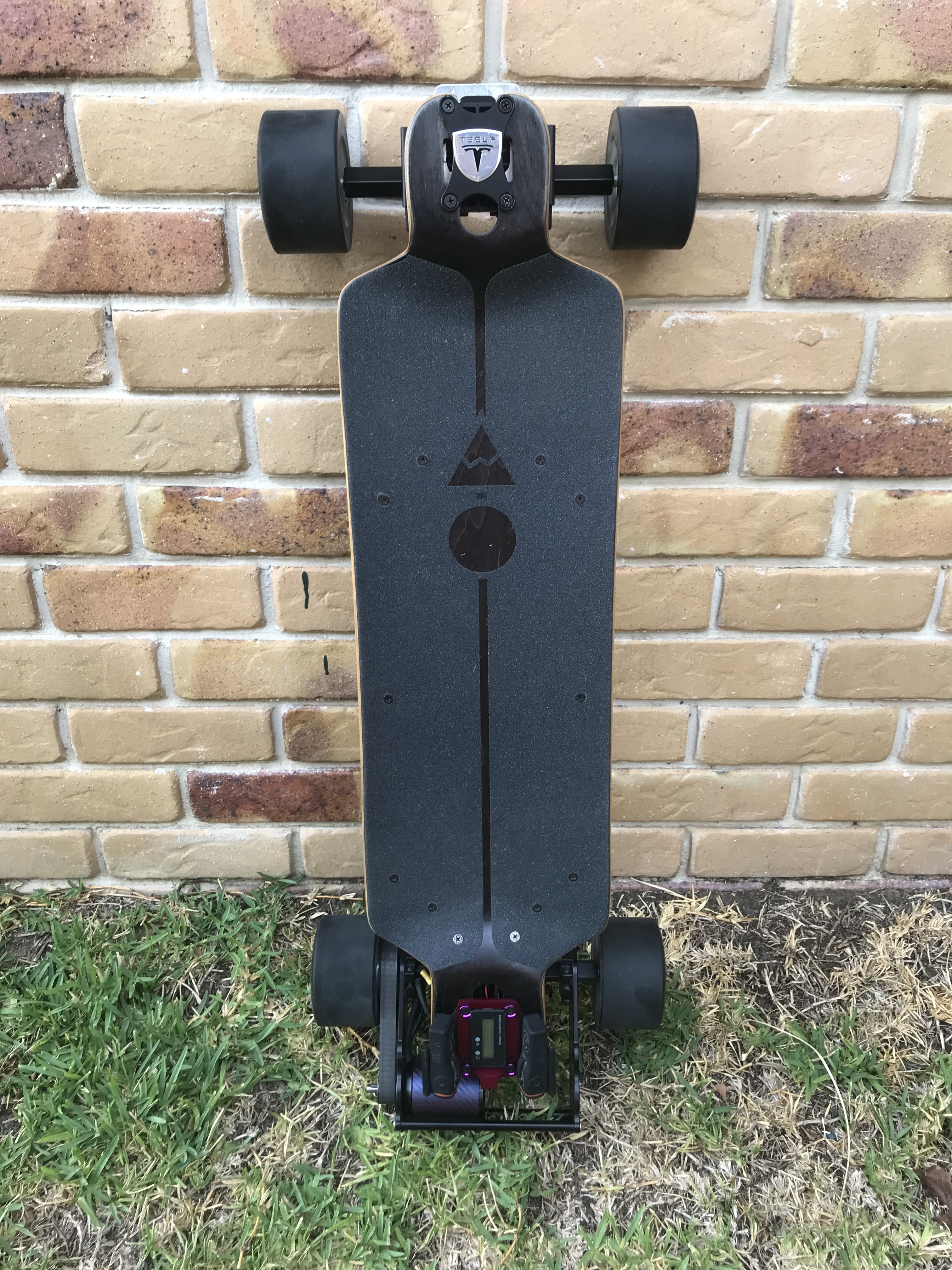

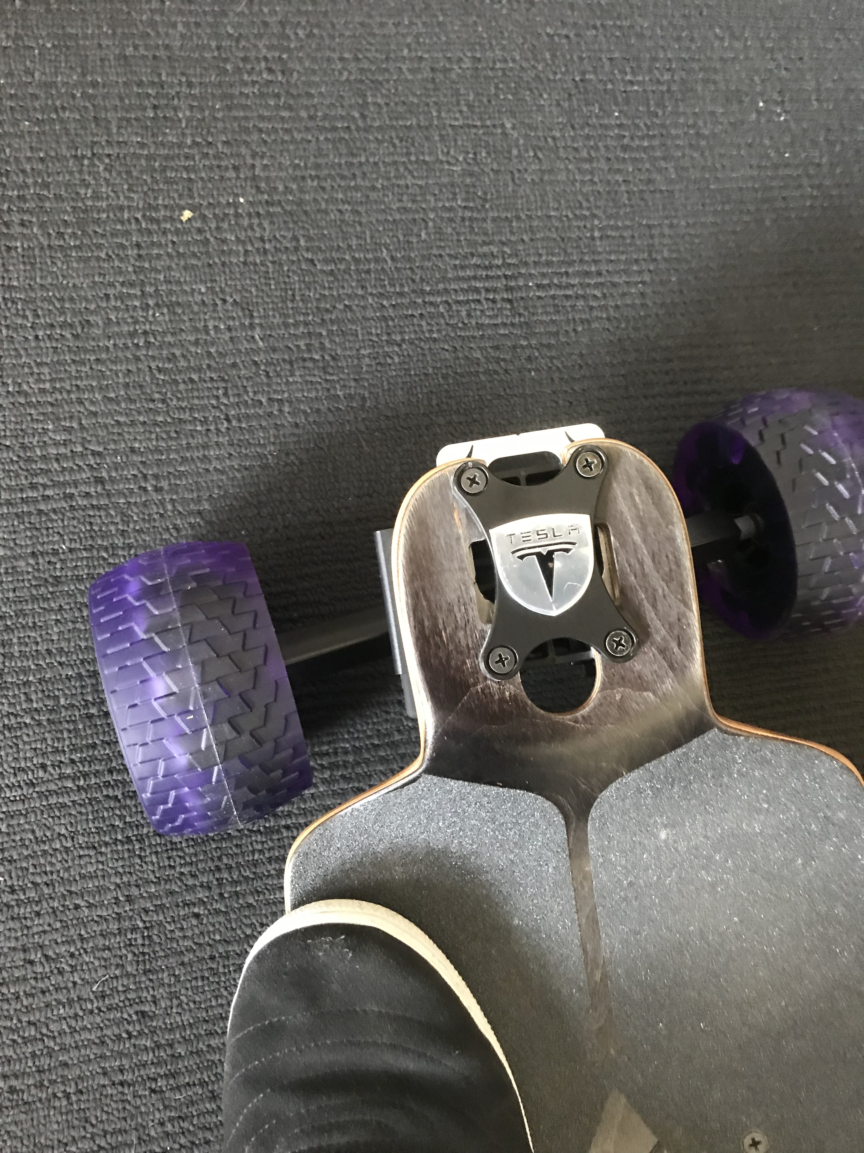

Getting close to finishing this build off, which is my first legit build, and i thought it was time to share. I haven’t seen a pantheon trip built into an esk8 as of yet, but the deck is pretty sweet. Its still too low though so will be moving to a different deck.
Parts list:
Pantheon trip 9ply > landyachtz 10two4
TB218
Abec 107’s soon to be foamies
12s2p 30q
FCESC mini 4.20
@torqueboards 6380 single (waiting on 2nd motor to arrive any day now)
@Janux-esk8 mounts
Flipsky vx1

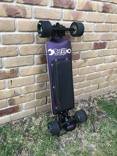

Mboards enclsoure that i had lying around and decided to reinforce with fibreglass on the inside (because abs sucks)
Still a bit to do, but its sweet right now. And yes thats a tesla badge :star_struck:

I just picked up the 31" version of the Pranayama Trip from muirskate for black Friday. If cracking is an issue then I may need to look into Carbon Fiber skinning the underside since I was also planning on DKP.
Looks like a single stack enclosure is ideal too based on the ground clearance that’s even more minimal than I though it would be, but that’s the double drop life I guess. How often are you scraping with how it’s setup now?
The ground clearance is about 3-5 cm on 90mm on dropthrough, i can measure tomorrow if you want. Also the scraping is at full full lean when the road is not totally flat i think. If you top mount it maybe a single stack can work.

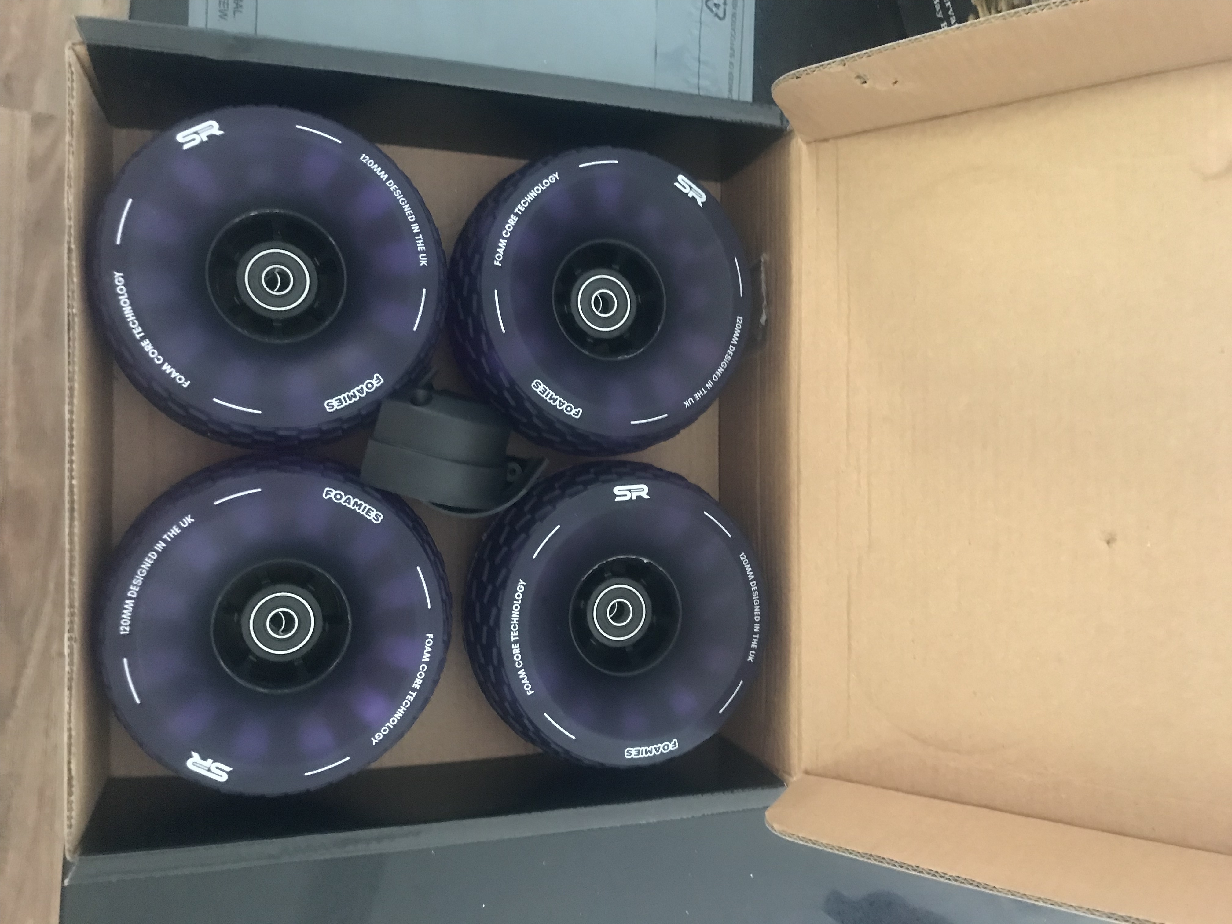

Using caliber baseplates you get wheel bite because of shortening the wheelbase, im usingthe tb baseplates and a 14mm riser and i have easy enough room for foamies at 120mm.

Wheels showed up, they dont feel too soft in hand but i have high hopes
