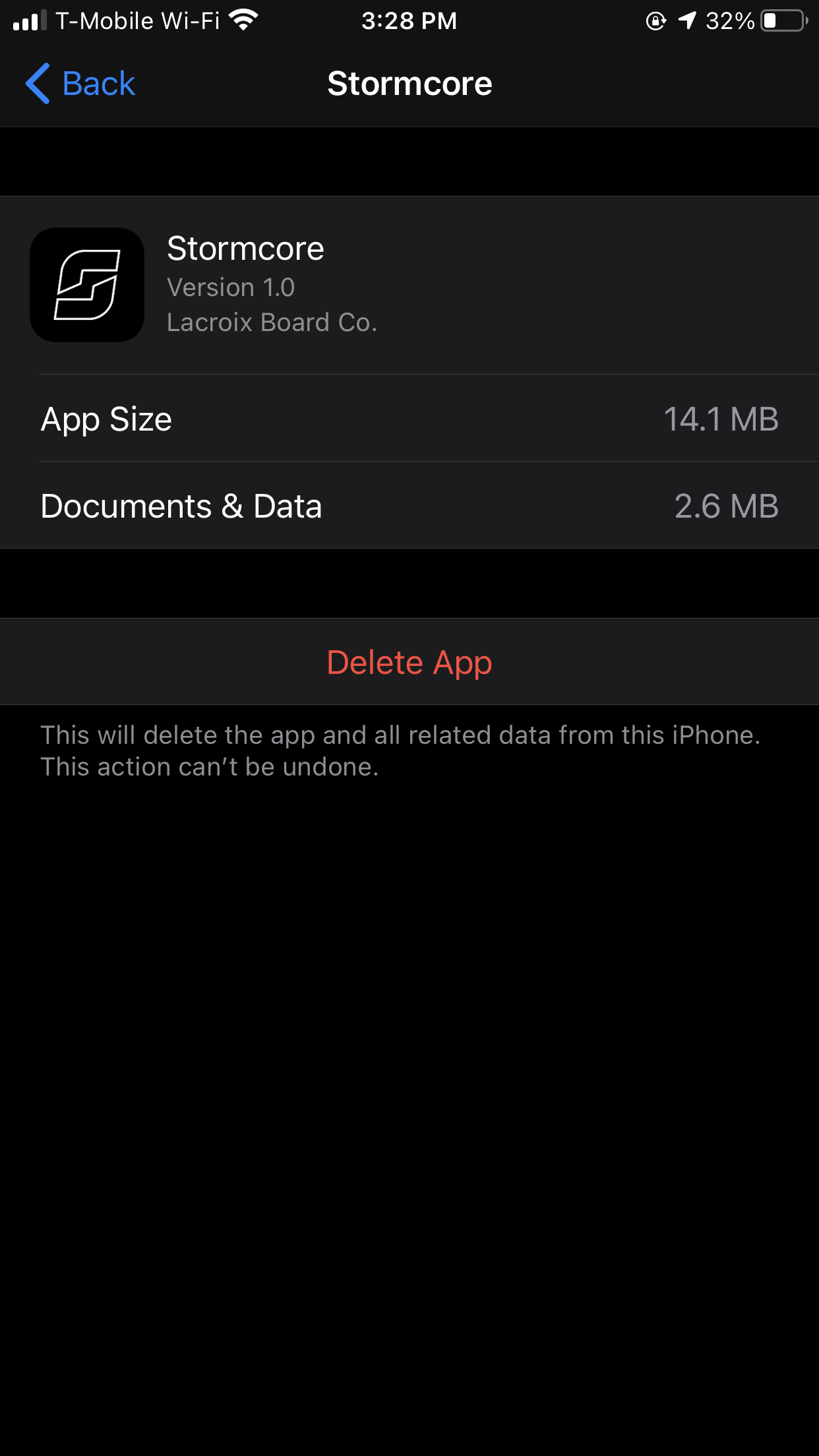

Can you elaborate on what you mean by “crash”? You say you quit the app manually so it didn’t really crash, just stopped recording? Also out of curiosity, can you post the space the app is taking up? Can be found in settings -> general -> iPhone storage -> Stormcore. I’d really appreciate if you post your observations in this thread. Thanks Stormcore for iOS App Bug Reports & Feedback (SERIOUS)

The app crashed crashed during a ride but the instance was still there when i double tapped my home button thats when i swiped up to quit it and then reopen it. I sent crash info when it happened through the app.
Thanks, that’s very helpful. I’ll look into this. This is an almost new install right?
Yes, Happened on the latest update. The previous version was working fine and didn’t crash on me not once.
Curious, your crash is happening due to a fix I did to try and correct somebody else’s crash that was happening in the same place. I’ll take a more in depth look at this later today, thanks
Edit: I think I figured out what’s going on. I’m mmap()ing too fast and for some reason mmap() ends up trying to allocate a ridiculous large memory size and the system is saying lol no. I’ll have a fix for this later tonight probs
