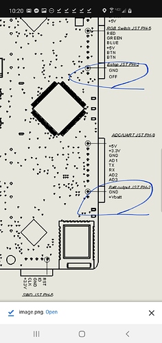

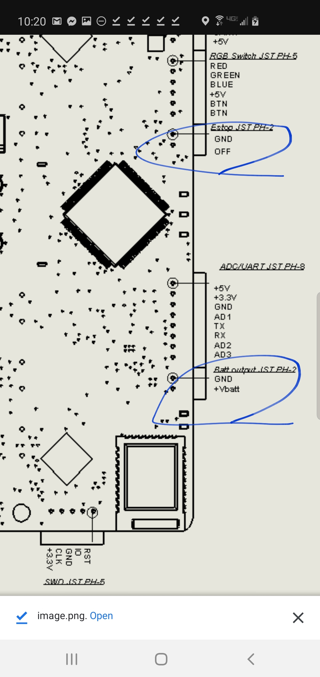

2 questions
How big is the fuse on the voltmeter aux out
And what is e brake
