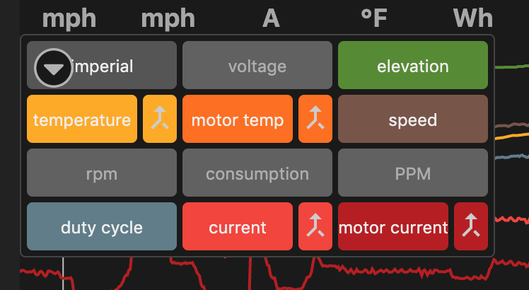

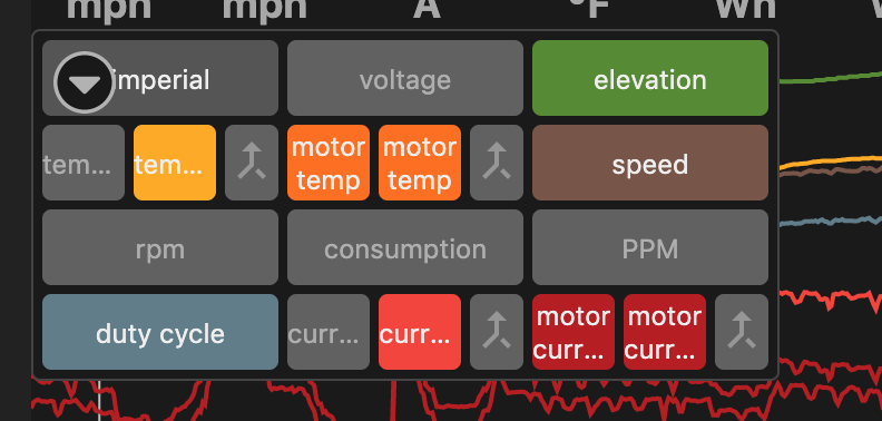

Was that log per side?
Nope. You can click on the combine button on the log to see per side.
logs combined
logs per side

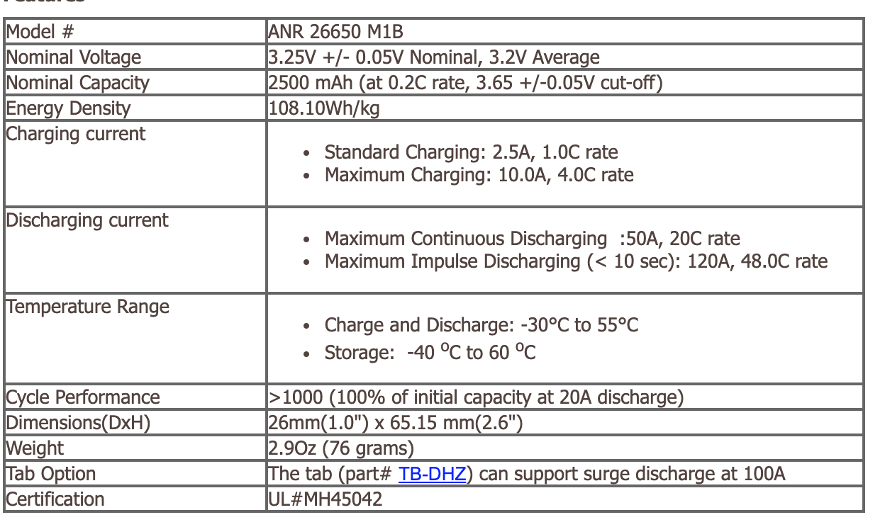

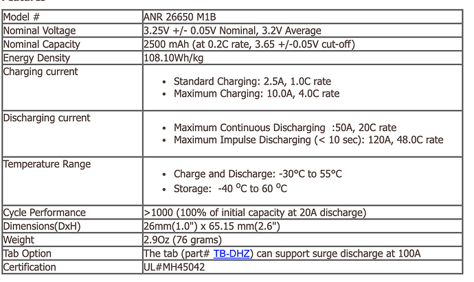

If I’m right a 20S6P A123 pack can deliver 180A continuous (or is that peak? IDK), so that’ll set me up for the same power output.
i’m fairly confident that before this time next year someone on this forum will be rocking a 6s74p battery, on a skateboard (driving your model s doesnt count)
This site shows A123 LiFePO4 max continuous discharge @ 50A, Burst @ 120A per cell
