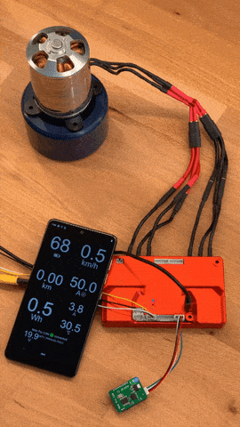

I remember someone asked on this forum if “dual parallel” also works on the Unity and @Deodand said that it should, but he didn’t tested it. I can confirm that it seems to work when compiling the right firmware and load it to the Unity.
PLEASE DON’T CONNECT THE PHASE WIRES WITH NORMAL UNITY FIRMWARE!!
First results looking good. I compared running a single motor with 50A phase current connected in “dual parallel” configuration to the same motor connected in standard single connection and logged the temperatures.
Here the result in dual parallel configuration:
Here the result in single configuration:
You can see that after 90 seconds the temperature of the single reached 46°C while the dual parallel only got to 35°C. (both started at 29°C with 50A continuous for 90 seconds)

No, it is not. You have to add “#define HW_DUAL_CONFIG_PARALLEL” in the config_general.h file and do some changes to the hw_unity.h. I think it isn’t meant for global testing right now because you have to compile the firmware yourself. Maybe it will be added to official VESC Tool at some point in time, but not sure because you can mess up hardware pretty easy when connecting something wrong.
