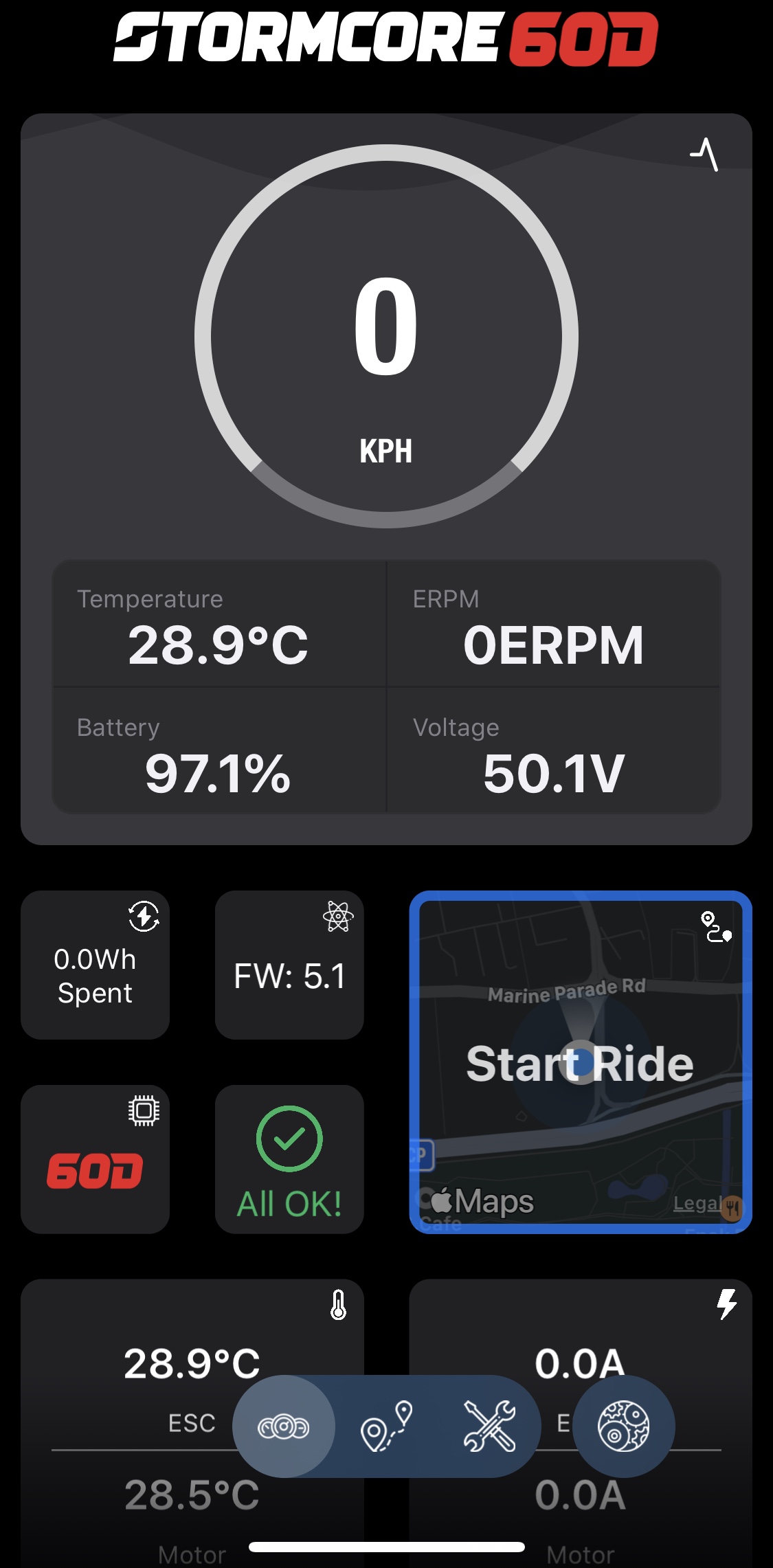

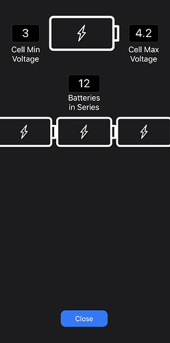

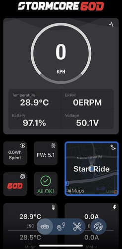

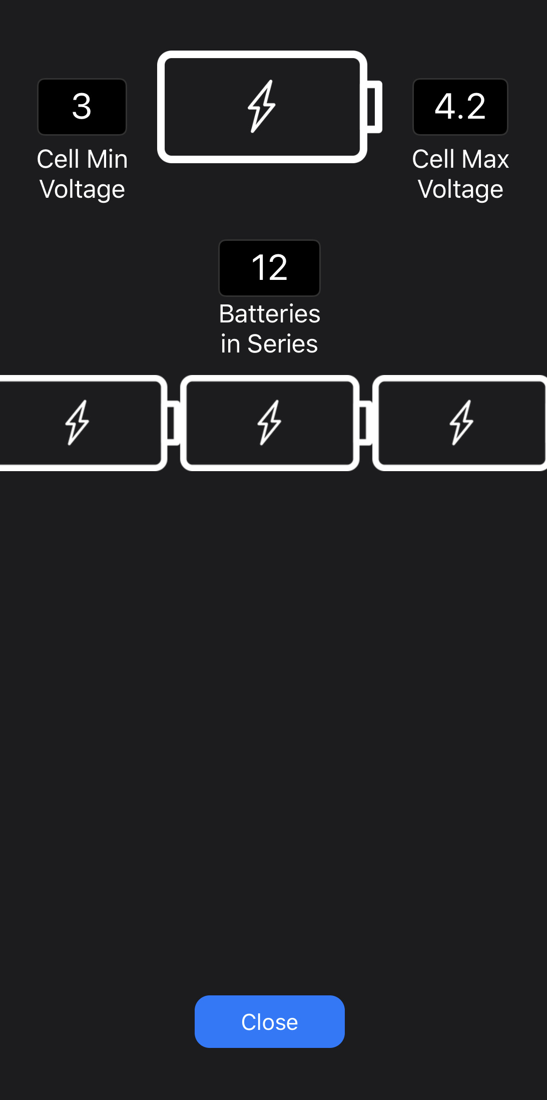

Can you show me what you’re seeing and show me your battery settings page?
Dual 60D HYPE
This was at full charge, as in the charger indicating charging has been completed, green light etc…
What’s your charger outputting? I’ve got three and none output 50.4.
Interesting yeah, i’d check your battery with a multimeter and see if it’s really at full charge…
Yeah will do so. I know it is not unusual for charging to cut off just before the max voltage. Just being abit OCD haha
Just tried charging again and its at 99% with 50.3V … lol

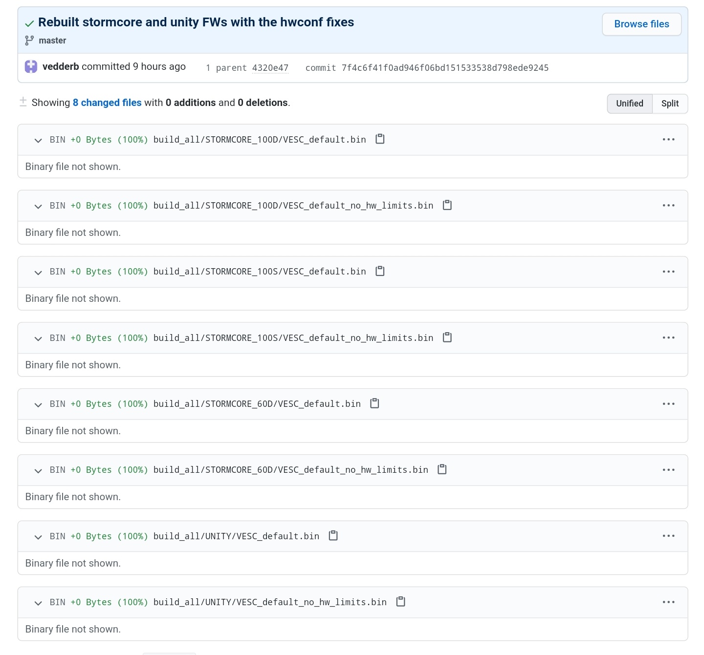

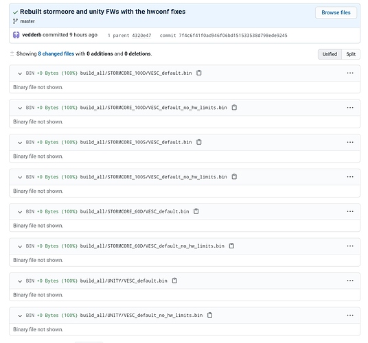

Does the latest already have the temperature caused turn-off fix?
If you dl the latest builds manually from github then it should.
Link: https://github.com/vedderb/bldc/tree/master/build_all
The vesc tool itself wasn’t updated
the units that are shipping out have the proper fw already in them
Can you post the proper FW revision you’re referring to? Mine arrived today and I want to double check.
