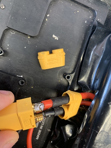

@rey8801 okay so I took the pack to a PC repair shop near me and had a guy attach the xt90 this was his work
I tugged on it and wiggled it around in the shop and it was holding well, still measuring 40 volts out of it.
Plugged it in and it wasn’t working so I tried what @Ericnfla suggested and measured the voltage while under load and it was dropping to like 7 volts when I was pressing the switch
ah ok so something happened inside the battery. I would say a broken weld or something. Can also be the bms but I am afraid you need to open it and inspect it. If you are not familiar with batteries pay a lot of attention on where you cut the heat shrink because if you cut through something is gonna be really bright in the room :sweat_smile:

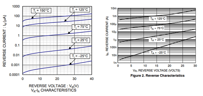

Hey guys, sorry haven’t been as present here lately. A lot of changes going on in my personal life and needed to step away for a bit to get back to myself. Anyways been better this week and getting back at it. Did a bunch of testing today regarding the shutdown at high temp and identified the issue.
There is a diode in series with the switch and when this diode heats up its the reverse leakage current increases and creates a false positive on the switch being pressed. So the esc sees the switch as being held in and shuts itself down. There is a pretty big variance in the units I have tested, some not seeing the button pressed at all some as low as 88C in the units I am testing.
During our beta testing it was fairly uncommon for our internal test units to get this warm (our motors tended to heat quicker) and the ones that did must have been lucky and had better performing diodes. In future orders we will be swapping diodes (old right, left new)
But for now simply disabling the power switch being pressed in firmware when over 65 degrees completely eliminates the issue. The only inconvenience being if you end a ride with the ESC quite hot you may need to simply let it shut itself down through timeout or wait a couple minutes for the switch to come down in temperature.
I’ll talk with Vedder about how to get this released in a timely fashion. We may simply send out a patched temporary firmware while we wait for the next firmware version to be ready for release.
