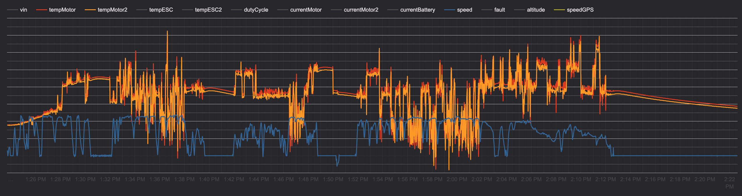

everyone says the sensors suck on lacroix motors and to depin them. but is it the unity?
this is some weird data.
note that both motors temperature noise goes the same directions at the same time.
there’s a couple idle times in there ( duty cycle 0 ) where the temperature reading suddenly drops after seemingly being artificially high.
fw 5.02
Unity.
Lacroix 6389 motors.
notes on avoiding faults:
I managed to not trigger faults while collecting this data by using freesk8 app to hack the motor temp cutoff end to 200c
others depin
others change the thermisitor beta value so the readings are artificallly low and never fault.
rusins

Someone send this man a stormcore to definitively answer the question! The fact that the noise seems to be the same on both motors is a great observation. Could be that the motor current, which is the same, is affecting things, or it could actually be the ESC…

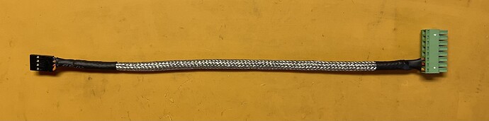

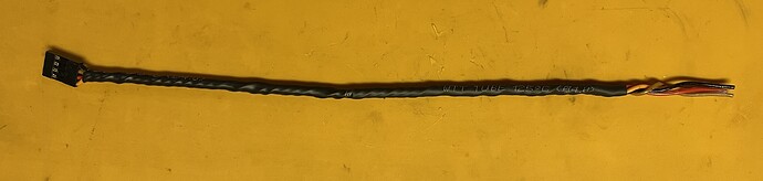

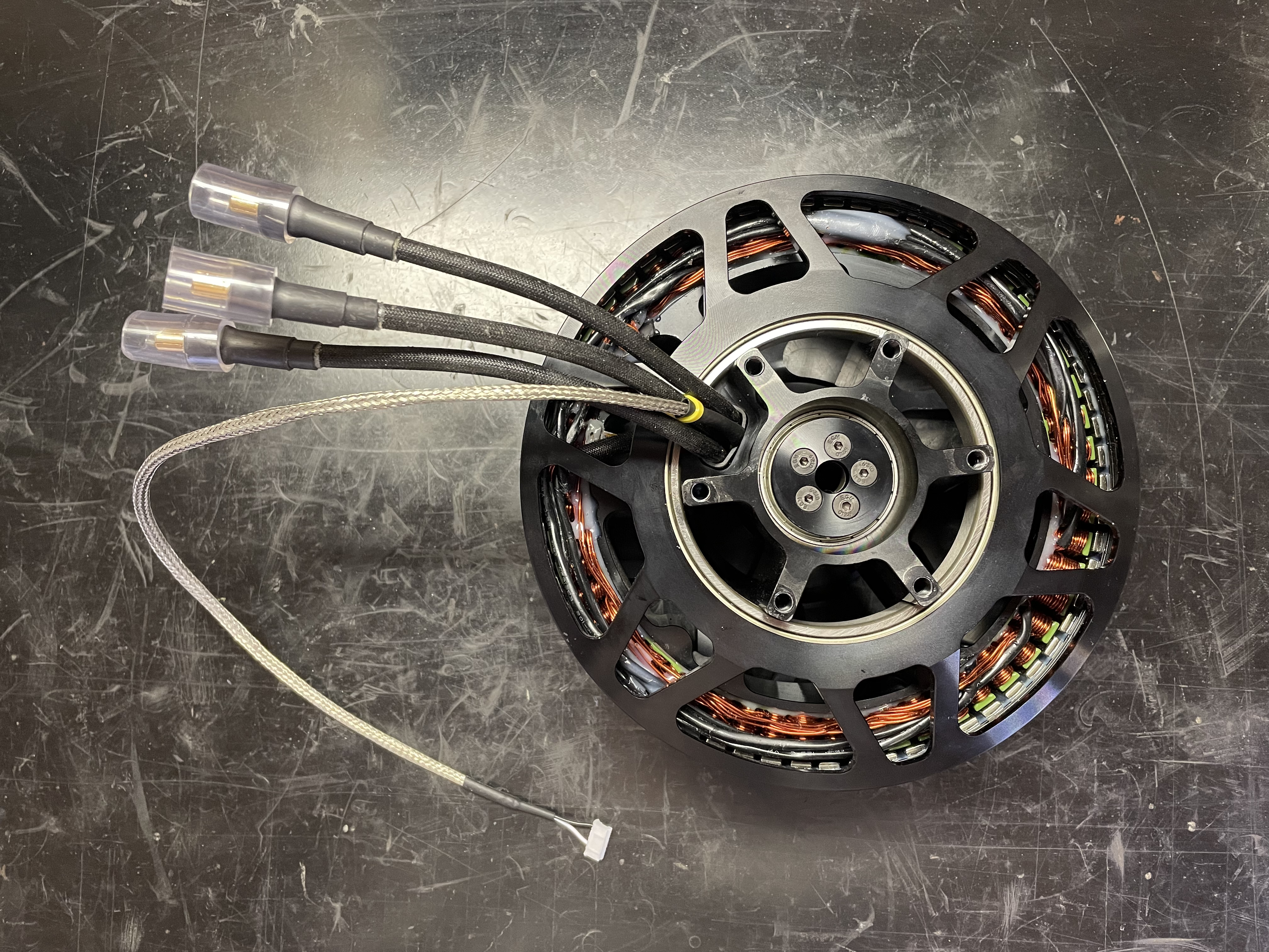

I had the same problem. Solution was to use braided cable shielding on temp sensor cable.
linsus:
Thats a problem
not following … ?
ooh … do you have pictures? I was hoping to try this never got around to it .
Oliver
September 16, 2021, 5:23am
8
Some examples on different applications:
Twisting cables and keeping them as far away as possible from phasewires helps too.

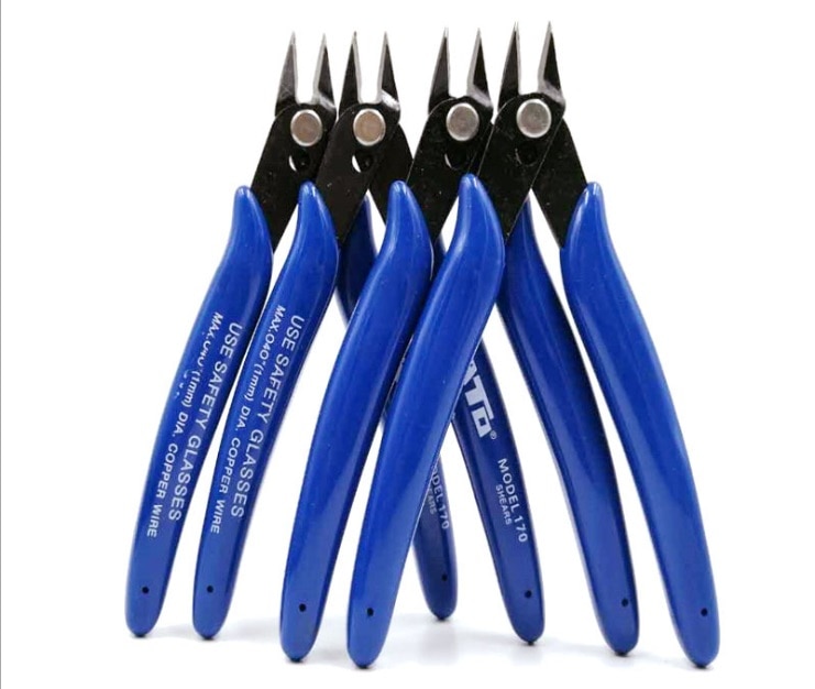

I have a special tool that’s fixes this issue that I got on AliExpress
b264
September 17, 2021, 2:50am
13
Do you have a link or a name for this tool?
b264
September 17, 2021, 3:10am
15
Oh LOL I thought you were referring to some sort of electrical tool to test the beta value
