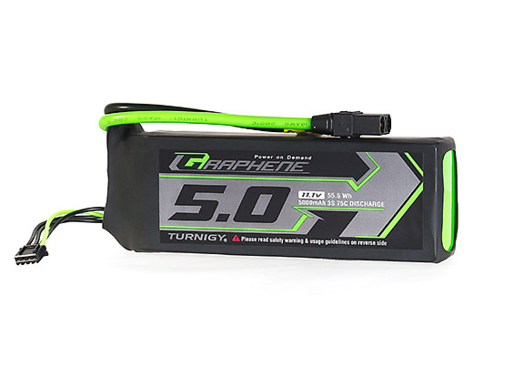

I got a pair of 2.2Ahr 3s Turnigy Graphene Lipo batteries and tried them with my welder. I was utterly amazed. After blowing holes through some test strips, I got the weld time dialed in. For thinner nickel strips like .2mm, I bet a single one of these packs would work.
https://endless-sphere.com/forums/viewtopic.php?t=89039&start=225#p1336713
I tried using a 6" length of 12ga solid copper wire with small sensing wires soldered at the ends. According to the chart, this should be about 0.8 mOhms. Based on this, I was seeing about 1.8kA during the pulse. I suspect the added resistance of the copper wire was reducing the current quite a bit as the cables weren’t jumping as much as normal. So the tiny little graphene batteries seem to be doing around 2kA.
Edit: I also measured the battery voltage during the pulse. It went from about 12v to about 6v. This gives about 6 mOhms internal resistance for each pack (I have 2 in parallel). If you stacked a bunch of those things in parallel, you could get some serious amps.

The website says the pack resistance of the 4S 1600mAh pack is 14mOhms, you’d at least need two in parallel and maybe even three to get a decent amount of current (please do the math excercise above to check).
This is the 4AH model at 10 milliOhms, two of them in parallel sounds good. A 5AH/3S battery usually lasts for 200 to 1000 welds depending on joule setting (discharging only by 2/3, I’d recommend to not go below 3V per cell).

Comparing the Green Turnigy Graphene Lipos applying the maths above to give people a starting point for useing them as the power source of a Kweld
6Ah 7mOhm Resistance
5Ah 9mOhm Resistance
4Ah 10mOhm Resistance
3Ah 13mOhm Resistances
2.2Ah 10mOhm Resistance (this look to low to me)
1.4Ah 13mOhm Resistance (this look to low to me)
KWeld Resitance 42mOhm or 0.0042ohm
To push the minimum of 800a
0.0042ohm*800A=3.36V
3s is 11.1-3.36=7.74
7.74V/800A=0.009675=9.7mOhm
so in Theory a 3S battery up to 9.7mOhm is bare minimum the closest is the Green 4Ah Turnigy Graphene at 10mOhm as the BARE MINIMUM.
Ideally it wants to push 1500A
0.0042ohm*1500A=6.3V
3s is 11.1V-6.3V=4.8V
4.8V/1500A=0.0032ohm (3.2mOhm)
Triple Turnigy 5ah in Parallel
(1/9)+(1/9)+(1/9)=0.333
1/0.333=3mOhm
Triple Turnigy 4Ah in Parallel
(1/10)+(1/10)+(1/10)=0.3
1/0.3=3.3mOhm
Dule Turnigy 6ah in Parallel
(1/7)+(1/7)=0.286
1/0.286=3.5mOhm
As the maths show in terms of Green Turnigy Graphene 4ah is the bare minimum 12Ah is preferred
What I can confirm in parties is single 3s6ah dose 1200-1400amps and dule 3s6Ah (3s12Ah) dose 1600-1800Amps
Hope fully you can follow this and it adds some evidence to why x or y is the one that should work for people to make up there own minds.
