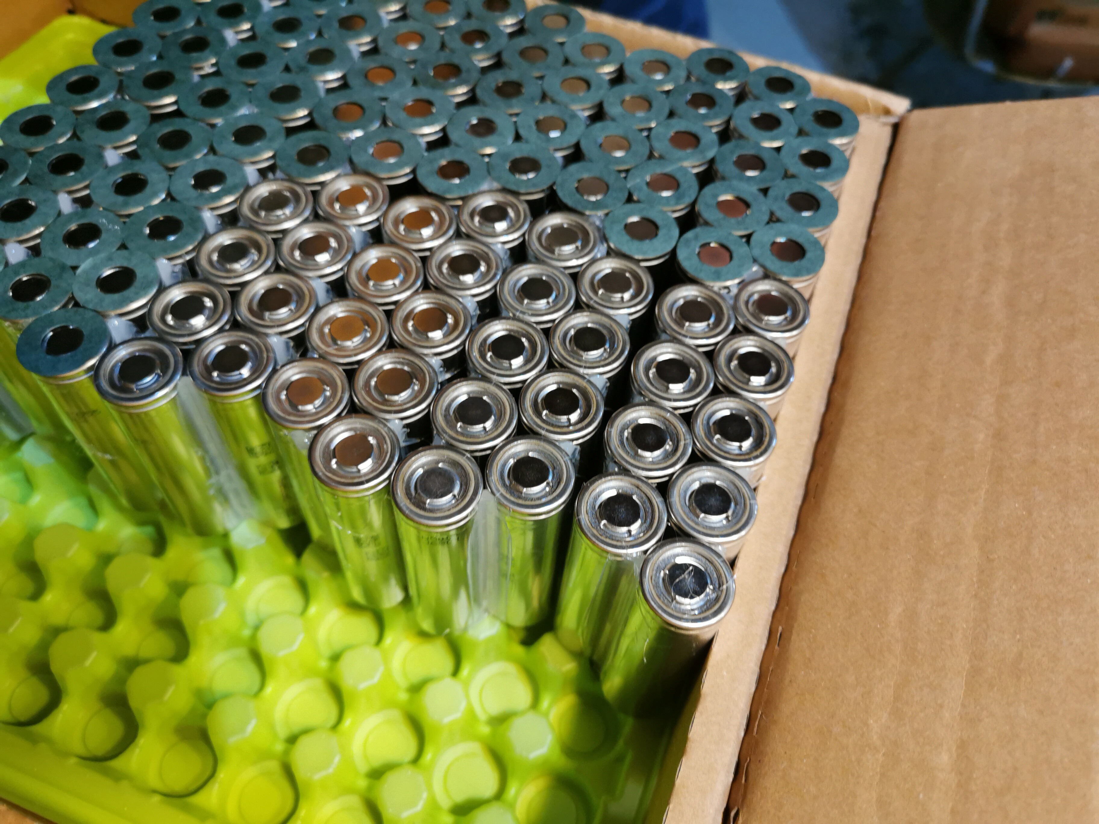

These clear wrapped cells look really cool!
eeek. at first i thought they were all bare. is that a new cell or you rewrapped?
New 50E cells from nkon, idk why they are clear tho
