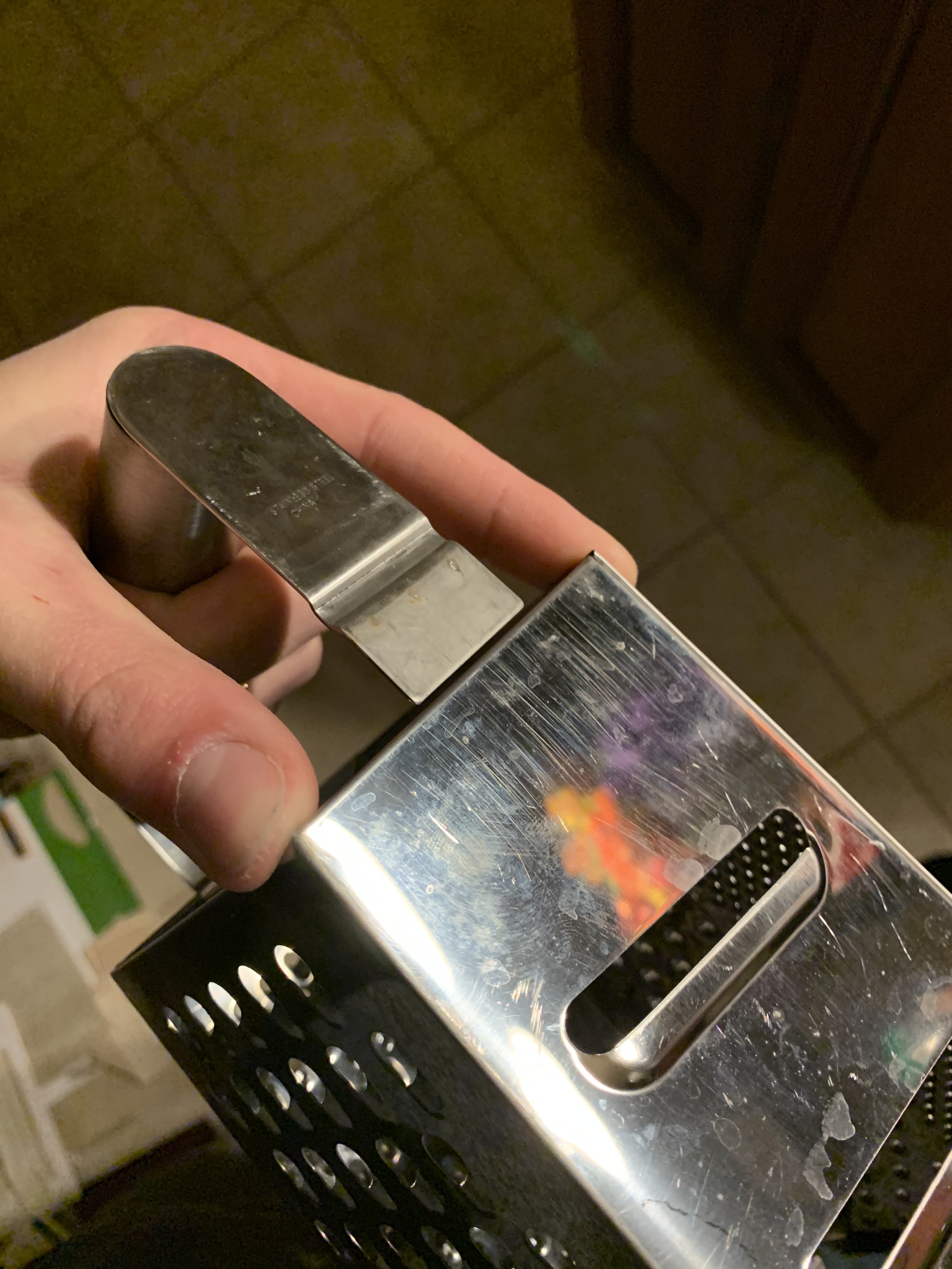

Kinda stupid question but my mom has this stainless steel grater that broke and I was wondering if the kweld would be able to re-spotweld it?
Probably way too thick and would spark a lot
