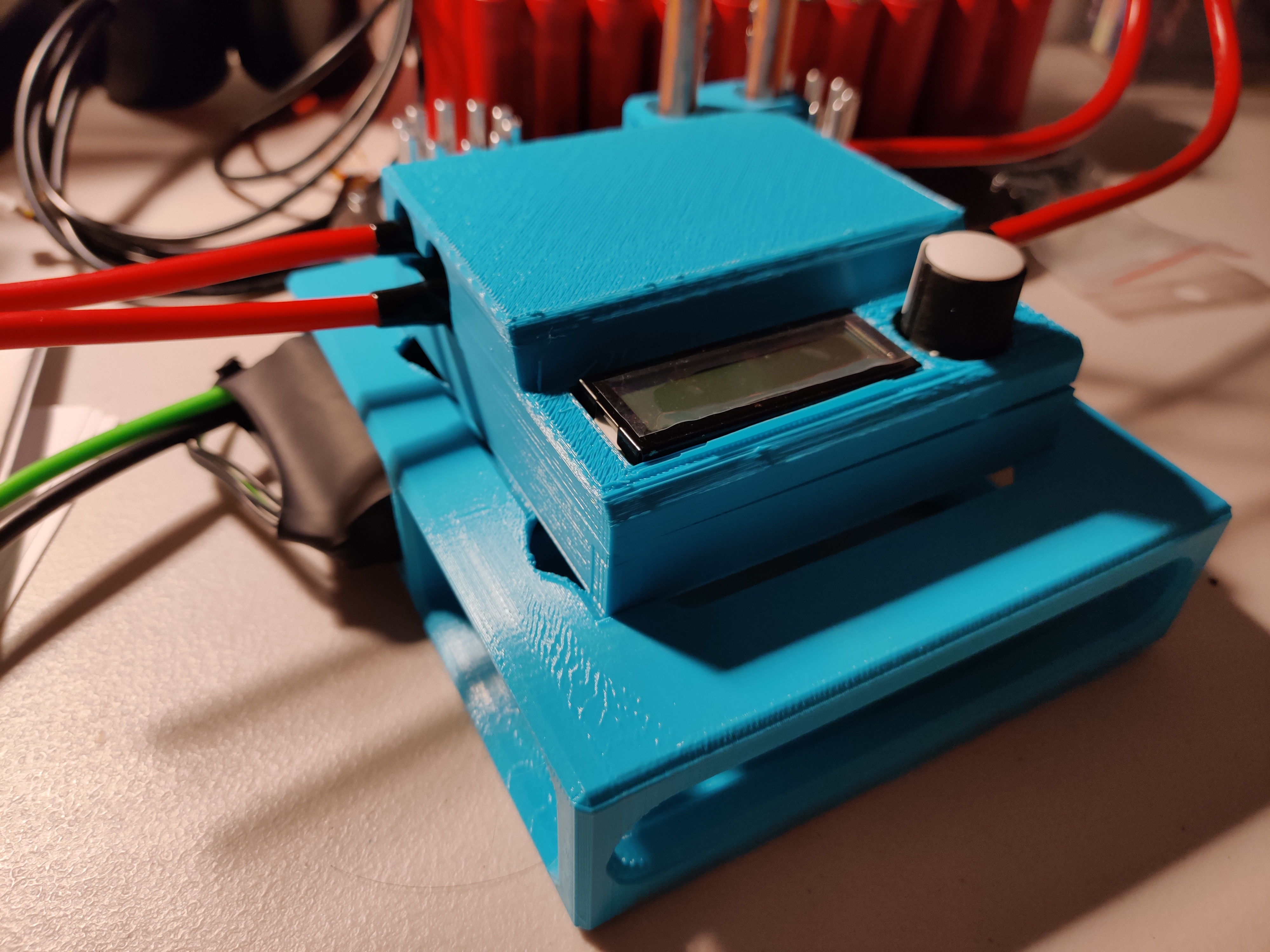

Alright, @BillGordon and i are gonna share a welder and finally start building our first battery packs.
From what i’ve read from the thread, dual lipos seem to be the better option for powering the welder.
So besides from the welder, and lipos, what else should we get? And if any recommendations on sites to get them from, that’ll be great.
How thick strips are you welding with? Single lipo has been good to me with 0.15 strips. Capacity is a bit lacking, had to charge it up again to finish a 10s5p pack to the end, but hey, I don’t mind taking a 1h break.
Probably gonna be 0.2mm nickel
2nd lipo is probably worth it then, considering you’re splitting the price. (Just for capacity reasons alone)
Anyone know where I can get one of these? Budget is 2k
@Chibatterysystems has one similar, so he might be able to help.
1 good lipo is enough Linny. 2 can be better but the welds are just as good. Get extra tips.
You want an enclosure. Print it using the stl they provide, or buy the laser cut plexiglass enclosure from them. Don’t run it open, that’s asking for fireworks.
Also need a balance charger for the lipo.
Ok, I’ll probably grab the lipo and balance charger from Hobbyking, any type to go for? 2s? 3s?
Also, yea I printed it before I went to bed last night after making the welder order
Graphene 3s 75c 6000mah
Those green ones.
I bought these, since a few kwelders seem to like them, but that one @370HSSV has seems pretty good too
One of those panther is enough. But if you want to last longer, get another 3s and connect in parallel.
I crashed the laser cut case they optioned out when I am trying to assemble them lmao.
