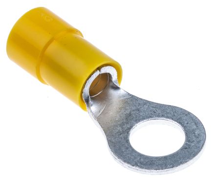

@Acido you get less heat with the yellow ring terminals compared to xt150? I use those terminals in builds (usually the fuse on the discharge line) but always wondered how much current they can handle. Is it a lot better?
Depends on what size you use, my kcaps are connected to the welder with them and they stay almost cool
the xt150 would get much hotter compared
But if you dont get slowed down because of it no need to touch a thing that works :smiley:

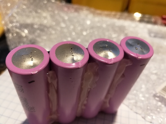

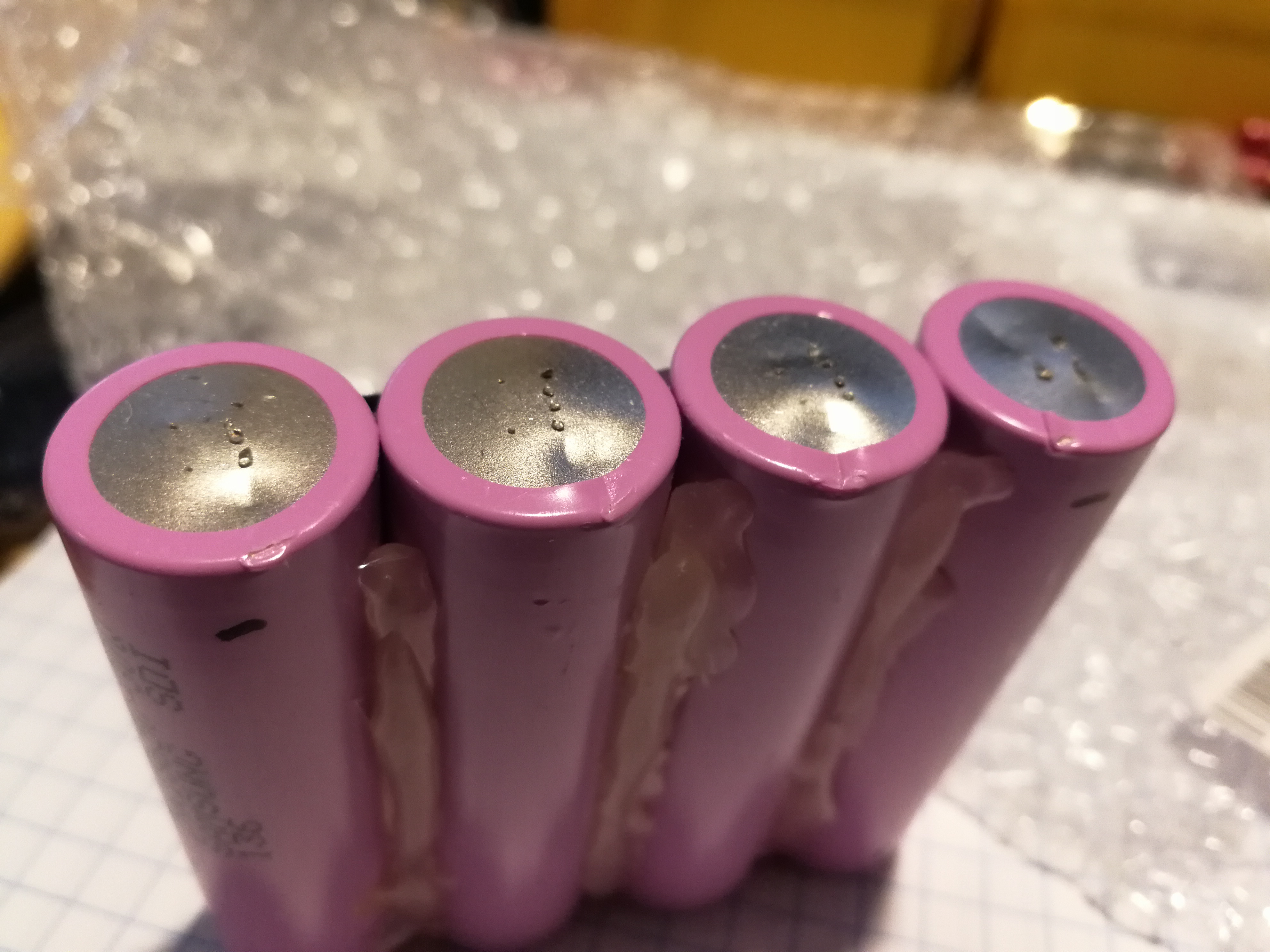

Here’s a p-group that a bms killed.
I try to use a fairly light touch. Maybe that’s the difference? Do you push down hard as hell? Either way, 2x joules difference is a lot! Official chart says 50j, but IIRC most people were using less.

Thanks for confirming the ring terminal stuff. I’ll feel better about using it in my boards more. I’m always annoyed at how the wiring takes over all the space, and 3 way splices…
