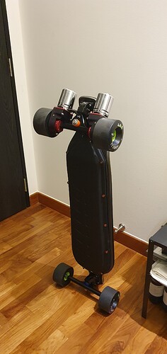

Okay! Beauty shots time!

Oh, here’s a pic of the internals before I added the window seal gasket around and sealed it up

Finally got a good ride in. I think the Spiral Bevel drivetrain is one of the smoothest drivetrains I’ve ever ridden. Fairly close to @avX herringbone gear drive. It’s so quiet and smooth, I love it. However because of its 20 : 40 gear ratio its not the most efficient of all my builds. I did a 15km ride and it drained 35%.
