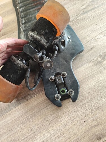

Kingpin broke suddenly while riding, change your pins every 1000klm.
1500klm on this board.
The Chinese trucks use a splined kingpin and a quick google search shows many examples of them breaking at the end of the spline.
It sent me flying through the air on an empty road, if it happened near cars you could honestly die without having time to know about it.
You cannot visually inspect the bolt so I recommend replacement every 1000klm or replacement with a non splined kingpin.
Save your skin, maybe your life if you commute around traffic

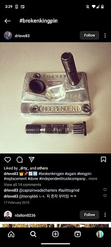

You can see every one of those pics the kingpin broke in the exact same place, at the end of the splines.
Therefore any truck using a splined kingpin can fail regardless of how much you paid for it or how much you weigh.
I found these 2 pics on Google image

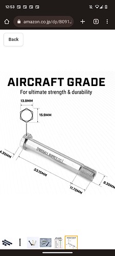

Is swapping the stock kingpin out with something else viable? High tensile bolt instead of the stock?

I’m trying to find pins that are the correct length but everything I see is too long.
The closest is this one from fireball supply but it is 4mm longer than stock. I’m considering installing a washer on it before pressing it in to the base plate to make it shorter.
