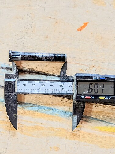

Do you have any that would work as replacement KP’s on these stock death pins if we wanted to replace them?
60mm long
46mm shank
14mm thread

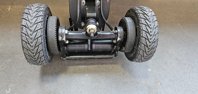

This happened yesterday. A Flipsky truck. I use these on rental board, and I simply can not have this kind of failure. Luckily it was me on the board and it was a slow snap where the truck all of a sudden got real loose and I could stop with nothing happening.

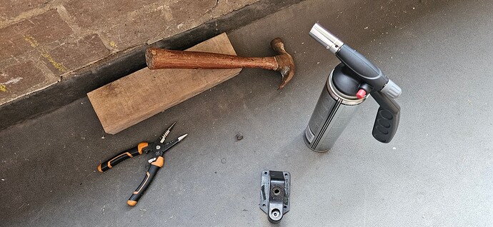

Problem is that it seems that the kingpins are not that easy to get out of the baseplate for replacement.
If I find a way I will change kp all all 16 boards.
Get the baseplate off and heat it with a blowtorch. That will loosen up the tolerance while the metal is hot. Then it will be easier to hammer it out.
edit: make sure to get the pivot cup out before you apply any heat!

I think what we are missing is, that DKP trucks have a longer lever arm and more violent twisting.
I have even read that mall grabbing causes the KP to break. That seems a little paranoid. The TI ones are only 17 per pair. Seems pretty cheap.
Found this spare bolt in my collection. It’s a grade 8 bolt. Picked up a blow torch. Now to get shot of this crappy fail bolt.
Grade 8 bolt is way better than what was there.
The blow torch got the bolt out in no time. The spline kingpin had broken in the same place as the other photos.
Had to file down the sides of the bolt so it could sit flush to the base plate. Got a tight fit. This bolt ain’t going anywhere.
Up and running again. Feels goooooood.
